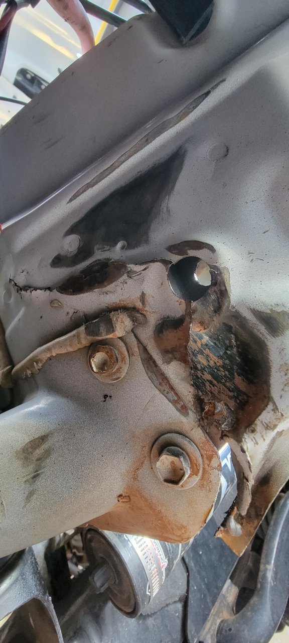

    So what are you guys doing for the radiator support pretty much falling apart on the 3rd gen? Mine is strait up fucked and the fender isn't even close to aligned anymore
    ovrlndkull likes this.

    Waiting on the JD inner fenders then will build something off that. Others are patching and welding the cracking. Most of it all is one off stuff.
    whatstcp likes this.

    Patiently waiting for JD to drop their inner fenders. Probably will replace the core support. I’m going back to oem body and radiator support mounts. Moving as much weight off the core support and inner fenders as possible. Work on stiffening up frame twist which I think contributes a lot it. I’m on a 2nd gen though. @Airdog ripped his out and placed with tube.
    Airdog and ovrlndkull like this.

    Yes the weight and frame twist are 2 big contributors. My battery is moving to the rear and every non essential thing is coming off the front. The other part is tackling the frame twist.

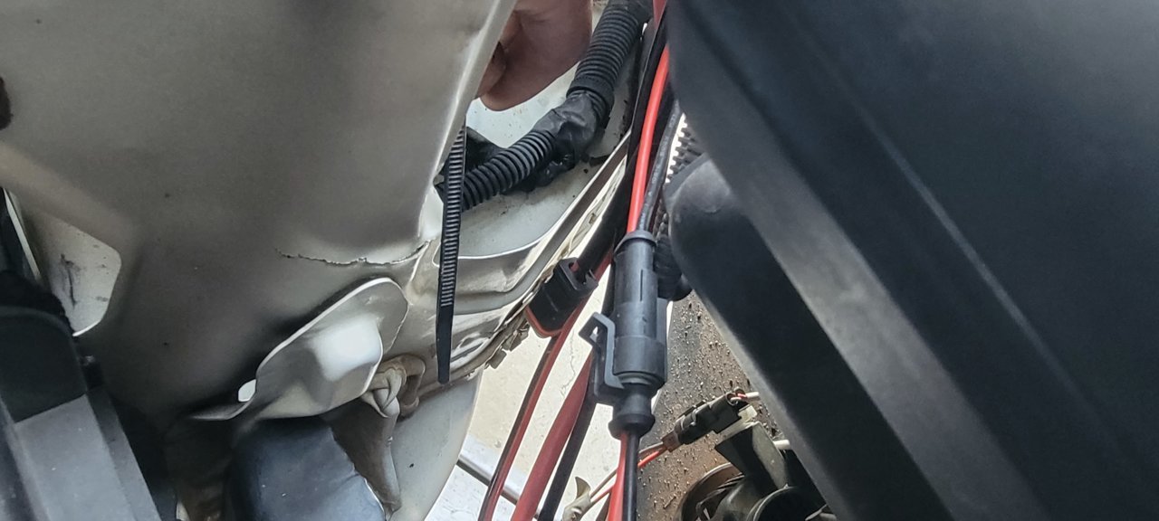

    Would running the poly bushing on the radiator support and the front cab mount accelerate the cracking as it forces the body to flex with the frame? I tried to take some pics but its hard to get a angle that shows anything 20210508_171514.jpg 20210508_171329.jpg

    Potentially but........I've seen the same damage on trucks with stock bushings. I think the biggest contributor is how hard you push it.
    Slashaar and Mully like this.

    Way to hard for not being long travel. Lol
    Airdog and ovrlndkull[QUOTED] like this.
