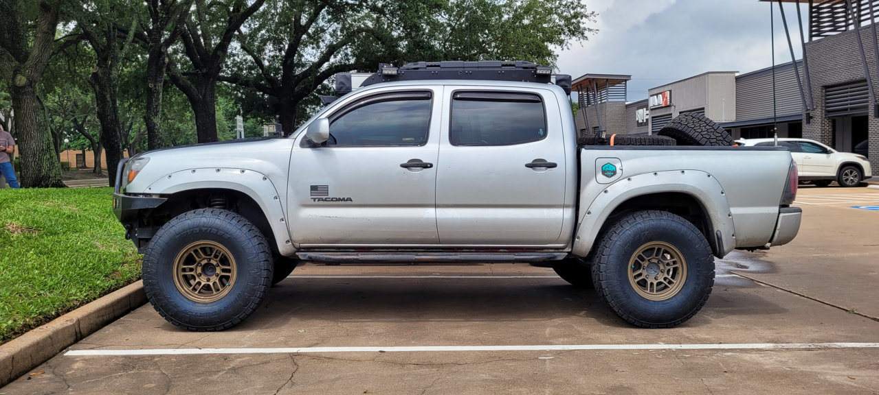

    I've been following this thread for 3 years and finally have gotten to a point where I can fit some 35. I have superbumps all around and am more setup for droop in the rear (eyelet converted bilstein 15" collapsed/27" extended).
    No rub at full lock and I can still turn aggressively. May need to trim some more in the rear but overall the new setup feels great.

    Coastal front bumper?

    Yes sir.. welded it up last summer. Added some tweaks of my own as well. Planning on doing the HC rear soon as well.
