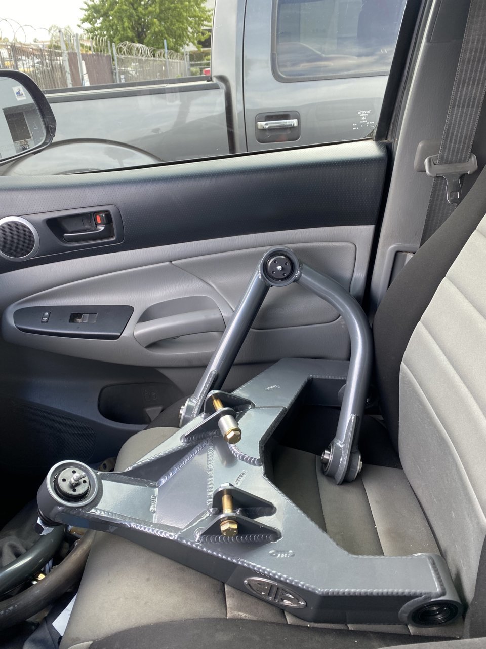

  6. May 20, 2021 at 4:06 PM
    #5626
    Airdog
    Airdog did your Mom
    Dec 26, 2012
    #93790
    4,892
    Tom
    SoCal
    https://www.tacomaworld.com/threads/airdogs-2012-prerunner-access-cab-slow-build.264263/
    These installed right??
    Slashaar, freddy2923, Torspd and 3 others like this.

  8. May 20, 2021 at 4:19 PM
    #5628
    Evenflow
    Evenflow Well-Known Member
    Jul 15, 2013
    #108344
    5,766
    Jason
    San Diego, CA
    06' DCSB 4x4
    Yes
    pretty sure the UCA bolts to the LCA where those grade 8 bolts are

    You can still use your UCA. What they were saying, is by doing so you’re sacrificing the tire clearance benefits off the firewall. So if your goal is to stay off the firewall with bigger tires, you would want to get the JD upper arm that doesn’t have so much caster built into them. You use the LCA pockets to gain caster instead.
    Your UCAs will work, just won’t let you to best utilize the lca kit to work to its FULL potential.
