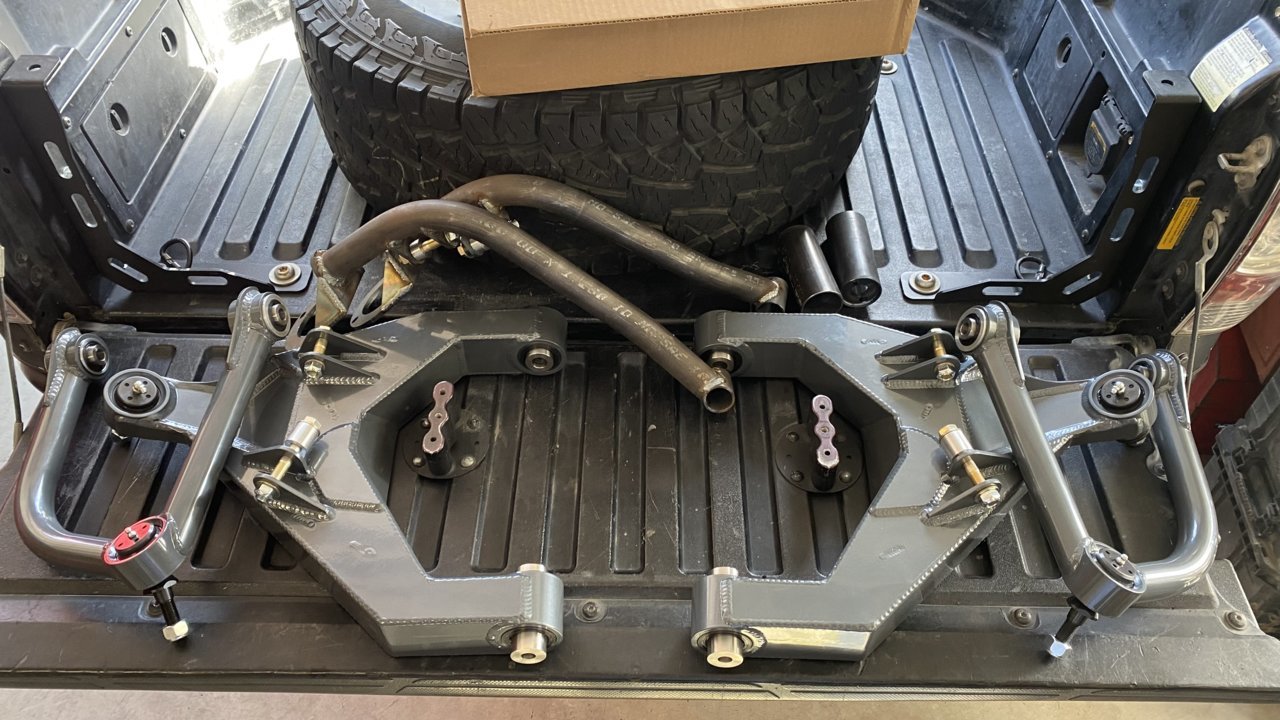

    I got my stock length TC LCA’s for 700 bucks which led me to this
    Then I put on the DMZ SUA which then led me to this
    Thankfully my front kit I’m taking off is sold and is covering about half the cost of this +4 kit and the 4 shocks going with it.
