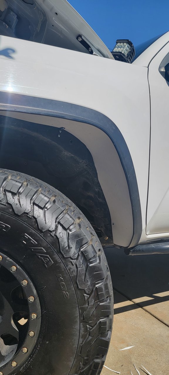

    Made some fender liners out of a 4x8 sheet of FRP. Seam seal and undercoat and looks pretty decent from 5ft. Since JD doesn't make 3rd gen inner fenders yet. Lol20210521_155326.jpg 20210521_155333.jpg 20210522_133513.jpg 20210522_133438.jpg

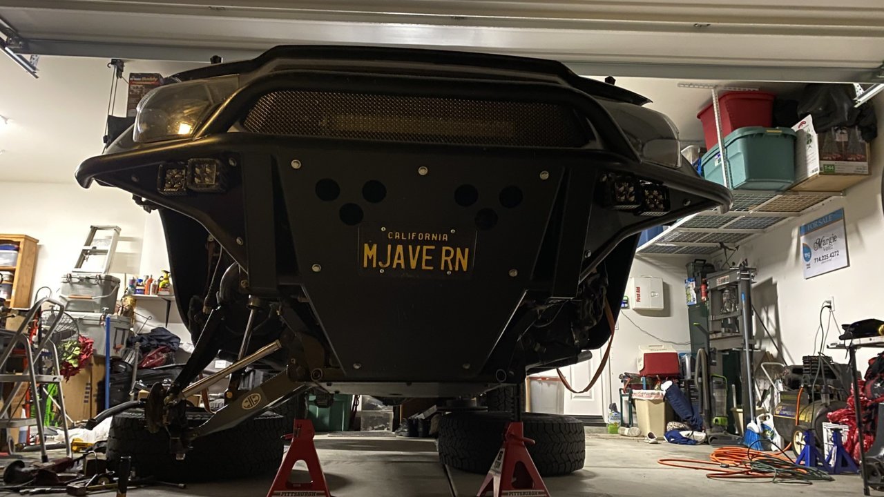

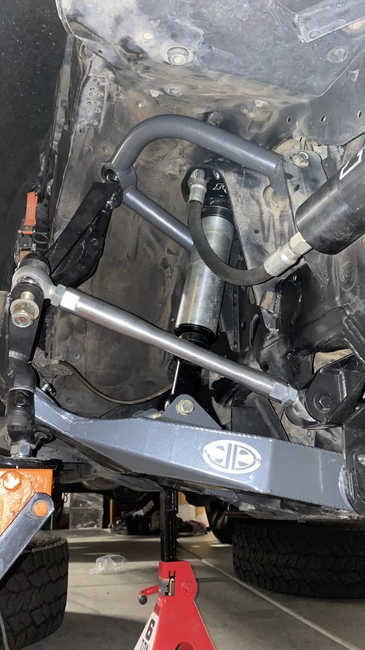

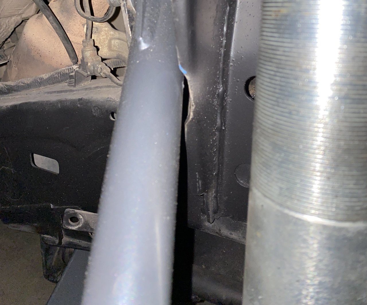

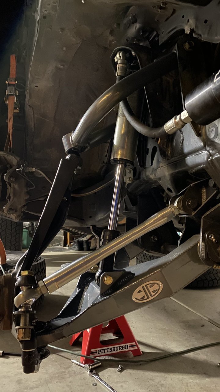

    This is a far as I got today. Ran into some issues that needed attention right away. Thankfully I have a friends lathe in my garage and was able to make quick work of it. Found some other issues during cycling that needed to be addressed and took care of those too. Some of these issues may be specific to my truck. But who knows. Harry told me that I didnt need the spacers on the lower spindle mount....turns out I needed to put 1 spacer (washer) in there because the uniball cup was hitting the bottom of the spindle about an inch before full stuff. One other issue I ran into is the UCA was hitting my coil over bucket preventing it from getting to full droop....nothing a flap wheel couldn't take care of (pic below) Just trying to get this thing to be a roller since my welder buddy was busy this weekend. Next weekend should be able to weld in the bump cans and limit straps. Most of these issues may be specific to my truck. Its been beat on pretty hard in the last 8 years. But its a good reminder to all that you need to have the ability to adapt and make things work for your specific setup...there are always issues that pop that fabricators can't forsee.

    Maybe read the instructions first next time and you would know about needing to trim the coil bucket:)

    I didn't get any instructions....and if I did I still probably would have not read them. Are they on the website?

    I didn’t know there was instructions either. Lol. I also found out during cycling things to trim.

    The details about the coil bucket are in fact in instructions but it would probably help to have a copy on hand. Lol
    I also had to run the spacers at the bottom even though I’m not running the 934s because the zerk fitting and CV had no clearance.
    Curious to know what you had to machine down though?

    Just some of the spacers in the arms. Fit was really tight so I did some massaging of the spacers to my liking. Others may not be so picky.
    Anyone want to email the instructions?
