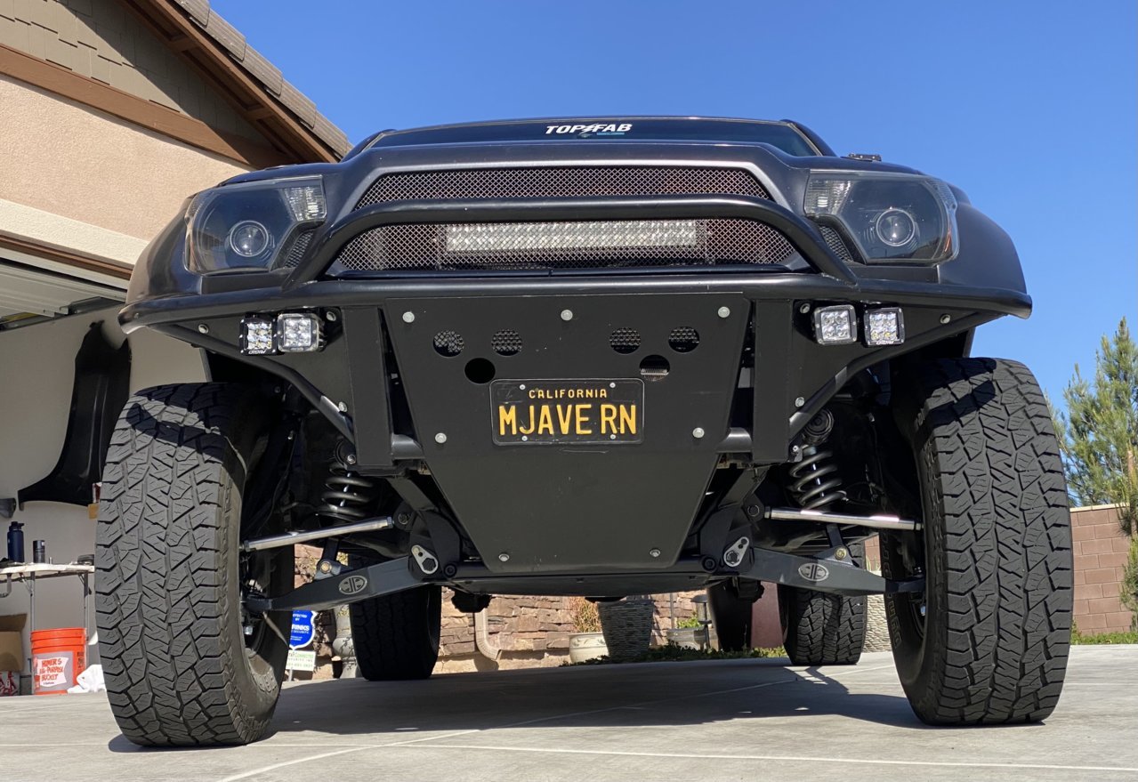

    A3AAF10A-6ADB-47D6-B021-C6093B54BC4C.jpg Got me a roller. And it even drives straight.
