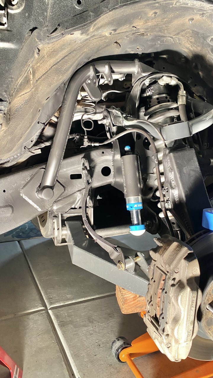

    Hoops, bumps and limit straps in.
    Beat the living shit out of the front side of fender wells to clearance. They were already in bad shape so what’s a little more wrinkles gonna do. Ran out of time so I did what needed to be done to get out and give it a workout tomorrow. No pics….it’s not pretty.
    Don’t judge my paint job either. :D

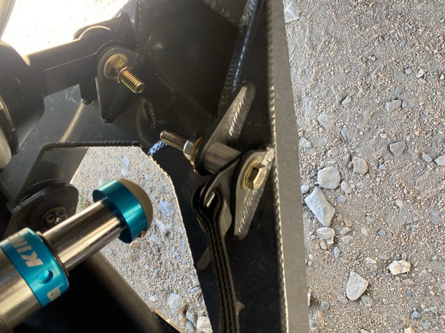

    Bump stop tabs are on the wrong sides

    Well shit. They fit pretty good this way. Not that this is right obviously, but we were able to pick up the coil bucket gusset with the longer one in the rear…. That was our thinking putting it on that way.

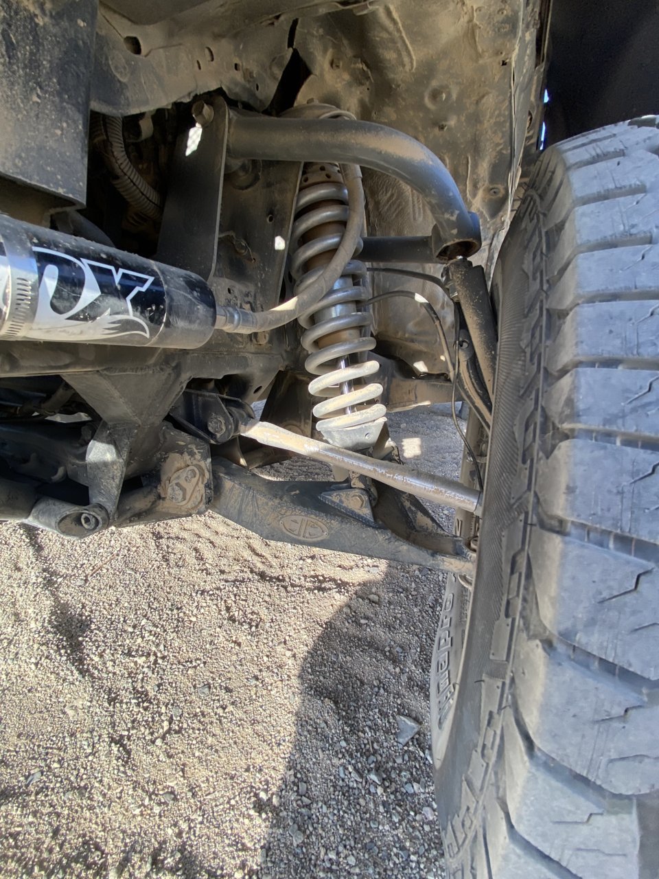

    Started to climb elevation yesterday and started to hear a rotary clunking when the truck is under load. Pretty sure I’ve isolated the source to the front left tire. Thinking the CV isn’t very happy so we decided to not try and continue the climb.

    Also when you’re not running a bypass shock bolt the limit strap to a single tab or run the spacer provided in between the tabs. The way you have it will bend the tabs and make getting the bypass in there a nightmare

    Good timing. We were about a mile from airing down. Thxs!!

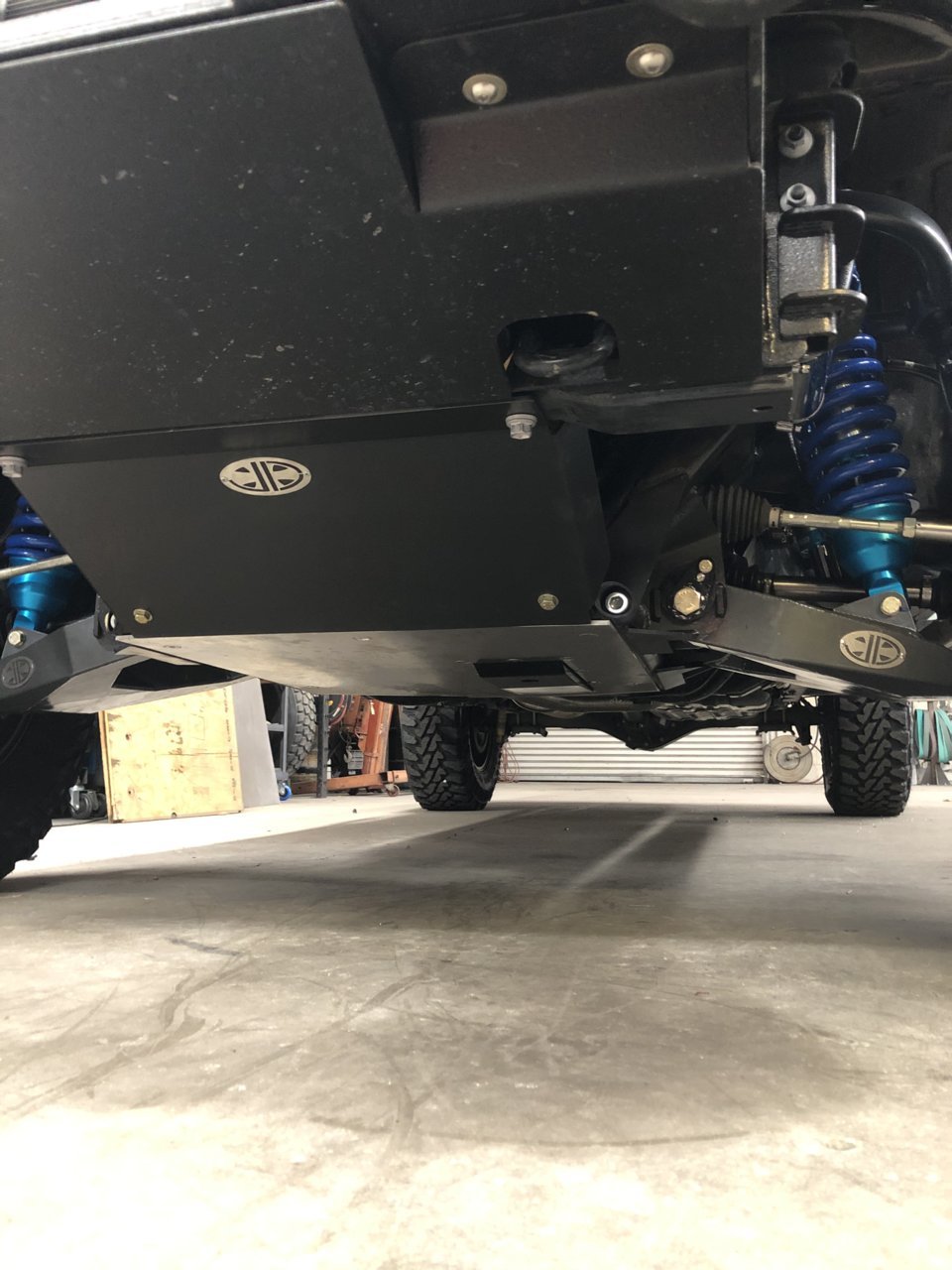

    Do you have any pictures of the front skid plate that attaches to the pivot? Kinda hard to tell where it ends or mounts exactly up against the aftermarket bumper in the pictures on the site. I remember an older picture with a stock bumper not sure if thats the same skid though

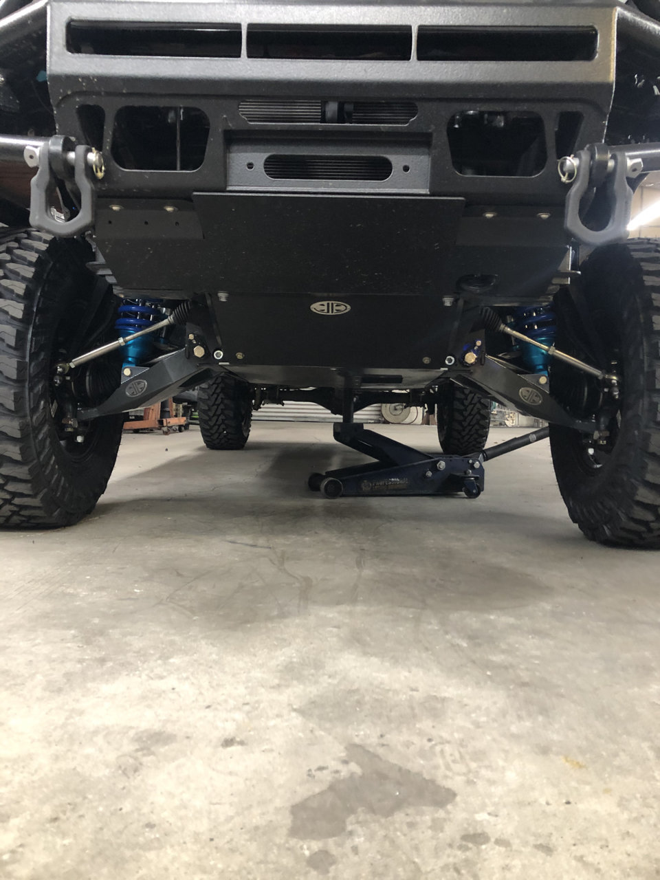

    What tire and wheel are you running? Seems about as tucked and close to the spindle gusset as you can go, which I like

    They are just a 4.5 backspace wheel and Hankook 315/75-16 tire
