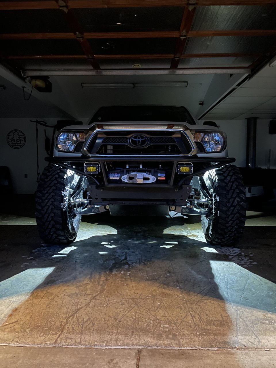

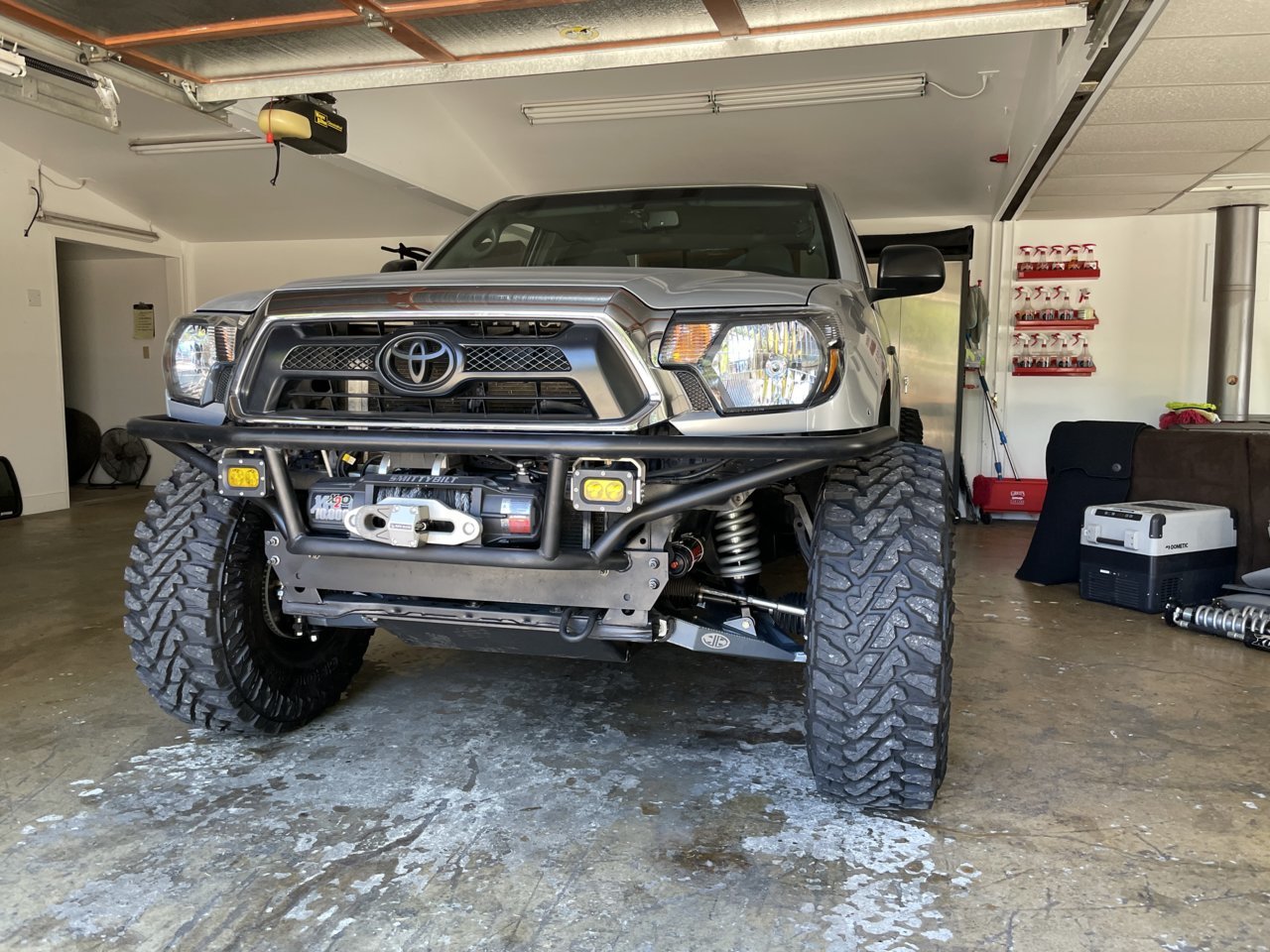

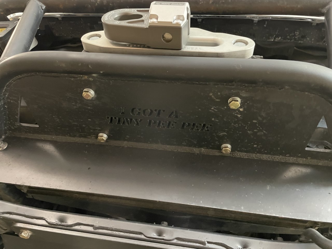

    That bumper looks great, too. Any details on how it was built? I mean I can see most of it, mostly curious how the winch ties in

    Heres winch plate LOL, my buddy snook a fast one on me with the plasma table when I wasn't paying attention..
