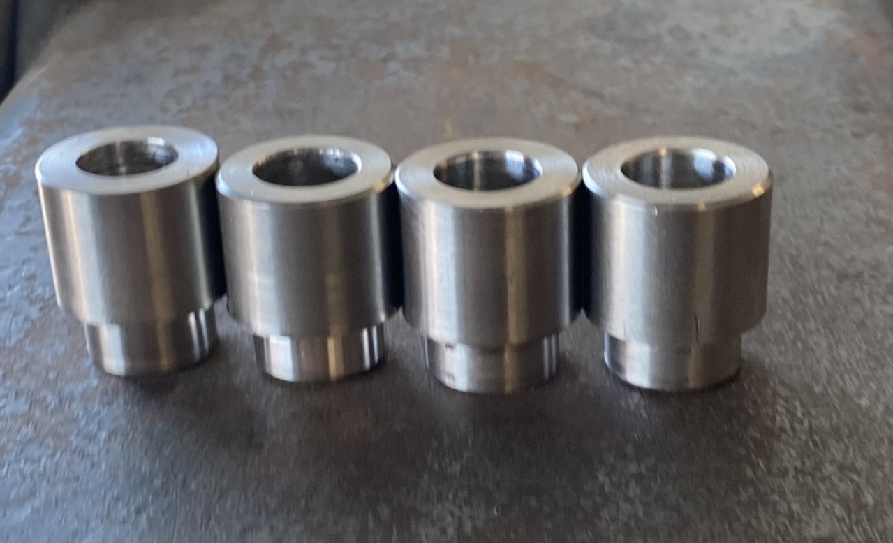

    Thanks for sharing this. I just used this reamer on some virgin spindles and it took less than 10 seconds to ream each one out.
    nudavinci64, Slashaar and Arcticelf like this.

    If you’re looking to do this, always ream before you weld the gussets. The heat noticeably hardens the material.
    Torspd, llibrm, jamesepoop and 2 others like this.

    That’s exactly why I bought a virgin pair of spindles. I’ll just sell my current ones with TC gussets on them.

    I welded mine then drilled it and it still cut like butter. Used same reamer too

    Are the steering extensions for the double shear zinc coated? I assume they don’t need any sort of protective coating, but I thought I would ask anyways.

    Aluminum

    Even better, I assumed they were steel.

    I had Harry get mine anodized

    The steering extensions are stainless, the only time I use aluminum is when I make complete custom tie rods
