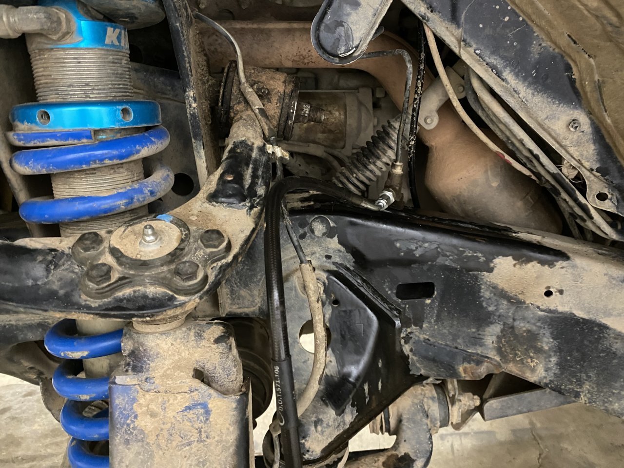

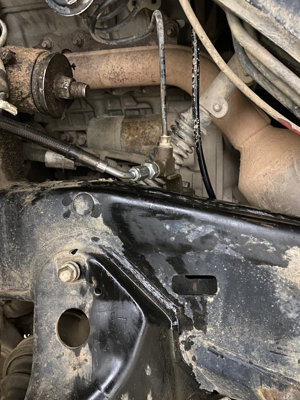

    EatSleepTacos
    Mar 24, 2015
    #151688
    55,172
    Randy
    Hampton Roads, VA
    4x4 2005 SR5 AC 6MT
    For the extended brake lines, which spot to they go to?

    Airdog
    Airdog did your Mom
    Dec 26, 2012
    #93790
    3,789
    Tom
    SoCal
    https://www.tacomaworld.com/threads/airdogs-2012-prerunner-access-cab-slow-build.264263/
    I went with #2. But that was probably wrong too.

    EatSleepTacos
    Mar 24, 2015
    #151688
    55,172
    Randy
    Hampton Roads, VA
    4x4 2005 SR5 AC 6MT
    That's what I was thinking, otherwise that hardline interferes with the UCA gusset.

    #6269
    desertjunkie760
    desertjunkie760 @DesertJunkie760 (IG)
    Apr 11, 2016
    #183963
    7,902
    Shane
    2011 MGM DCSB TRD Sport 4x4
    Check My Sig.
    They completely replace the OE hard line from the point you're pointing to in #2 and go straight to the caliper.

    81Trekker
    81Trekker [OP] Well-Known Member
    Aug 25, 2019
    #303299
    2,589
    La Jolla SD
    81 Trekker and 2015 CCSB Tacoma
    Too many to remember
    This

    EatSleepTacos
    Mar 24, 2015
    #151688
    55,172
    Randy
    Hampton Roads, VA
    4x4 2005 SR5 AC 6MT
    Thank you for confirming, that's what I thought but wanted to double check.

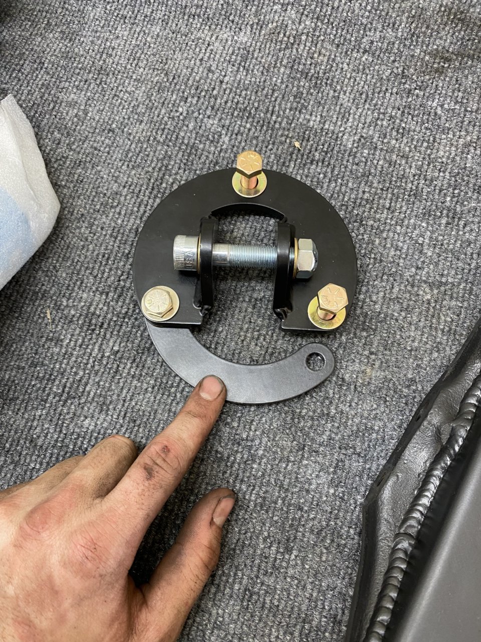

    RonRon23
    RonRon23 Well-Known Member
    Aug 25, 2013
    #111135
    627
    Ronnie
    Buena Park
    2013 MGM DCLB 4x4
    Front suspension: Work in progress JD Fab +4 LT, LCA pivot kit, steering slide rack, 934CVs Rear suspension: Archive Garage shock relocation and SUA Conversion,King 14x2.5 shocks, King 2x2 hydro bumps, FN wheels 5 stars, sliders
    What I did was place the fill plate on the area to be cut. If you notice it’s shaped similar to the frame. I traced the outline of it to the frame and cut out the inside of my lines. Worked some more of the frame so that this fill place sort of sat into a spot where I had close to 1/4 inch clearance from the CV.

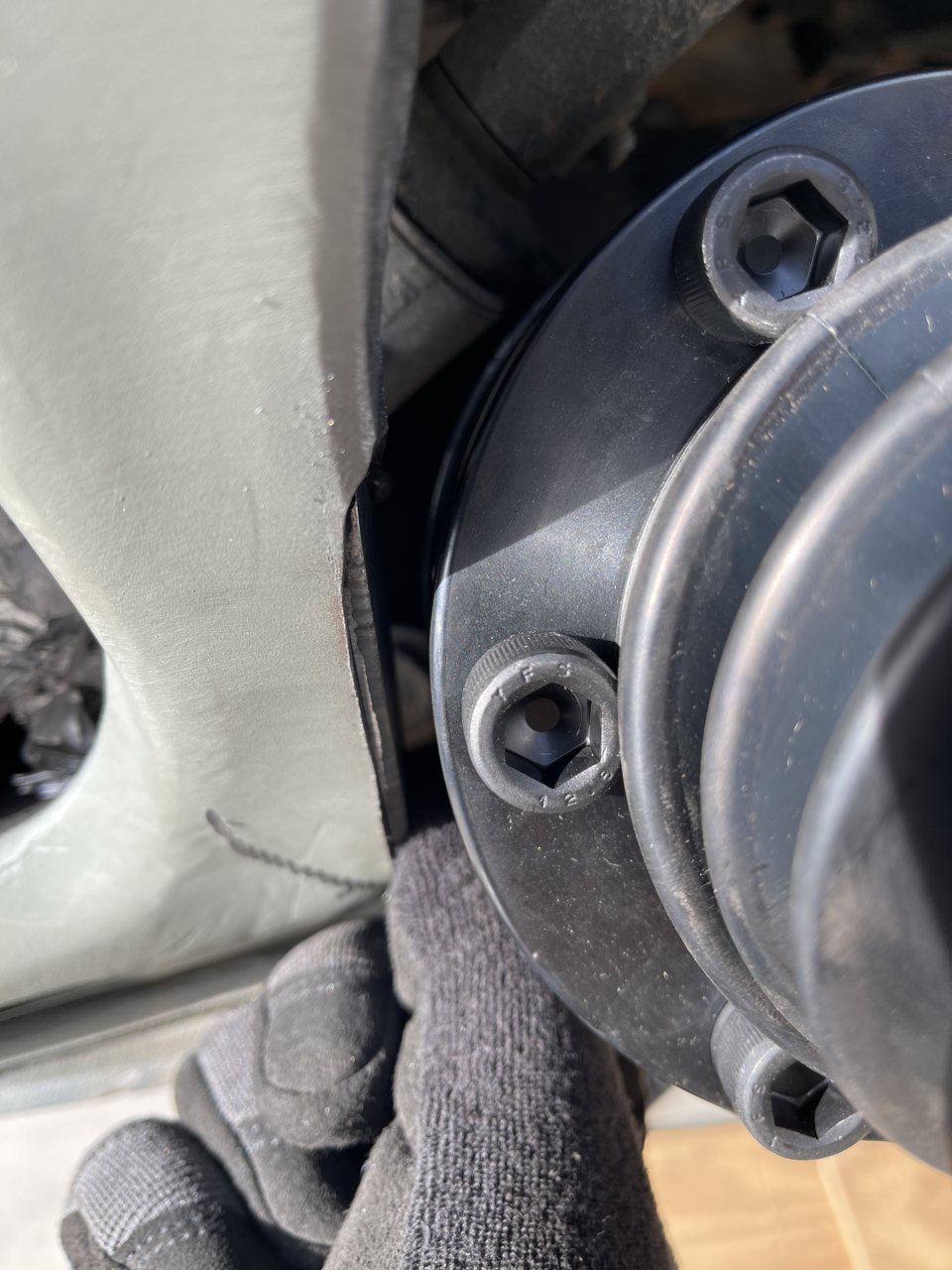

    EatSleepTacos
    Mar 24, 2015
    #151688
    55,172
    Randy
    Hampton Roads, VA
    4x4 2005 SR5 AC 6MT
    It’s pretty obvious once you get under there. To test fit the 934, you don’t have to seat it all the way in the diff. Just get the splines started and you’ll see if you have enough clearance. I could have taken out a little more up top to fit the provided plate in the frame but I didn’t care enough to.
