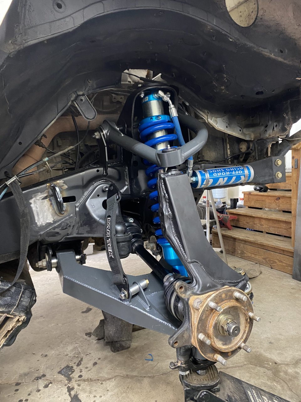

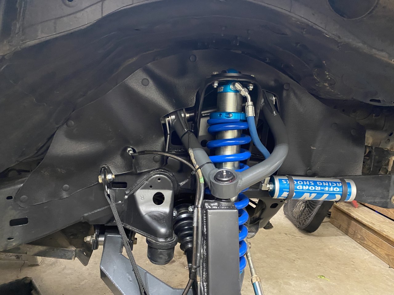

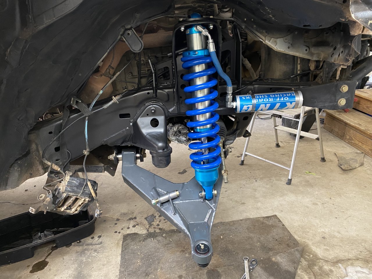

    I ended up clocking the upper frame mount 90° so it will clear the uca gusset but is also in a natural resting position.

    What’s the purpose of this and how does it install? Specifically this little additional piece. When I bolt it into the truck with it, the coilover can’t move freely.
    When I bolt it in without it, it seems to work like intended.

    My guess it goes on top if you’re not using the bypass mounts. To help strengthen the top hat between those two bolts.

    This is correct

    Yeah. So half moon/coil bucket/shock mount from top to bottom was my assumption. I’m using a bypass mount so I didn’t mount it.

    The limit strap is supposed to be spaced out away from the arm if you’re going to run a bypass. If not I’d get a shorter bolt and ditch one of the spacers
