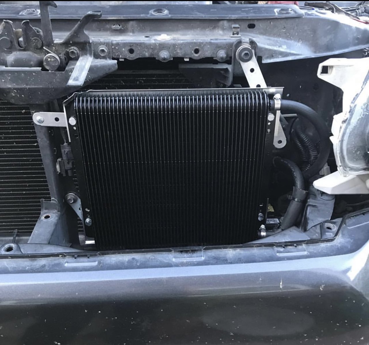

    anyways the spring under kit goes on today! Just need to cycle and weld on shock mounts. It was a rough ride getting the old hangers off. Particularly the ones under the cab. Had to remove exhaust and fuel tank, thankfully the fuel tank was only half full and I was able to lower it by myself. And I was able to plate more of the frame in.

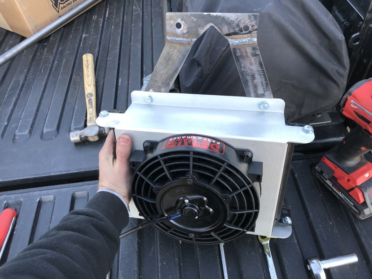

    this one works wonders for how Iv used it, maybe different for 37s but this was not too too expensive and it has a thermostat so my scatter brains doesn’t forget to check trans temp and have to use a switch for the fan. Also didn’t want to over cool it when I’m in colder conditions driving it normally.
