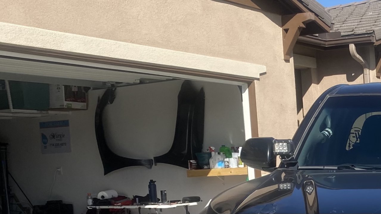

    Trailer Products makes a plus 2. Ive got some MGM ones hanging on the wall in my garage. Dis b dem

    For sale cheap!!

    Man, I would've bought those off of you if I'd have known.

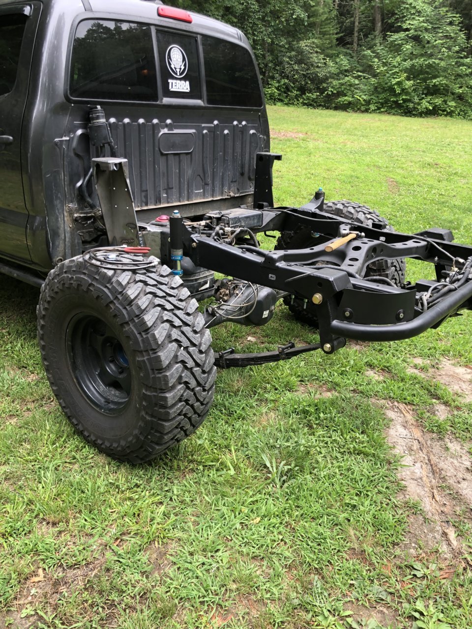

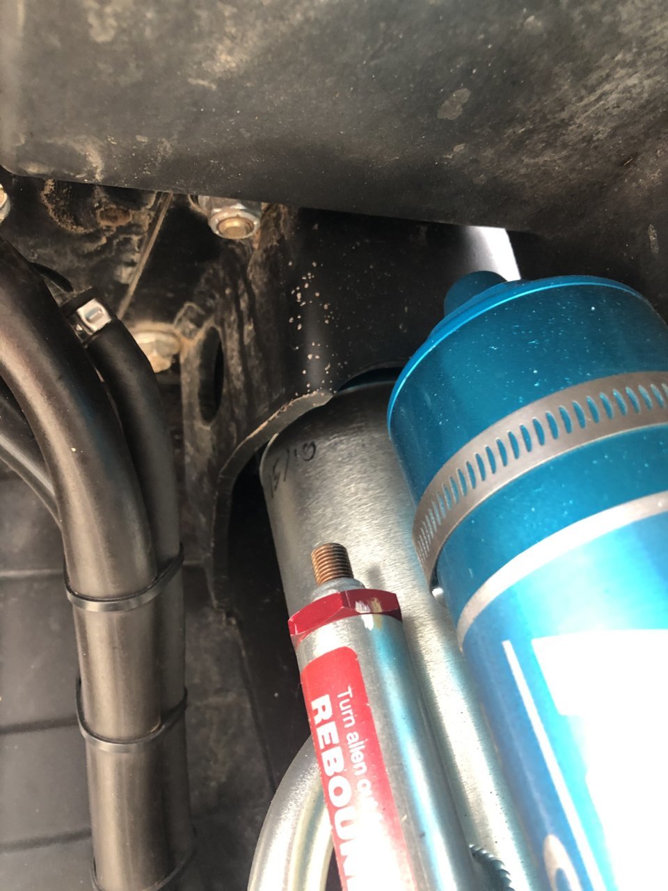

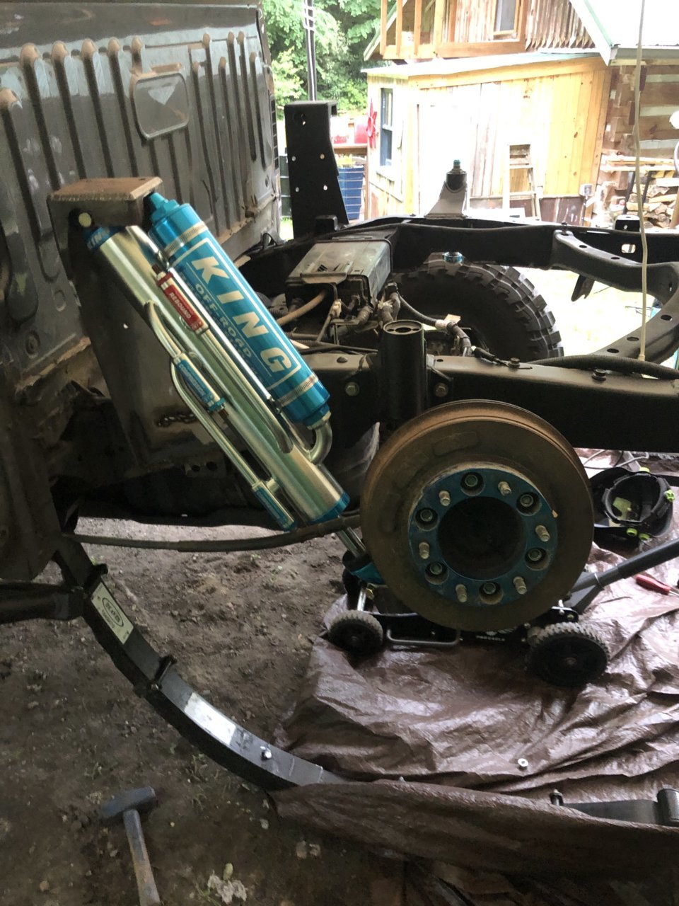

  13. Jun 22, 2021 at 12:18 PM
    #6473
    NcTaco27
    NcTaco27 Well-Known Member
    May 17, 2017
    #219292
    661
    Brenton
    East Tennessee
    2015 TRD off-road taco
    Lt front/rear Jd fab…
    Absolutely love the quality, I do wanna say this towers will not work with a frame notch. The shock cannot go down anymore on lower mount and at that you are still hitting ubolts, Ubolt plate, leaf springs, axle tube, and the bolts for the hubs. Sad to say but I’ll be cutting these towers off for a bed cage. Other than that the kit is awesome!! Disclaimer the poor judgment on wether this would work is my fault @81Trekker warned me this is a recipe for disaster.
    5F59164B-2ADA-4A98-B3D6-3373A4639016.jpg 5717DEE0-9BF4-4F7C-89A7-C63FC6CC2D8C.jpg E2C1DAD6-7BE7-4AAE-B5F1-2EBF478E5134.jpg
    freddy2923, RonRon23, kasnerd and 2 others like this.

    Are those 16” shocks? The body looks long to be a 14

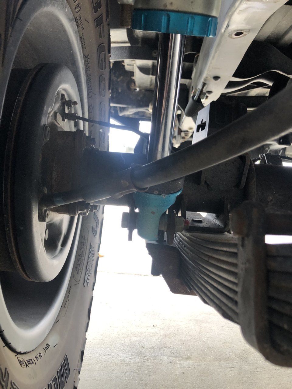

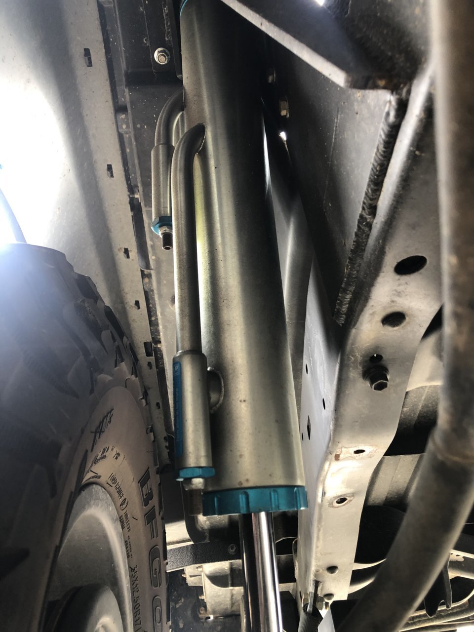

    The towers will work no problem with the notch, you have to change to a welded loop rod end

    14” looks long because they are 3.0s

    I don’t really get that because I had to lower the shock mount almost 7” lower just like I was emailing Jesse about and even then the shock body was hitting everything. And I’m not sure how you got these shocks to fit cause they were rubbing everything within the shock mount just sitting there not even being cycled.

    See the pics, everything clears no problem. If you change the lower eyelet to a welded loop you can get an additional 2” of up travel
