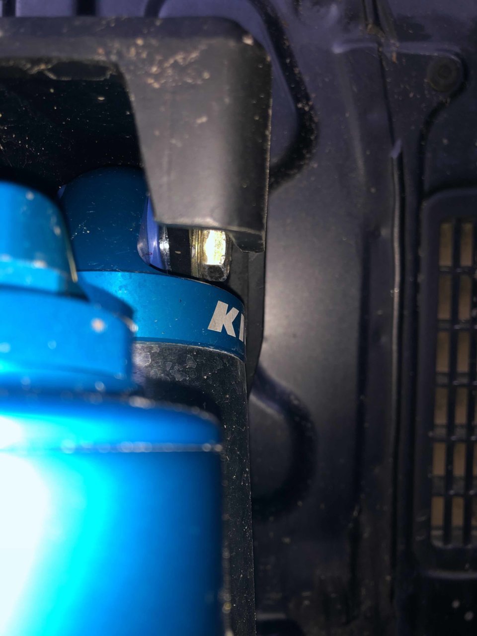

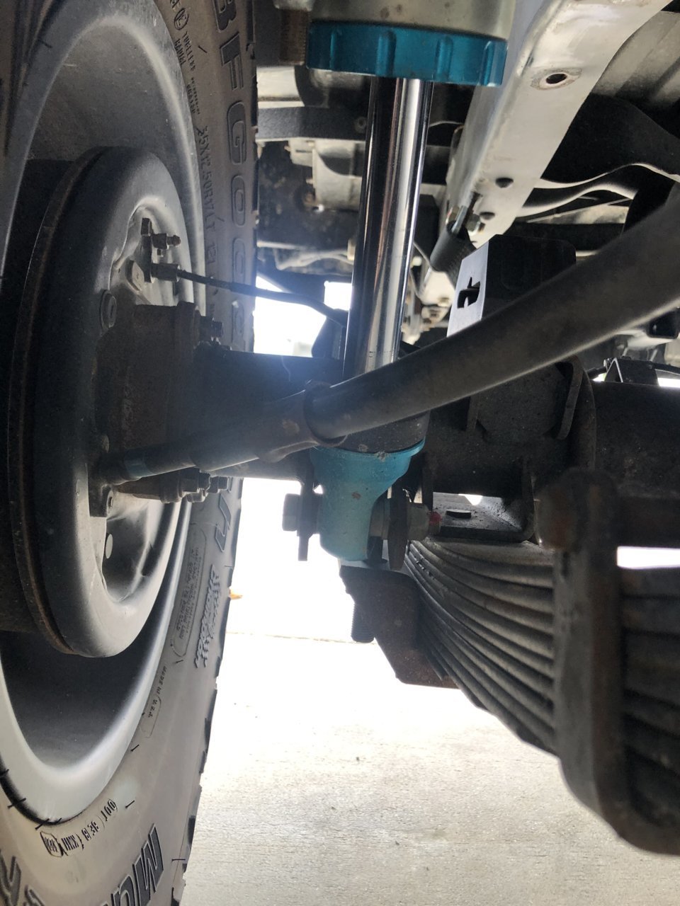

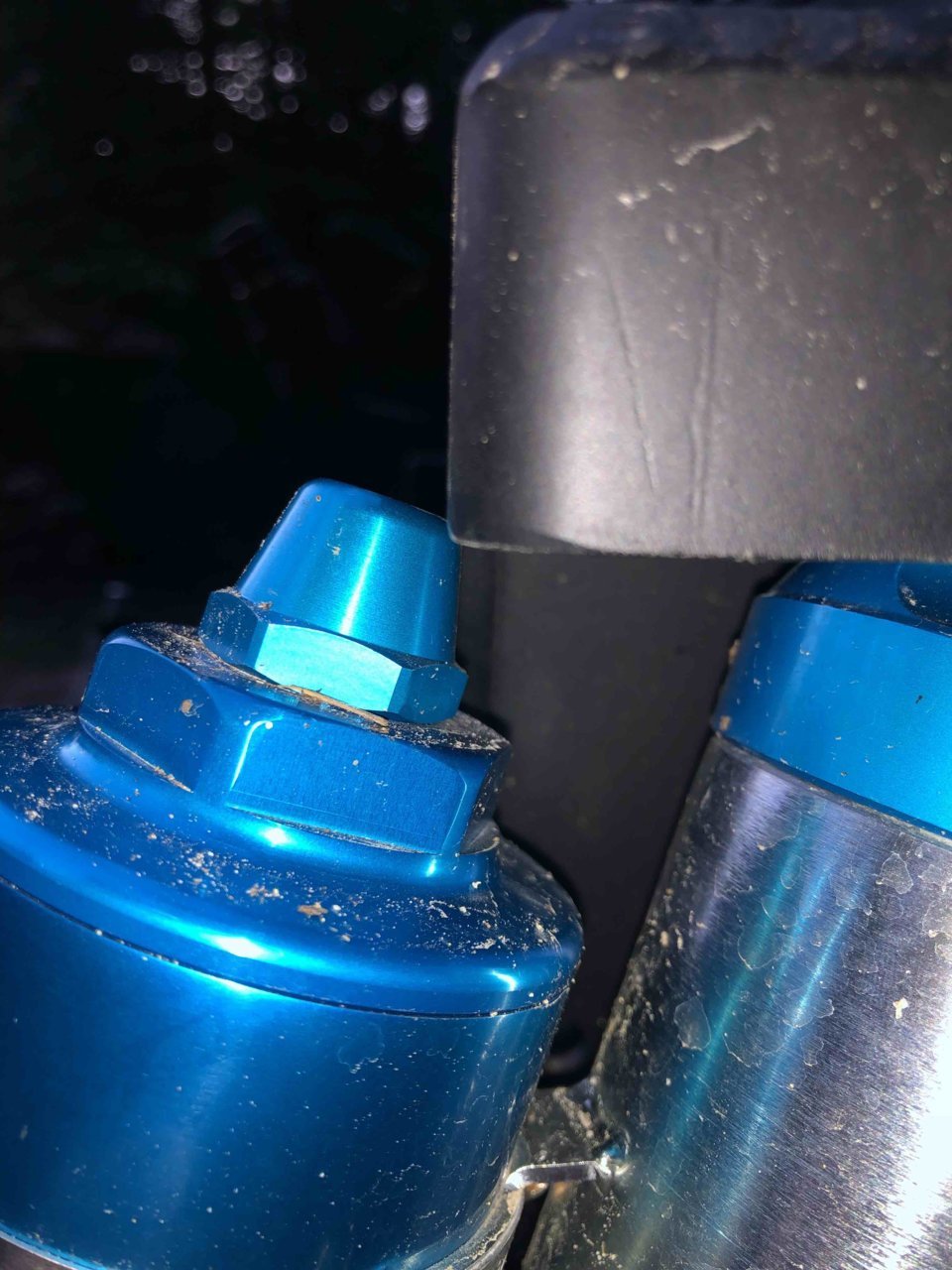

    This is at full droop so towards bump it only gets worse, and I think I got the wrong top cap then cause mine wouldn't even go in the tower until I trimmed the side. I might gain 2" of up travel but Im pretty sure ill be hitting shock body on springs and axle tube. not trying to argue or say you are wrong, I have just been measuring for 3 days in CAD and with card board mock ups making at least 20 different shock mounts to try and make everything clear and I can't figure it out, welded loop or not. To me my only option is to cut the shock mounts off and raise the upper shock mount 5-6" and then I can put lower dead middle on the side of the axle. also that way I'm not putting the bypass too far out towards the brakes and hitting the tire.

    I did this as well the picture was to just show that even if the axle was that far away it would still not clear as well as the upper shock mount was rubbing the dust cap for the reservior.
    Edit: I had to cycle it to find where to put bump pad anyways.

    Longer lower shock tabs to push the mount further from the axle? You just don’t want the shocks going past vertical at full droop. I mean something isn’t right and it’s hard to get the full scoop from the pictures you posted. Cycling without leafs also allows the pinion angle to change from where it would be in reality. That’s the only other thing I can think of.

    Yeah I’m gonna just have to take every thing apart and keep cycling. The problem is the mount has to be lower off the axle and more towards the cab so it can clear everything. And then it’s kinda hard to keep strength in mind because the shock has so much leverage on a skinny mount that barley fits in there. And still risk the same problem of hitting the shock body on the springs.

    Post up a bunch of pics when you cycle things again with the leafs. I still don’t see how the shock body is going to hit the leafs even with the frame notch. Again unless there’s something really weird going on that I’m not picturing
    Edit: stealing the pic Harry posted. You say your lower mounts are very low. Why? Why would you need them to be much lower than this? Even if you drop them 1.5-2” lower than this for the frame notch you shouldn’t be hitting shock body on the leafs

    Talked to Harry on the phone and I am pretty sure King messed up my shock order when it came to rubbing the upper shock mounts. And I’ll get as many pics as possible. I’m not use to messing around with pivots and such or the rear hanger. And I don’t know anything about the motion ratio on these shock mounts. So I don’t mean to say it’s not possible but I’m just not seeing how to figure it out at the moment. Thank you for the help!

    Awesome. Hopefully it’s as easy as a bad order. But yeah, just trying to help if at all possible. I think I’ve done 8 shock relocations now between myself and other trucks. No where near as much of an expert as Harry especially on his own products. But I like to think I have valuable insight from time to time
