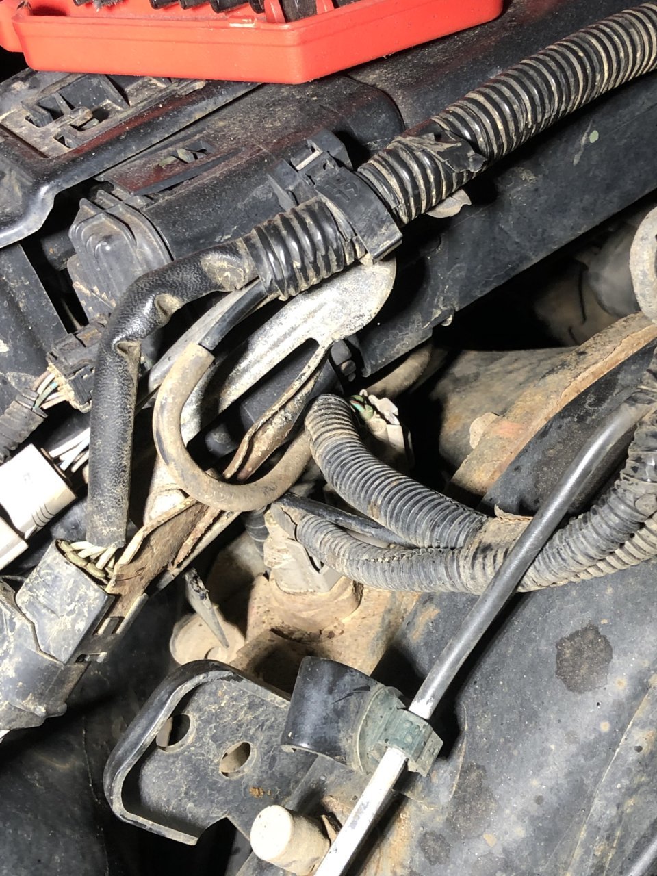

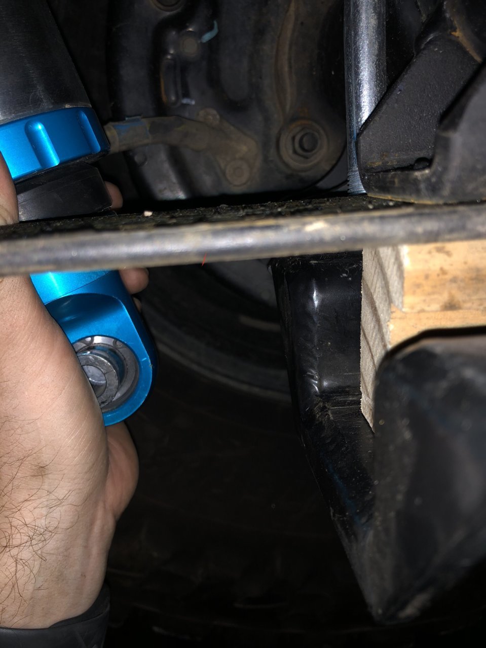

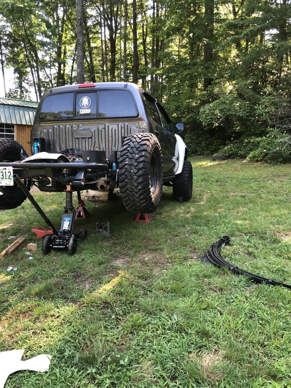

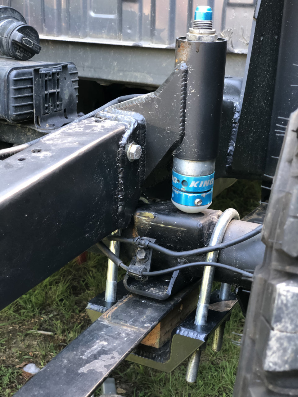

    5787A655-7710-425E-B254-B79E9362C990.jpg 5E15D723-D1C9-453F-8072-EACEC324AB1E.jpg EDED340A-8906-4A2A-8138-306C5427573A.jpg 330B6213-8C2C-415B-A638-041EAE4D4B6E.jpg Got everything cycled last night and had to redo some stuff that I missed before, brake line was hitting the notch and a bracket was hitting e-locker wiring. Cycled 18” with the notch. Just need to still figure out shock mounts tonite, again same problem is making a mount that either goes over u bolt plate or one that snakes around it.
