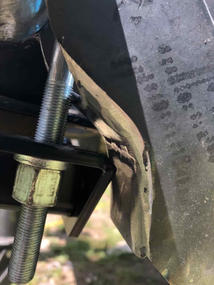

    2A81C5B6-1ECB-4E39-99A5-43CDD65119BC.jpg 07908CDF-66C0-4F57-AD41-98DA79750AF4.jpg C50CB79B-B1DB-463C-87B1-BF1C7F9F8993.jpg EDDE090A-8BE0-4DF8-8711-C13878F0B28F.jpg 1AB79780-2909-4EEB-B9F3-D0F6268824A6.jpg E5646F5D-B8DB-4131-962B-1895306DB177.jpg

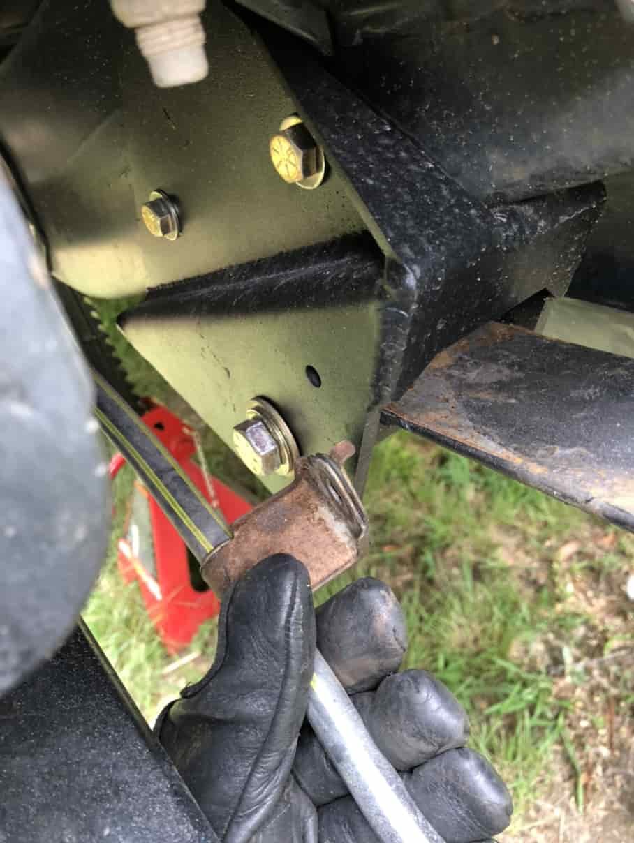

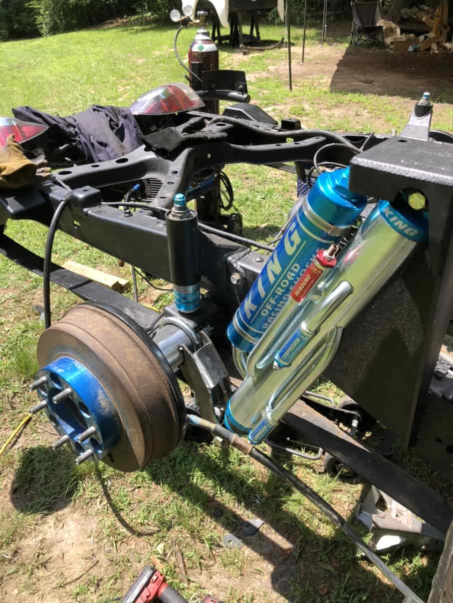

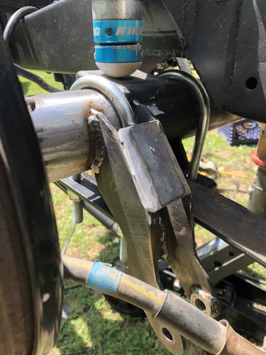

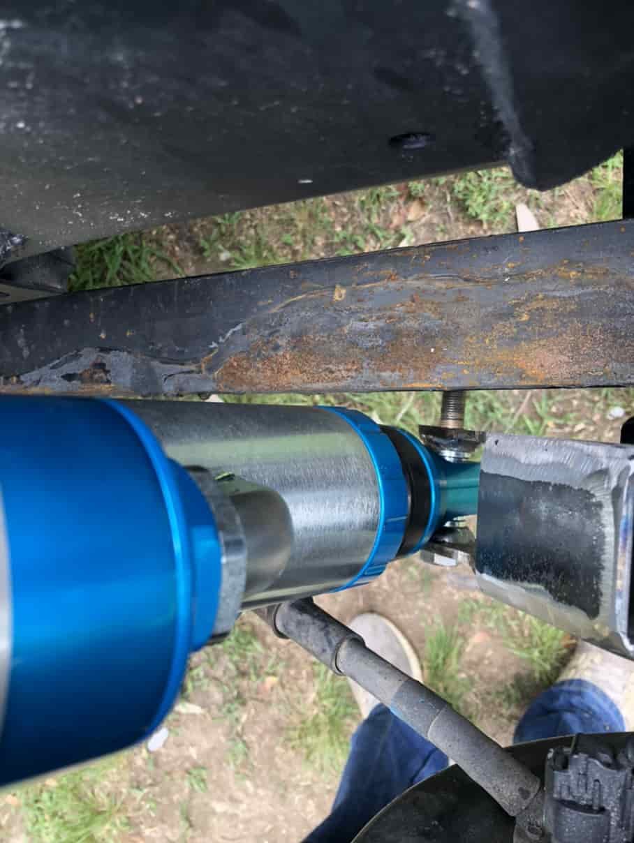

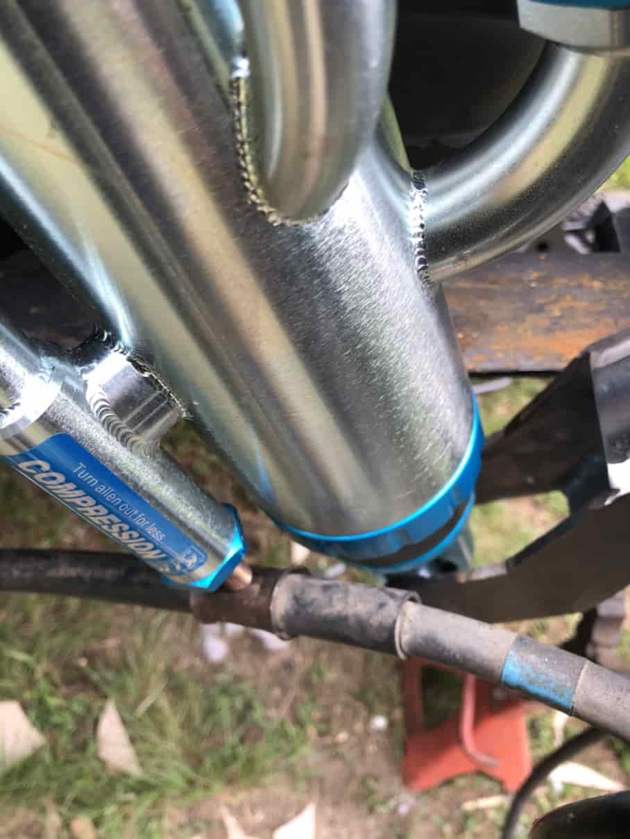

    got everything cycled and shock mounts are on, also got the fuel filler neck fixed with the provided hose to lengthen the two smaller tubes. And now I just need to clean everything up, painted and put back together as well as cut the bed and bed sides.
    @81Trekker whats a solution for the e-brake cable. I don’t want it smacking the bypass all the time. As well as how do the extra plates attach to the towers? I see on a pic you posted a few days ago the bigger one is sandwiching the bed from the bottom and I’m guessing small one on top of the bed?

    If your truck is an auto I’d do the good ole parking brake delete with a cutoff. Mine is a 6speed and I’m damn near ready to cut them off because they are always getting jacked up.

    Yeah my worry with that was 35s could put some wear on the trans like that. I don’t live in a flat area right now.
    Edit- I guess it’s called a parking pawl. Yeah I’ll keep the e brake lol.

    If you didn’t want to do the welded loop like I said you could have just cut the towers off and moved them up on the frame.
    and for the e brake you bolt it to the spring hanger and route the cable out of the shock path

    Yeah I thought about that but I would have destroyed them trying to get them off. That’s why I thought about just building a bed cage.
