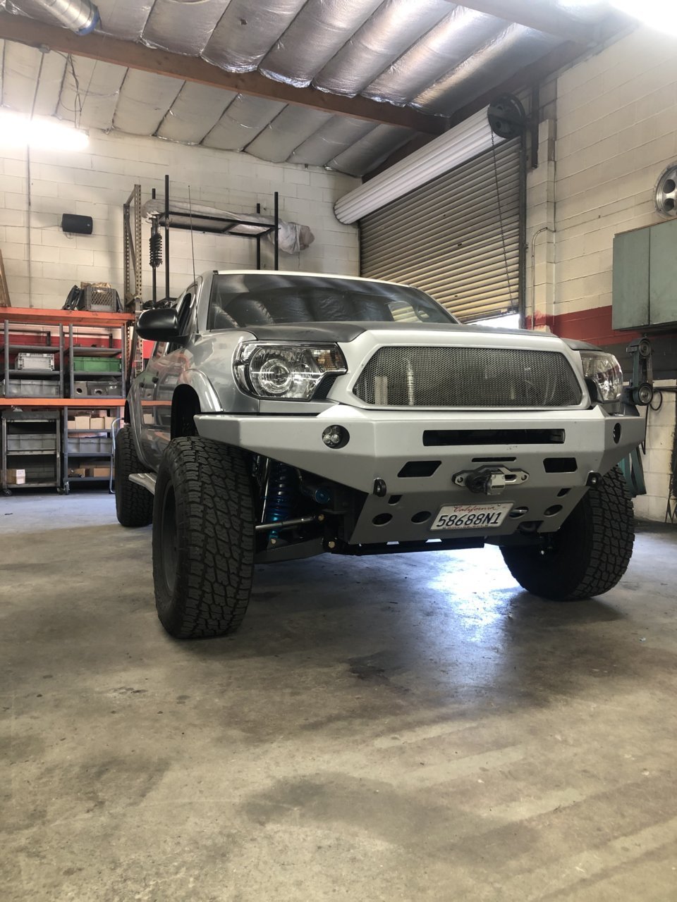

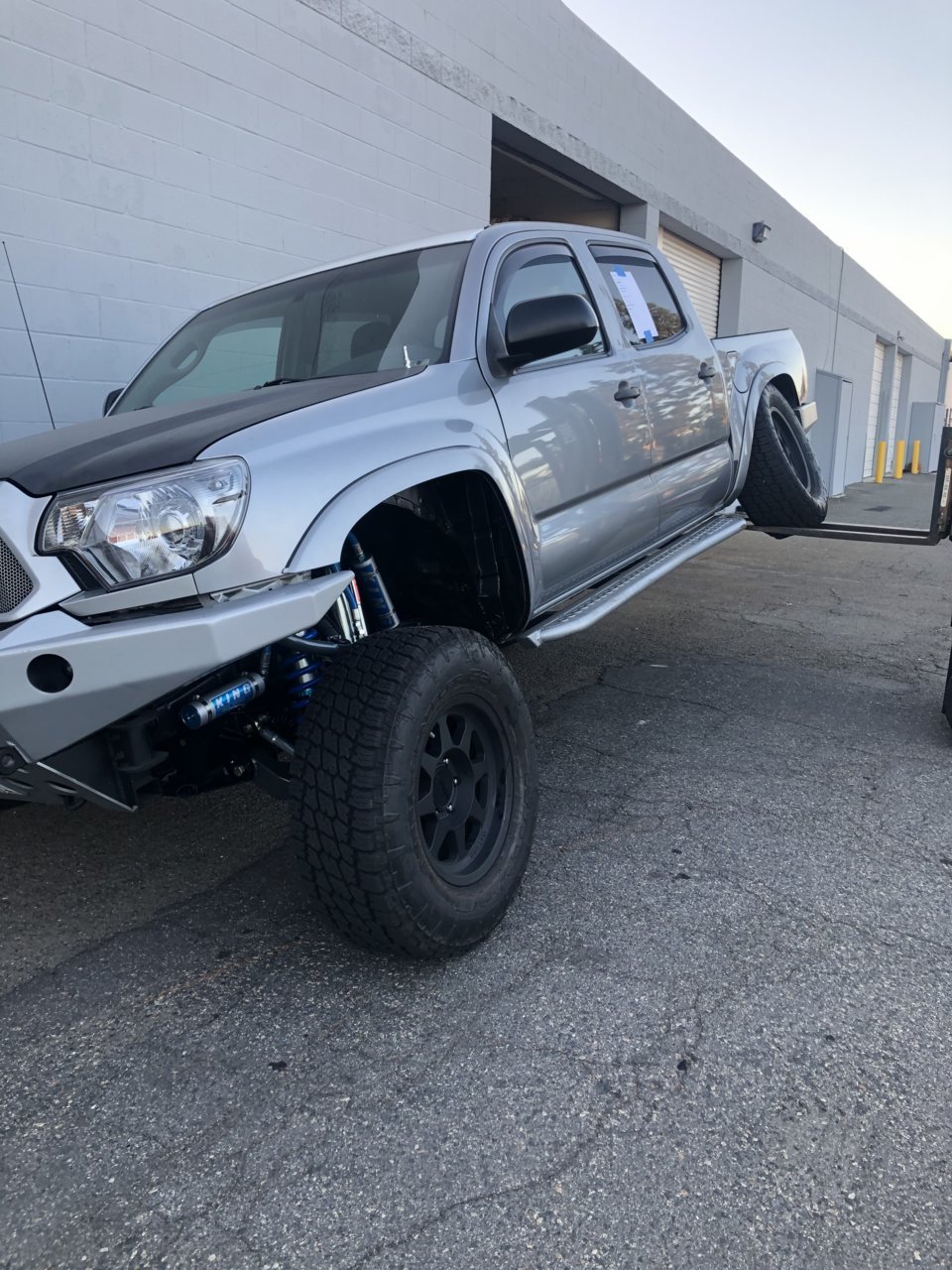

    What is the frame height? 35s, correct? It looks like you're running no lift whatsoever.

    no lift...??? :rofl:
    this is long travel suspension...no lift kits anywhere near this shop unless they are being removed.

    I’m gonna let you in on a little secret. Long travel can still provide lift, i.e. the trucks static ride height is higher than that from the factory. :gossip:

    Most folks aim to run a 50/50 up/down travel split to maximize traction. For desert driving ground clearance is not as much of a concern. The +2 kit may give you about an inch of lift just from the longer arms and the 35’s will net you a couple of inches too so all together 2-3” taller than stock. The 35’s eating up the gap to the fenders even with the cut fenders make it look like it’s sitting low.

    This is what I was trying to determine. The truck looks super low given how much has been cut from the fenders/flares, thus the frame height question.

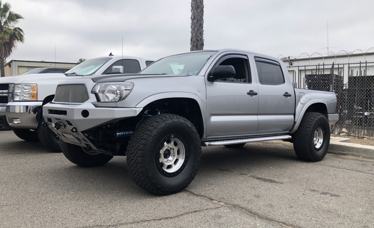

    on 33s for reference, same suspension
    those are the 35s... I don't have a good pic for the LT on 33s
    This is on 33s...

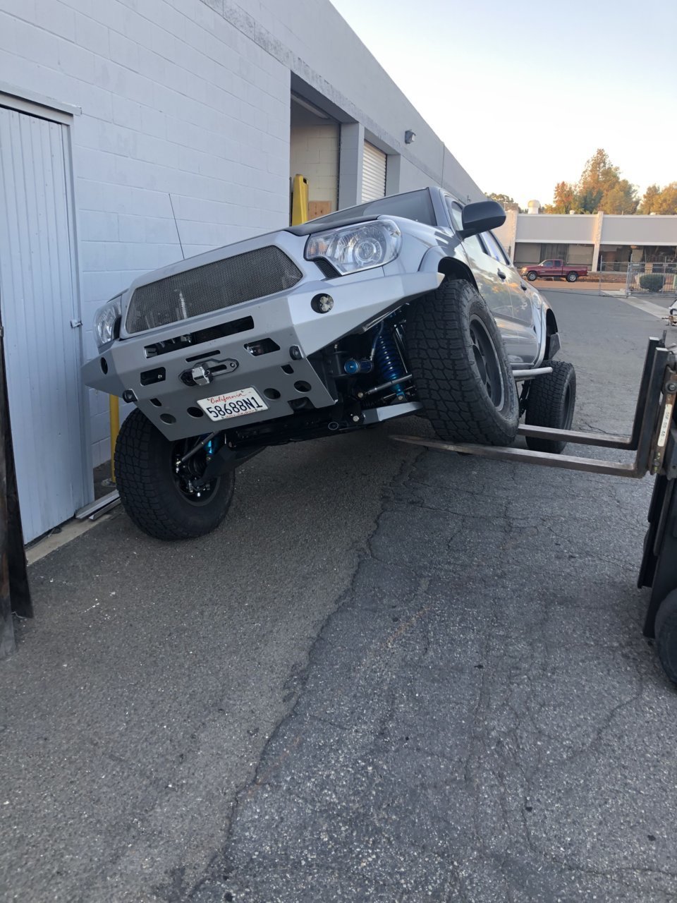

    Flex test

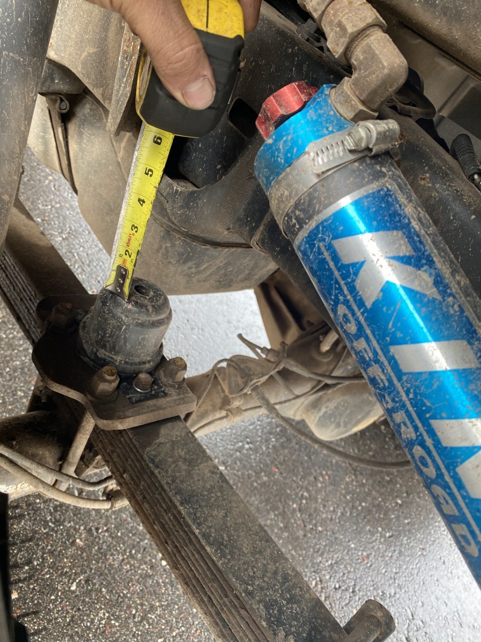

    I set them up to sit really low and when you go spring under you can still have a good amount of uptravel.

    What kind of numbers are we talking for uptravel with the SUA?

    8” of up travel at stock ride height

    Its about 14" travel in the front (with the new inner fenders) and 19" in the rear. realistically that's probably about ~13 and ~18 in use. You can set your ride height accordingly.

    well add the thickness of the leafpack and some for the bump, that's your difference with SUA

    There is no comparison, spring under is night and day. Not just because of the up travel but the additional arch the springs have is what allows them to be so plush. On a Tacoma the springs go negative at full bump which makes them ride like shit
