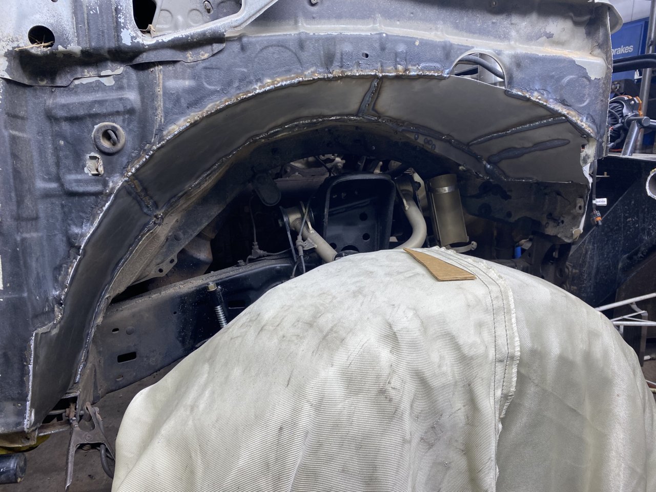

    Are you saying the tubs need to be cut even with 35’s? Or just if you notch? I’m assuming I’ll have a little work with 37’s even with no notch. But luckily, I’ve got a good connection with someone that has the skills and tools to bend me up some new tubs if needed.

    My tub needs to be cut with my 33"s, I rub about 1/2" and had to adjust for that in the bump. Otherwise Id get about 3/4" more uptravel if the fender tub wasnt in the way. I dont understand sometimes how people run 35's and say they dont rub at full bump when 33"s barely fit

    Well, currently my 37’s don’t rub anything front or rear. But I’ll likely have issues with the SUA. As far as the front, well I cut the shit out of that…

    Thats exactly what I need to do too...nice job on the tubbing!
