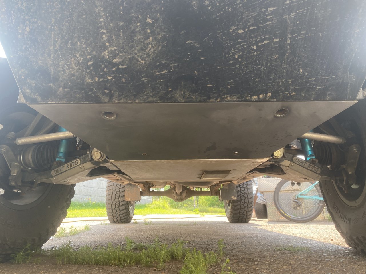

    Finally got around to making a new skid. Really like how it all flows into the pivots. Once I do the LT and likely fiberglass I will build a new bumper and do the tuck. FA38C6F1-1287-4B04-B4FE-77DF200117F9.jpgC8495567-F7DD-4587-926D-69AB8AE3B2DD.jpg

    How big of an improvement in ride quality? Sure does flex nice!

    Are those roost guards for the rear shocks?

    Yes they are. I was going through a set of shafts a year from rock spray. I cut down some old flaps I had and it seems to have solved the issue.

    Very cool. It took me one trip out with my new shocks on a long gravel section to start trashing mine, and since then I’ve been using some generic shock boots that I cut to ride height. Been on for the past 5 or 6 and have been working out very well. Doesn’t take much to start pitting them.

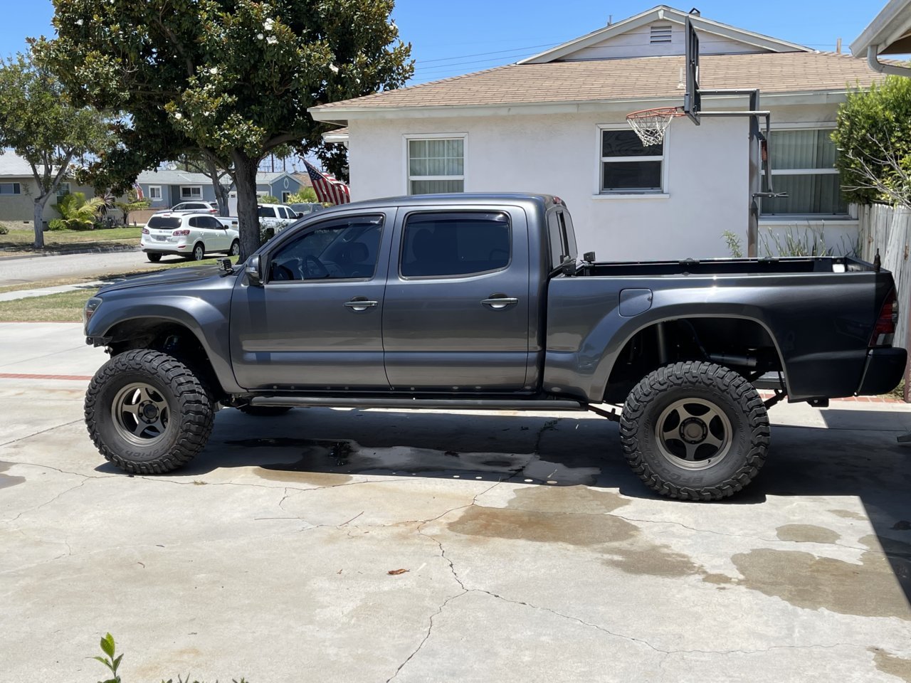

    RonRon23
    RonRon23 Well-Known Member
    Aug 25, 2013
    #111135
    1,302
    Ronnie
    Buena Park
    2013 MGM DCLB 4x4
    Front suspension: Work in progress JD Fab +4 LT, LCA pivot kit, steering slide rack, 934CVs Rear suspension: Archive Garage shock relocation and SUA Conversion,King 14x2.5 shocks, King 2x2 hydro bumps, FN wheels 5 stars, sliders
    Well last night I moved the arms forward another half inch. 2 spacers towards the firewall/1 towards the front.
    I had to increase the preload a few spins to gain my ride height back. Thanks again to @Airdog for coming by with his alignment tool.
    We ended up setting the caster at 4.5° and camber at -.5° We did have to flip the forward cam over to adjust inboard more. To even up the caster we had to bring my camber back in as I was shooting for -1°.
    I think if the arm was pushed all the way forward, I can get a more aggressive alignment. Though this works for now and may end up right where I want it if it settles out more.
    Can’t wait to get this rear end redone to lower it down some. 95A5BB30-3B06-4612-8A6B-03F02DBC306E.jpg
  12. Jul 4, 2021 at 2:53 PM
    #6872
    BamaTaco56
    BamaTaco56 Well-Known Member
    Mar 25, 2017
    #214383
    10,307
    Trey
    is droop limiter thingy a technical term?
