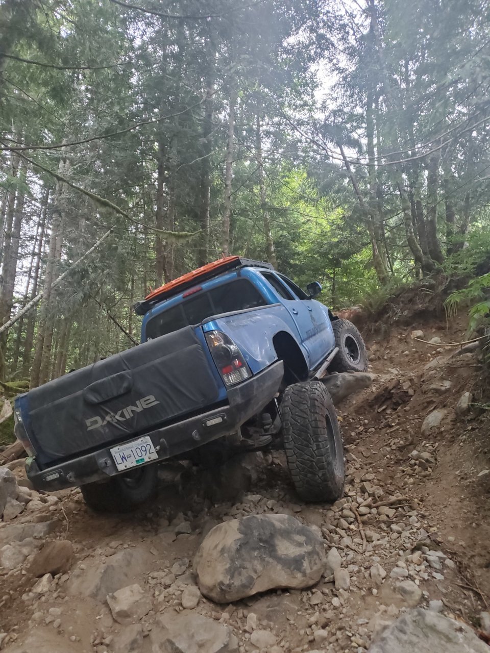

    My slide rack, Howe pump and rear long travel kit arrived yesterday. Stoked to get that all installed. Snapped a CV this evening though. The inner 934 is fine, but the axle or the outer went. Not sure which yet.

    I thought that was supposed to be almost impossible?

    I’ll be curious to see how you get the outer joint off while keeping the shaft in tact, assuming it’s the outer joint. That’s been something I’ve wondered about if I were to ever snap an axle.

    That’s disappointing. Front locked? What’d you plug the diff up with to get back? I kept two spare reg travel cvs in the truck but two spare 934s ain’t in the budget. Might cut the stubs off of some trashed ones unless there’s a better way
