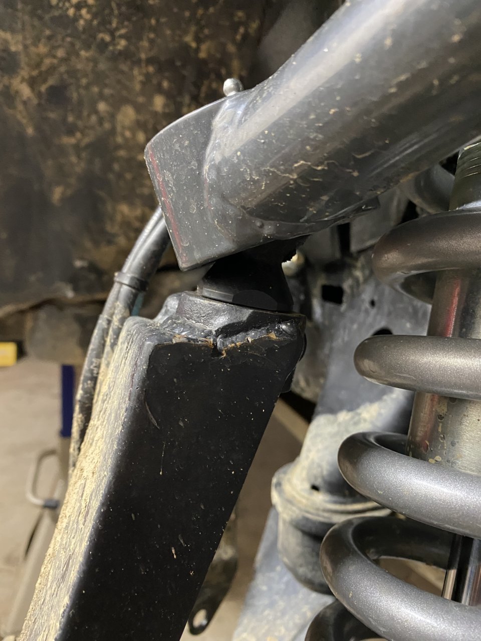

    23* strapped or unstrapped? Assuming thats not strapped it may be less than 1" depending on where you strap it

    Unstrapped. But we covered earlier in the thread (or maybe it was in the LT BS thread) that Harry limits the coilvoer to 7.5" so even without the strap, the kit is safe. The strap is just there to work with the coilover in unison at full droop. I'm not losing any droop based on the strap. This is full droop, unstrapped and still a good safety factor before uniball hits metal. If I really wanted to I could remove the droop limiter in the coilover and squeak a little more droop out of this, but I'm not getting hung up over fractions of an inch.

    Not to disagree with the guy behind the product, but last year I had a buddy rip his Fox coilover apart because he wasnt strapped. Thats why I ended up strapping mine this year. It ripped his cap right past the clip.

    It is strapped. I just meant that the strap takes up the brunt of the force but it works in tandem with the coilover at droop to minimize force on the coilover without robbing droop. At least that's how I have mine set up.

    Right, but what is the angle strapped at droop? thats my main question. If its 22* or less youre talking a loss of maybe 1/2"

    That shouldn't matter, right? I would think that the ultimate final droop angle is what matters, after taking strap stretch into account. If you're running regular CV's you should strap it so even at full strap stretch, you're still not getting onto CV binding. I just unbolted my strap so I could see what that ultimate final droop is in my garage.

    Right, but if full droop to bind or full extension is 23* what is strapped full extension? 22* maybe? So if the stock inner can do 21, you’re still talking 1/2” or so. And in the big picture, that’s a pretty expensive 1/2” if you don’t currently have issues with CV’s.

    What I'm saying is at full droop, nothing is binding, not even close. So I'm using every single bit of the kit as it stands on my truck, all 23* worth. Maybe that's the disconnect here.

    I get what you're saying now
    That's what I'm getting at.

    If I were regularly hucking my truck then I would limit it a little more. But in an OEM setup, the coilover is the limiting factor and on most trucks, that's not an issue and in that specific regard, this kit is similar. The straps see most of the force, plus I only crawl, so I don't foresee an issue. If I blow apart a coilover in the future, I'll eat crow and own it.
