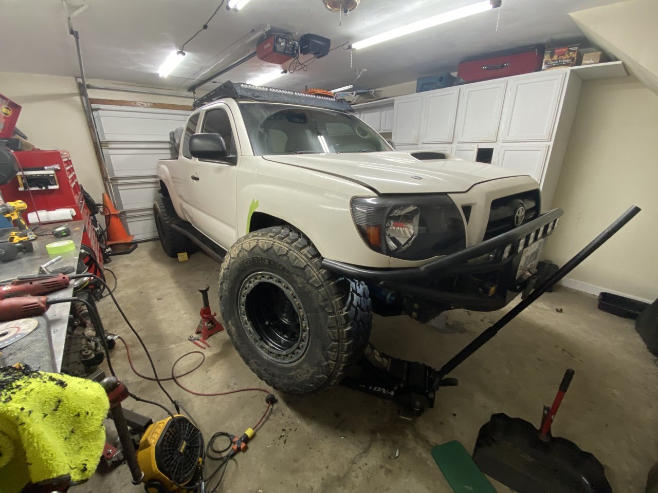

    Having some fun in the garage today actually cycling this kit. One piece of advice, don’t rush the install like I did and actually take the time to do this.
    She clears lock to lock, just needed a little more trimming up front. I did already tub my firewall but I am getting away with stock cab mount cut to pieces.
    My super bumps weren’t doing their job of protecting the suspension. The upper uniball was hitting metal on metal before the bumps bottomed out. I’m adding a 1/2” spacer to keep from metal on metal contact again.

    The ball joint was topping out before anything else and you don't have hydros?

    Correct. While parked like this, I walked around and inspected stuff and found the upper uniball to be metal on metal. My super bumps were engaged but they’re so soft that they could still compress more. I have a little divot on the inner part of each uca where uniball was hitting metal on metal under full stuff. Not a huge deal, just something to note.

    I don’t know, hard to say since I’ve already tubbed my firewall. Here’s my clearance at full stuff and lock with 3.5” bs 9” wide wheels.

    Did you notate how much shock travel was left at that point? Aren't the Super Bumps supposed to be close to the OE bump height?

    There’s 1.75” left of shock at upper uniball metal on metal.
    The super bumps are a little taller than OE but they compress further than OE. When I switched from OE to super bumps on my mid travel, I noticed I would scrub the top of the inner fender on hard hits. I didn’t do that before on OE bumps because they’re so firm.

    I’ve seen a few other LT manufacturers, such as my dirt king kit, provide spacers for the oem bump stops to space the bump down. Think mine are like 1/2” thick. But you still having 1.75” of shaft showing seems like a lot

    My guess, and I could be wrong, is that Harry slightly clocked the upper uniball to be more for droop than uptravel to keep the tire out of the inner fender. This is full stuff. Or just recognized that it doesn’t necessarily matter if there’s a little unused shaft at bump. It is nice knowing I’ll never bottom out my shock.

    You have the shock installed incorrectly if you have have that much shaft showing. There should only be about a 3/8” shaft when the cup tops out

    You tell me

    Is the shock mount on top of the bucket?
    It needs to be mounted underneath.
    Here is a pic at full bump, the 3.0 with a welded loop shows 5/8” shaft and the coilover is at 3/8
