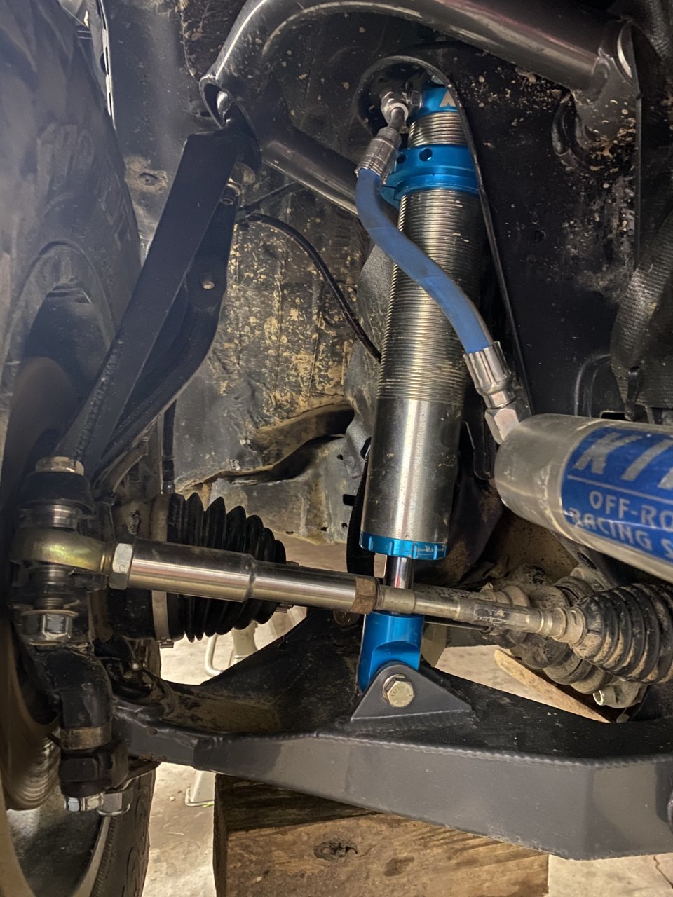

    Shock mount is underneath the bucket. I bolted it to the shock off of the truck and then bolted it in like any other coilover.

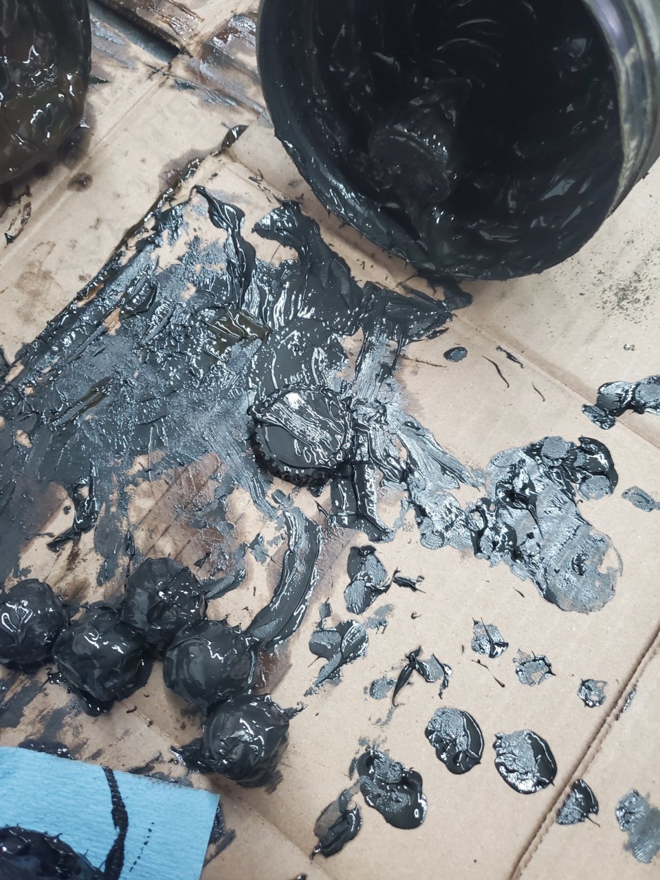

    I'll pay for it, my f* up so it is what it is! I'll order some other stuff too :)

    The spring retainer isn't on the pics that @EatSleepTacos posted but is on Morgan's truck. That's 3/8" difference alone.

    here’s a better pic of it

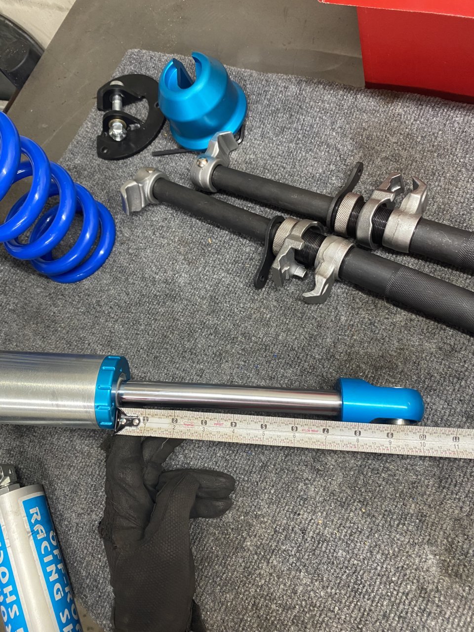

    that’s not an accurate way to measure if you don’t have the bottom spring perch on, they are pretty thick

    I just checked and it's exactly 3/8" thick. So 1-3/8" remaining shaft then.

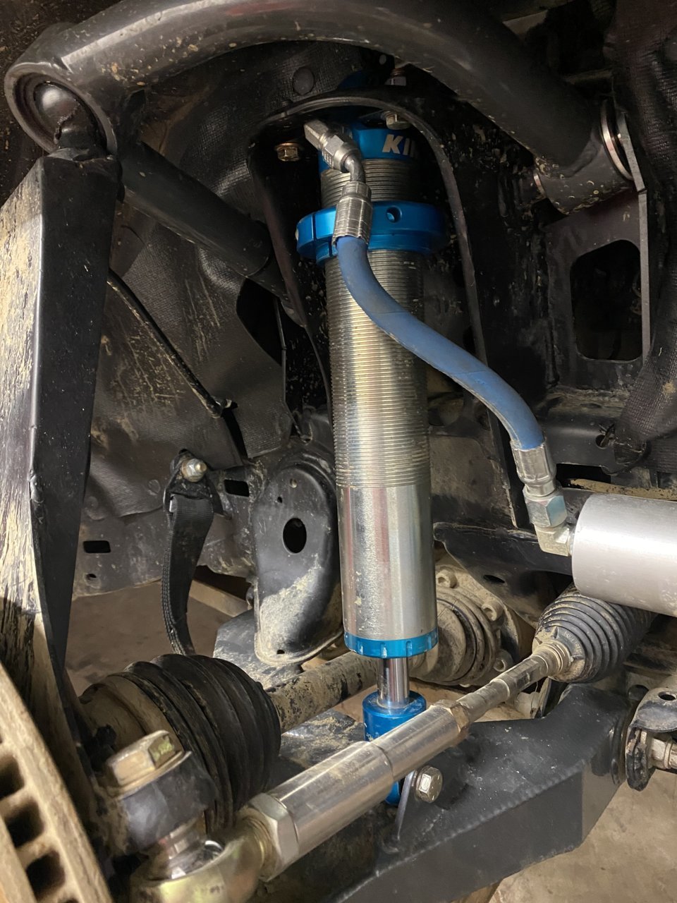

    Here’s my final guess. I put on my coil perch to better compare it to the pic Harry posted. When you compared where the red vs the green line is, they’re closer than we think. Enough that the difference could come from the lca further forward on Harry’s truck.

    Here’s this pic I took the other day. 7.5” of shock and a 2.5” rod end.
