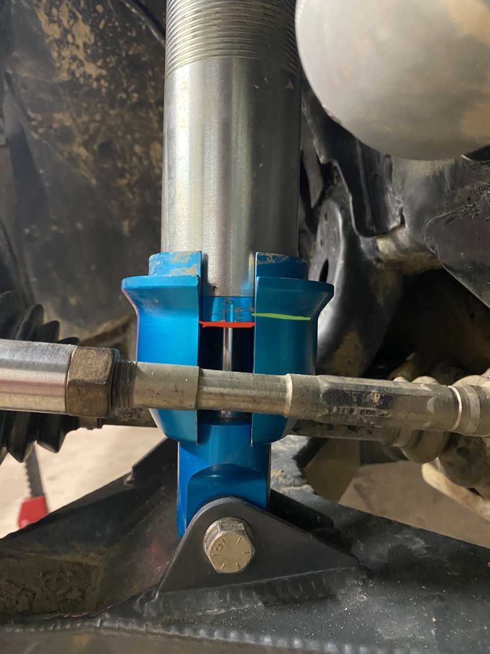

    I don't see a rubber bump stop on the shaft of that shock. There's another 1/2" of shaft.
    Also, get a set of durobumps.

    If I’m getting anything it’ll be air bumps. I was window shopping this morning.

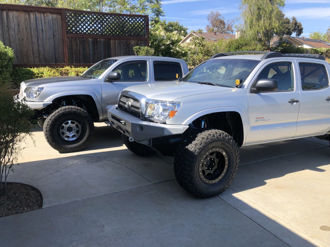

    You can run the LT kit with the arm pushed all the way forward if you have a slide rack and are willing to do the work to the inner fenders.
    Both of these trucks are pushed the full 1 7/8” forward

    Both of those statements are wrong.
    If you're relying on the little rubber bump on the shock as a bump stop you've done something wrong and are barrowing time with high interest rates. The rubber bump is not measured when discussing shock travel.
