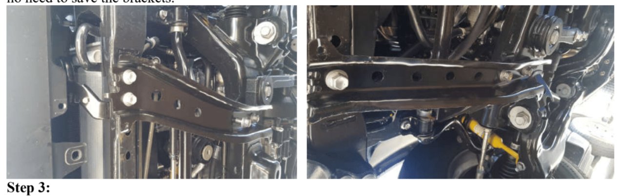

    I bent my 3/16 steel ones all to shit like they're gonna make good gusset material :rofl: I wasn't too concerned.
    Yes I will to get the same strength that I'll achieve I'd have to jump to 5/16 or thicker as an unsupported skid like ALL the current ones that are made. Or gusset the shit out of it and it weigh a ton. The skinning with uhmwpe also will add some rigidity. I don't need to go huge as far as tubing size goes for the bracing and that has a lot more strength and bend resistance to weight ratio than flat plate unsupported does.

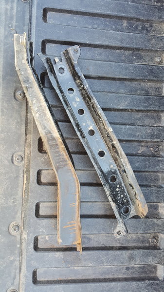

    He’s talking about these. We wheeled yesterday, he attached the skid to the thin hole you can see on that bracket.

    These? Those get junked with the majority of aftermarket skids. My skid reuses where those bolted, as do most others.

    Oh yeah those kill ground clearance compared to aftermarket skids on the market already.

    Interesting, I didn’t know that. Those will definitely get ditched then.
