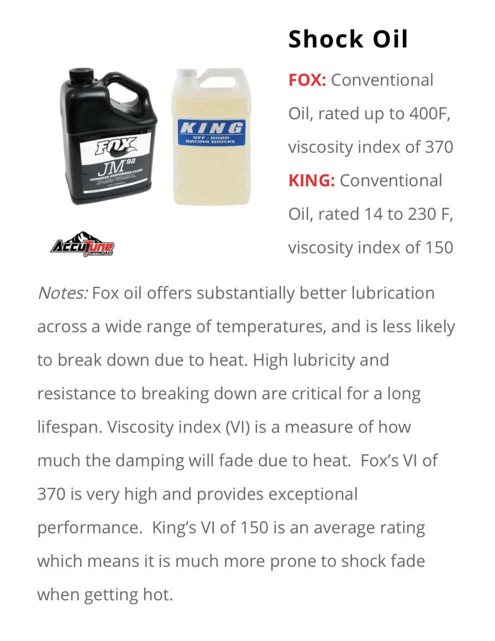

    it varies per manufacture but the article referenced gives a good guideline.
    You can buy temperature stickies that you stick on the shock body and give you a good idea of the body temp. Very common to see used for this purpose.
    Shock fade is bad. If you feel your shocks fade then they are either too small or need new oil.

    Did a good bit of reading last night, it sounds like with the standard seals you want to be in the low to mid 200* range. Anything over and viton is needed. Viton unfortunately isn’t an option for me with the cold weather. Will give the truck a thrashing this weekend and report back with some numbers. Though, external temps won’t be super accurate it’s my only way of checking.
    So essentially my line of thinking is this. Since viton isn’t an option, if my 2.5’s get close to 200* external temps internal is likely close to that mid 200 mark. At that point it’s likely justified to jump into the 3” for extra cooling. Especially considering I will likely push the truck harder with the SUA and LT, which will only add to it.
