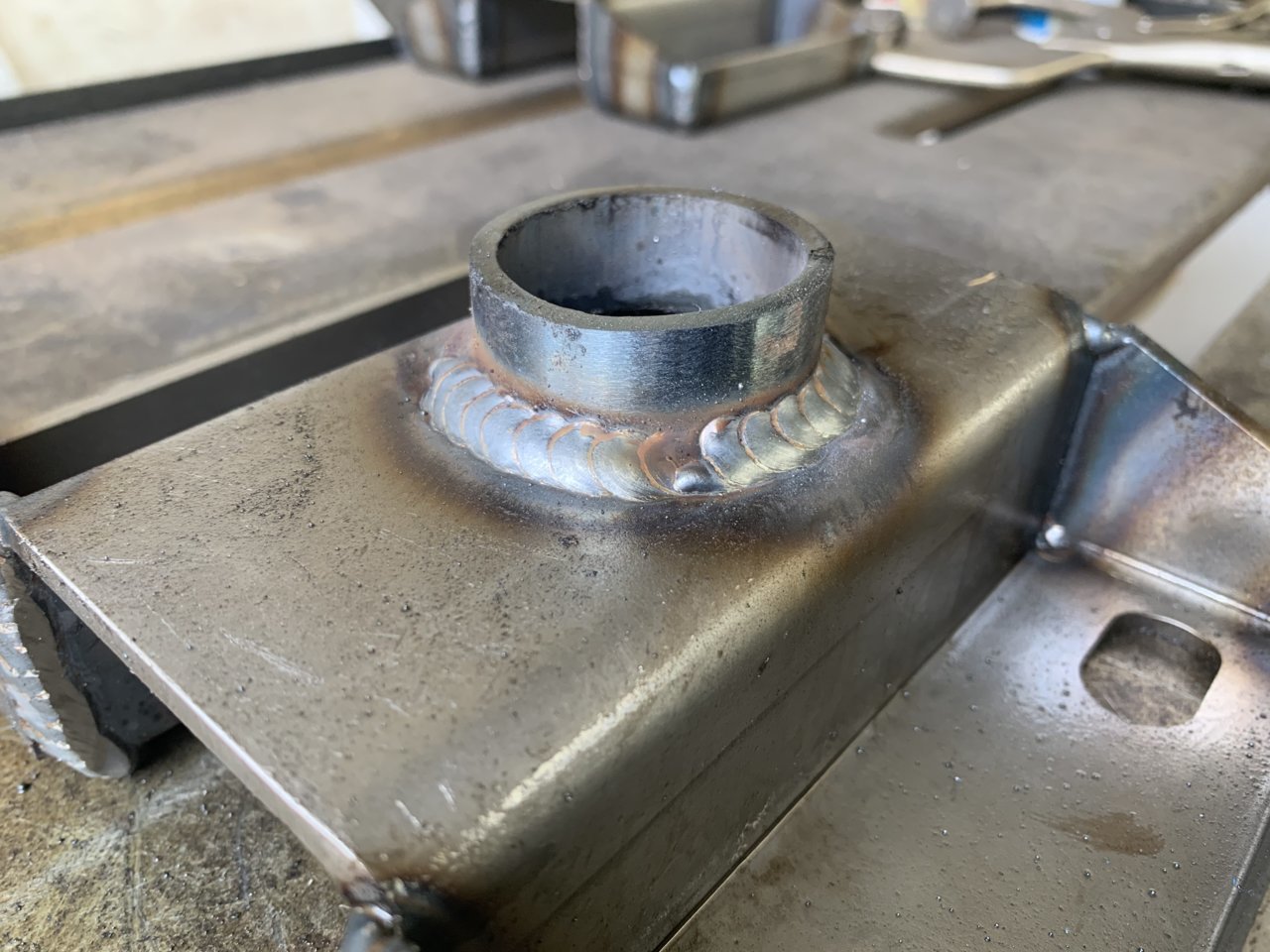

    Did you pulse that?

    Just regular Hobart 140 with max voltage making loops

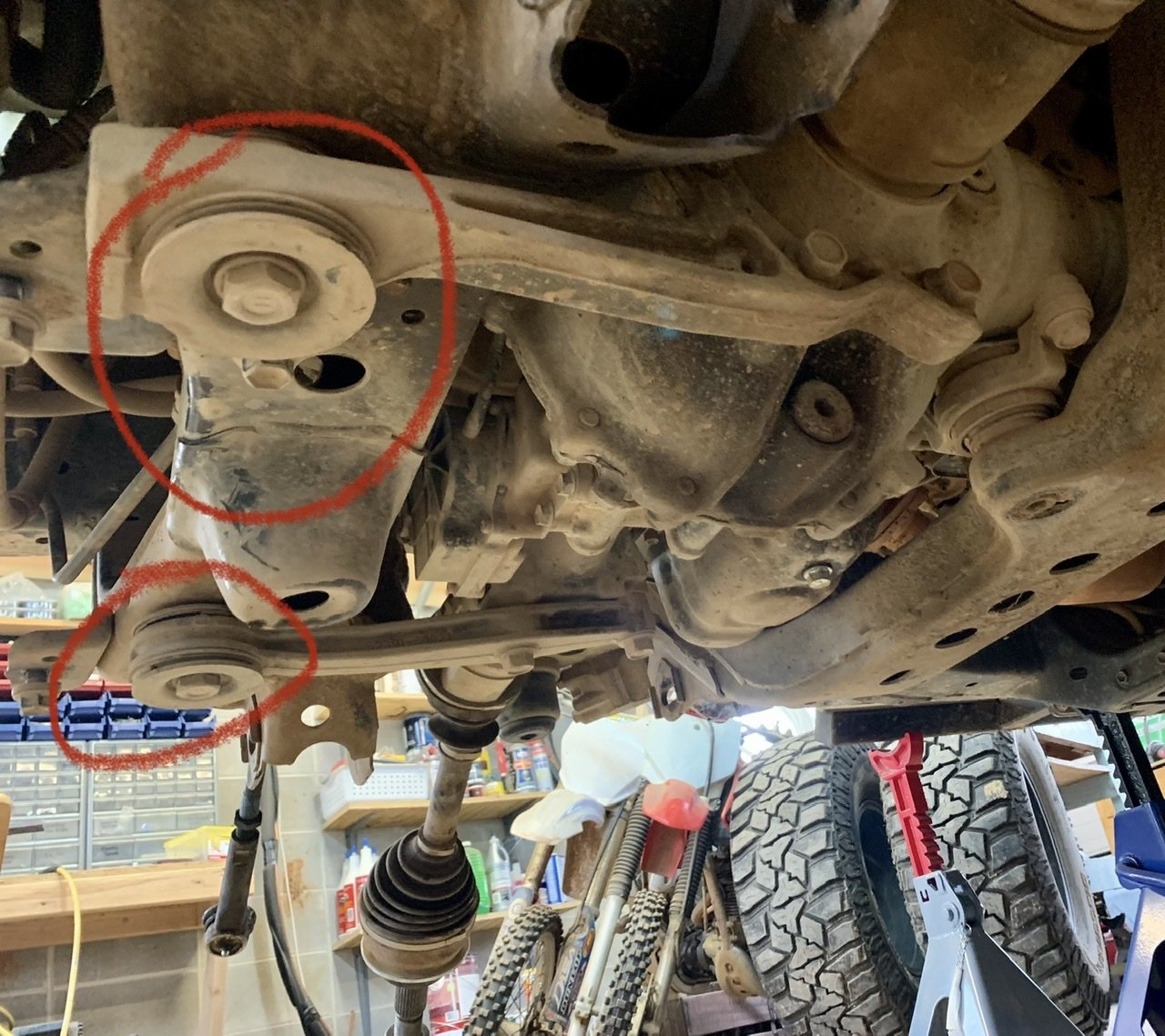

    Will I need the factory UCA washers for the +2.25 with coil bucket gusset? Not sure where they’ve wandered off to…

    Nope

    OEM bushing washers are usually cupped to fit the rubber molded bushing and aftermarket ones are usually thicker and flat.
    Edit: I'm sure they'll give you a set of washers, but you'll only need the inner ones they send you as the gusset can be the outer "washer".

    There’s no inner washer either, at least with the uniball bushings in the upper. Though looking at the site again it appears rubber bushings in the upper isn’t an option anymore.

    I noticed that. Maybe I got the last one. Some or all of my stuff shipped so I’m jumping the gun and tearing stuff out. I don’t want to be rushed tried to fit it all in in one weekend. I was going to remove the front crossmember like you did, but with the giant arb I’m not sure if it’ll be worth the effort.

    Is it acceptable to make a skid that rests on the diff mounts or is it a no no to transfer energy directly to them?

    I'd leave a little gap there. I'd be more worried about the skid chewing up the ends of the bolts or in some crazy instance hitting and messing up the bushing there.
