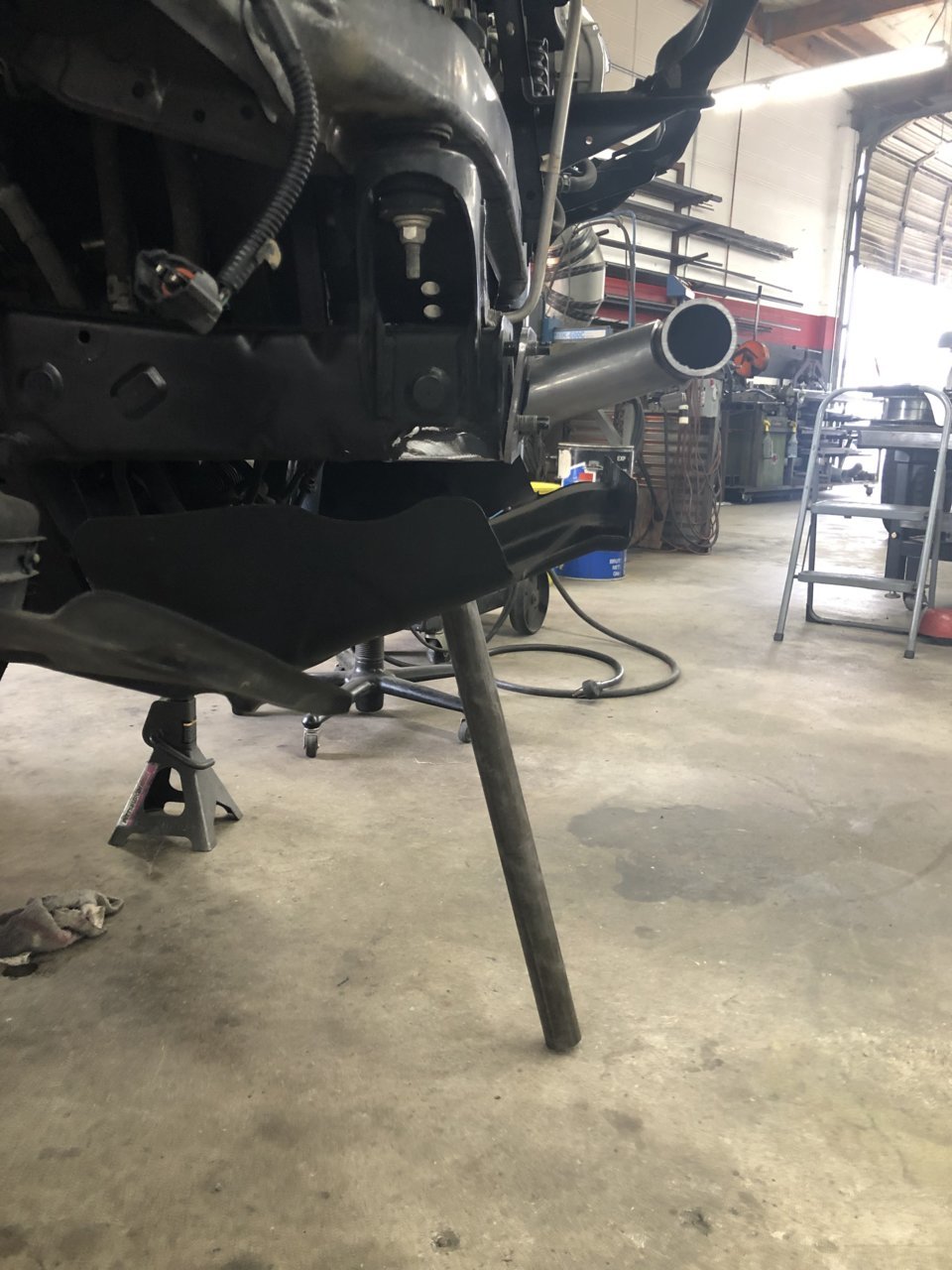

    How low does the skid hang? Can you measure off a reference point? I want to compare to my current skids if you have a second to check! See what the clearance gains are

    Just an FYI, but my sua pack hangs no lower than the bottom of the diff. And although I did drag it a few times on the rubicon, it was my shackle hangers that gave me far more problems.
