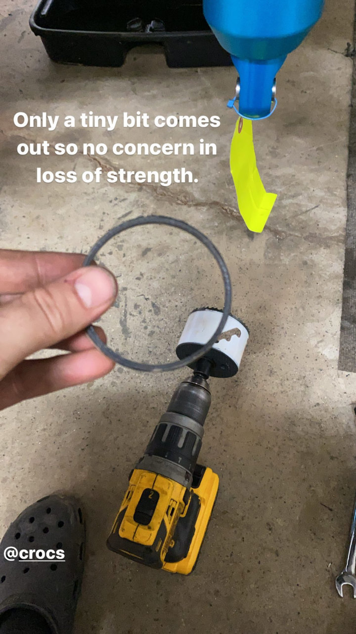

    3.125” hole saw to drill out the coil buckets? I guess the template mounts to the top?

    3” saw. And yes it mounts to the top. The pilot bit in my saw wasn’t long enough so I swapped in a full length drill bit to get it done.
    I started drilling the hole with the drill spinning right, like normal. Once the pilot hole was drilled, I switched it to spin left so the hole saw was spinning backwards against the bucket. Did that for 5-10 seconds to get it started, then back to spinning right. I’ve found this works well for hole saws in thinner material/new, sharp hole saws. Otherwise it’s too grabby.
