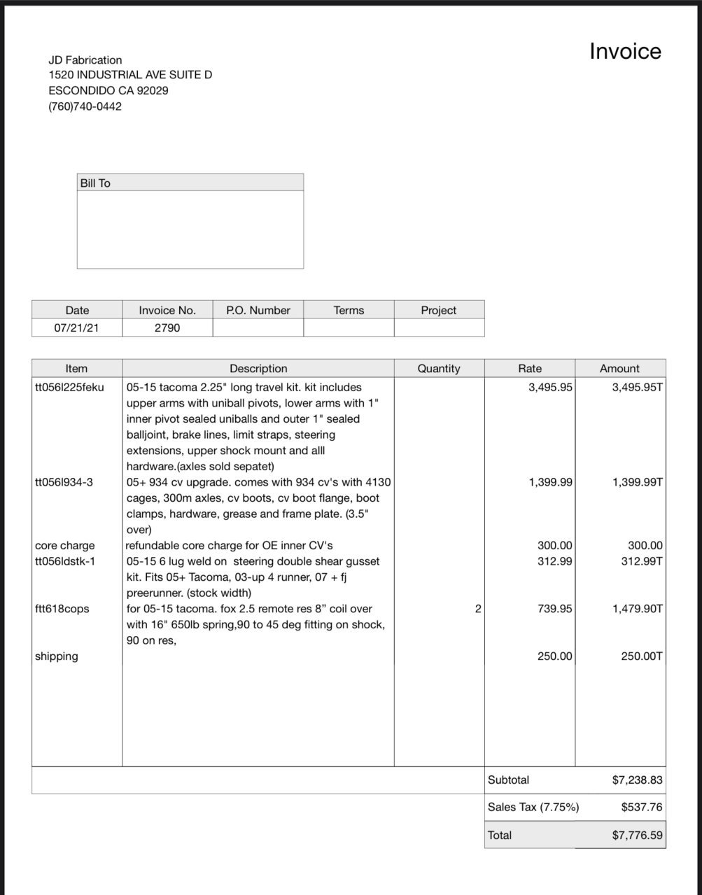

    Screen shot to the wife for yesterday’s trip to JDFab
    At this point I think she’s just a broken women.

    No she’s just smart and knows shock lead times will push you into 2022 right now. She’s saying to order your shocks now

    Yep, Im calling friday to order mine. Planning to have everything for June. At least it makes it less painful to spread it out over 10 months.

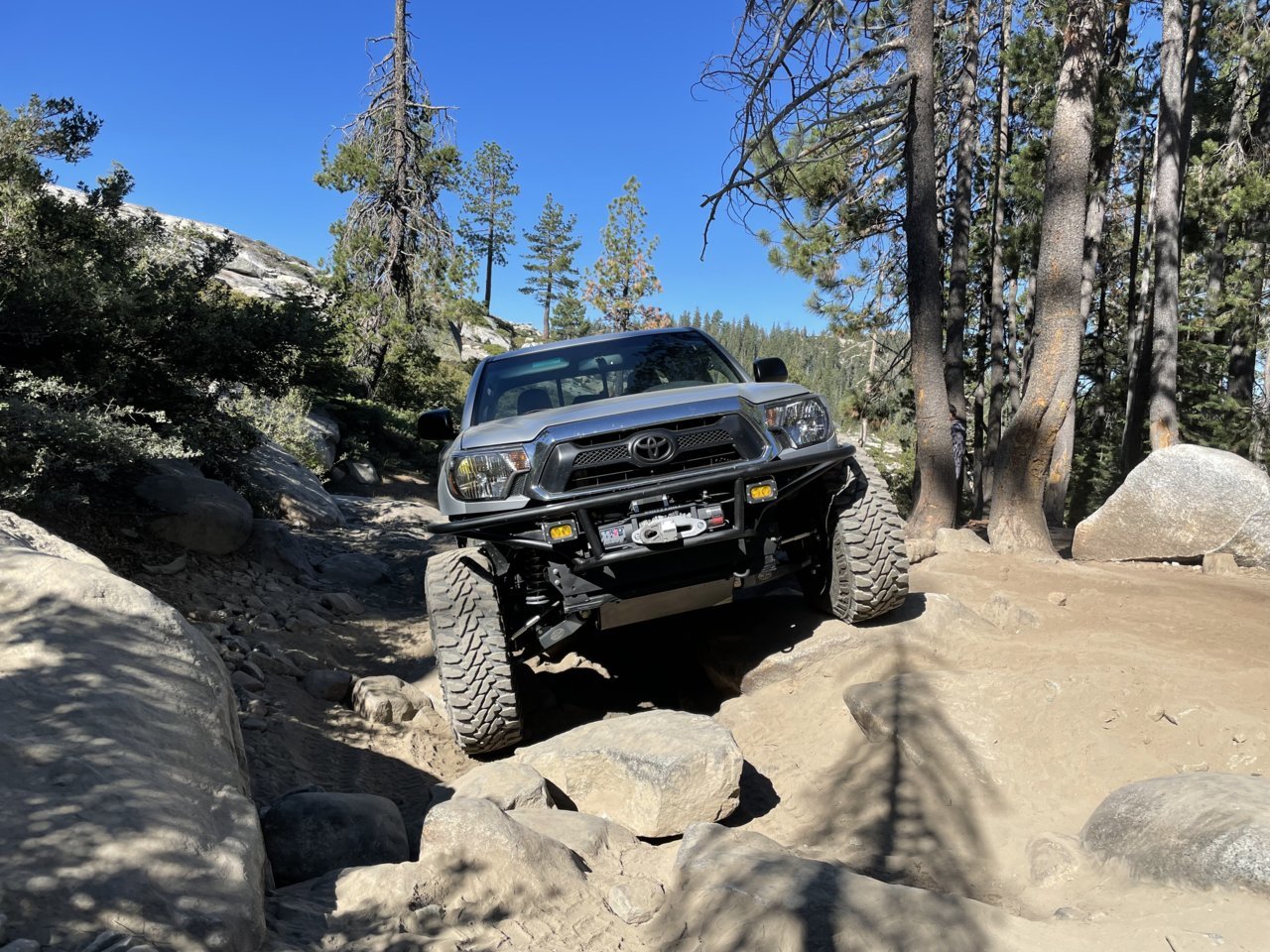

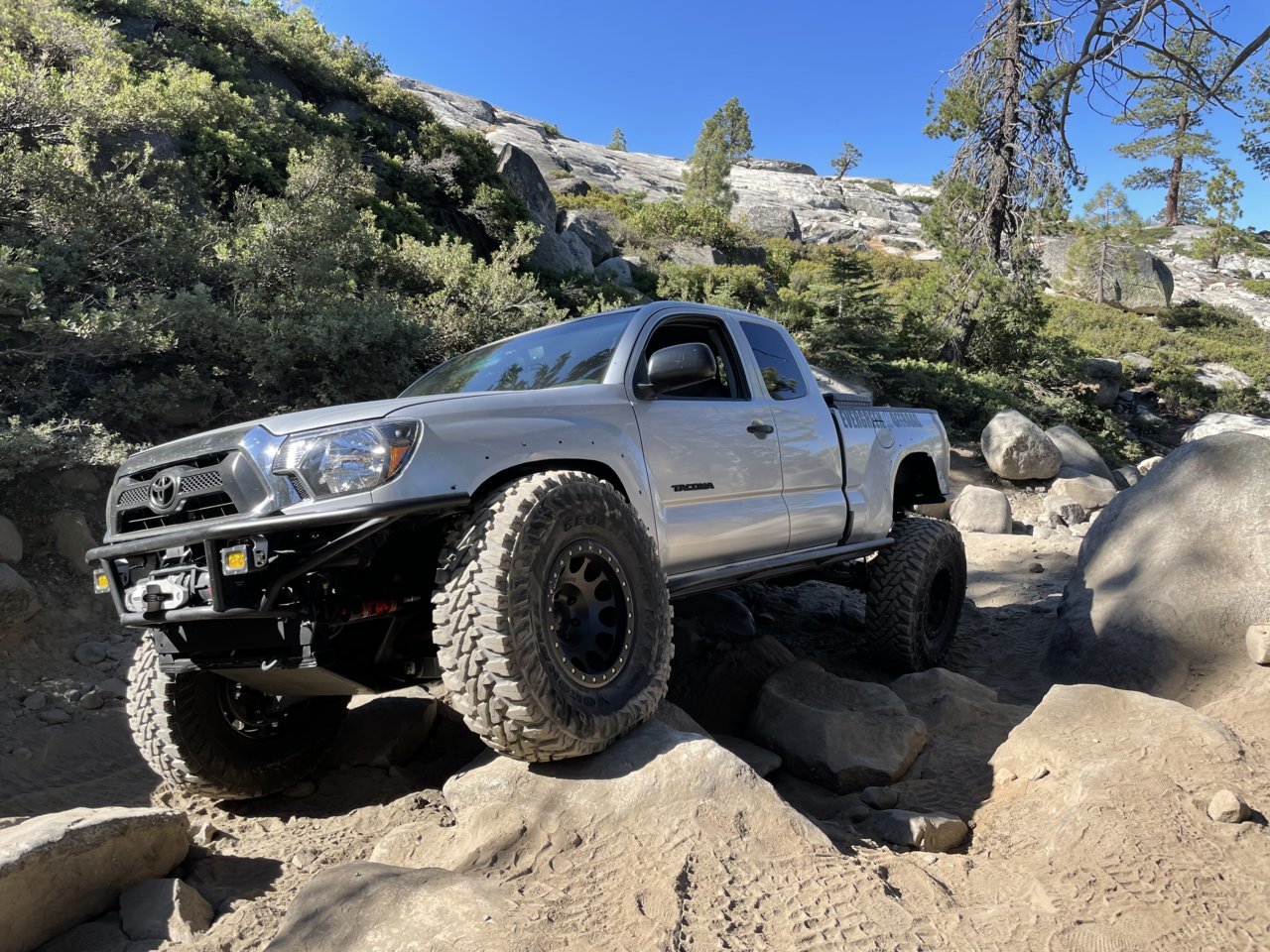

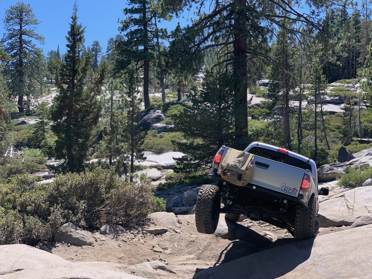

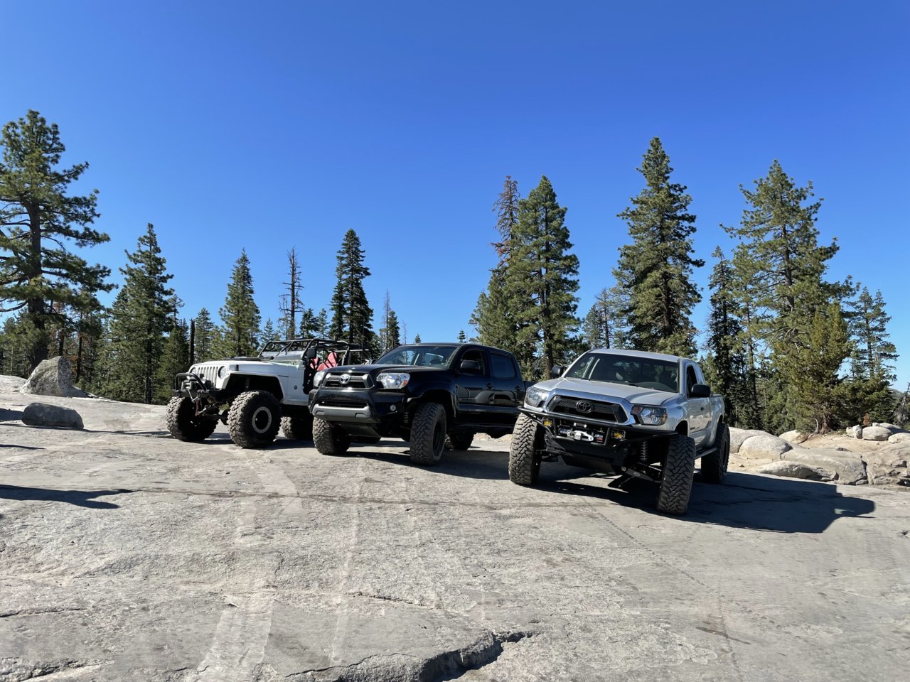

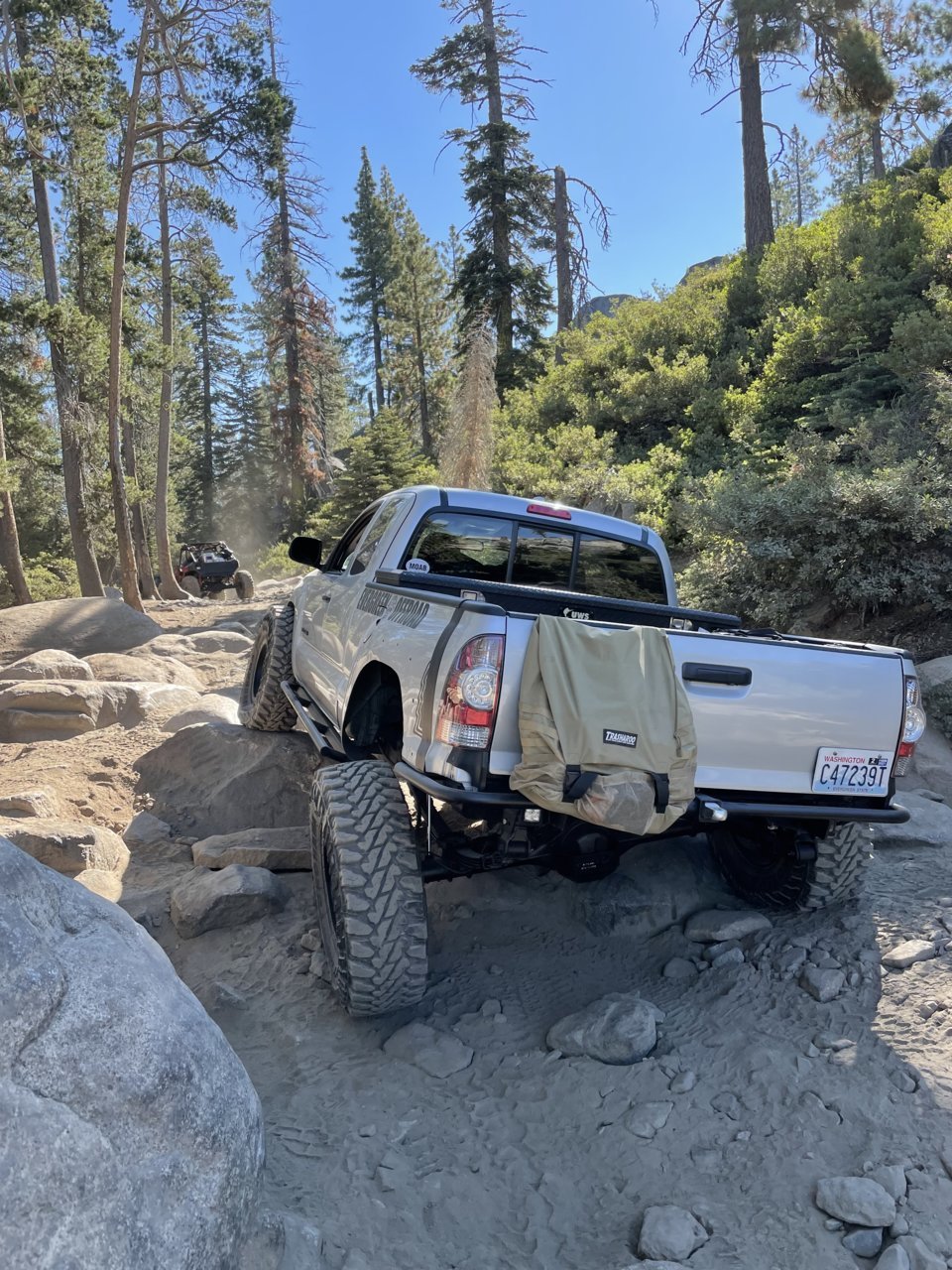

    Some random shots of the 2.25 kit at work on the Rubicon

    Hell yes! Now we're talking! How'd the setup do? 650lbs springs if I recall?

    Yup! 650s seemed just about perfect! Only issue was bottoming out after dropping off boulders, I think airbumps are in the near future for the front and rear... Also going to french some chevy 63s in the rear before Moab in a month.
