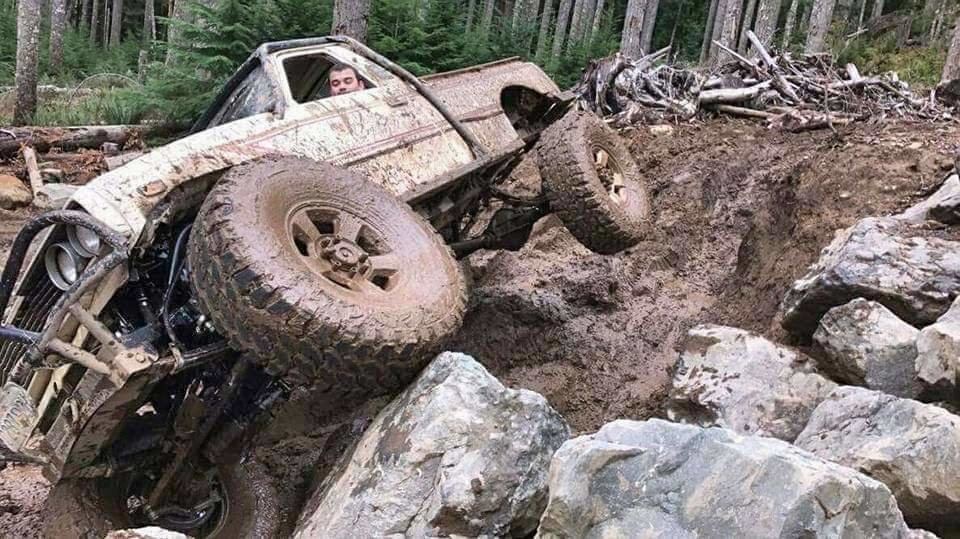

    Braeden
    BC
    Just yesterday i picked up a load of customer parts in the Tacoma. With an empty bed my 63 swap is pretty rough, even just around town, but with 7 sets of sliders in the back they ride really nice. Problem is that they are about 3" off the bumps.
    I'm sure with a bit more effort dialing them in you could get some more travel up and down with them, but they are definitely designed to carry weight. I'm running 3 leaves in mine.
    They flex well for wheeling, but they won't ever replace a proper long travel rear with better up travel numbers. I'd say they suited my mid travel front very well, but now with the long travel front, I am constantly finding their limits.

    63s work pretty well for being a $200 setup. With 3.5" shackles and 14" shocks, I would drop a 40" tire out of the wheel well and max out the shocks both compression/droop wise, doubted with tons to help the springs droop. Like said above, they are meant for a real truck, so they will ride like a real truck :thumbsup: Axle wrap was definitely a thing, as I snapped maybe 3 or 4 springs in 5 years of running 63s. Most run an overload, but with 3 leafs/no overload the ride was quite nice on my lighter crawler.
