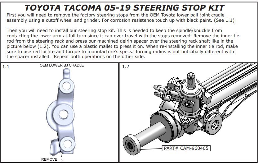

    Correct the rack deflects a lot without the slide rack. I’ve never contacted or seen anyone else contact the banjo bolt so this is the first I’ve heard. I also don’t run steering stops unless using a ram assist and then I have Howe set the box up with them internally. If you care about stops and don’t want to scratch your arms you can leave the OEM stops on and rivet thin rubber pads to the to prevent scratching.

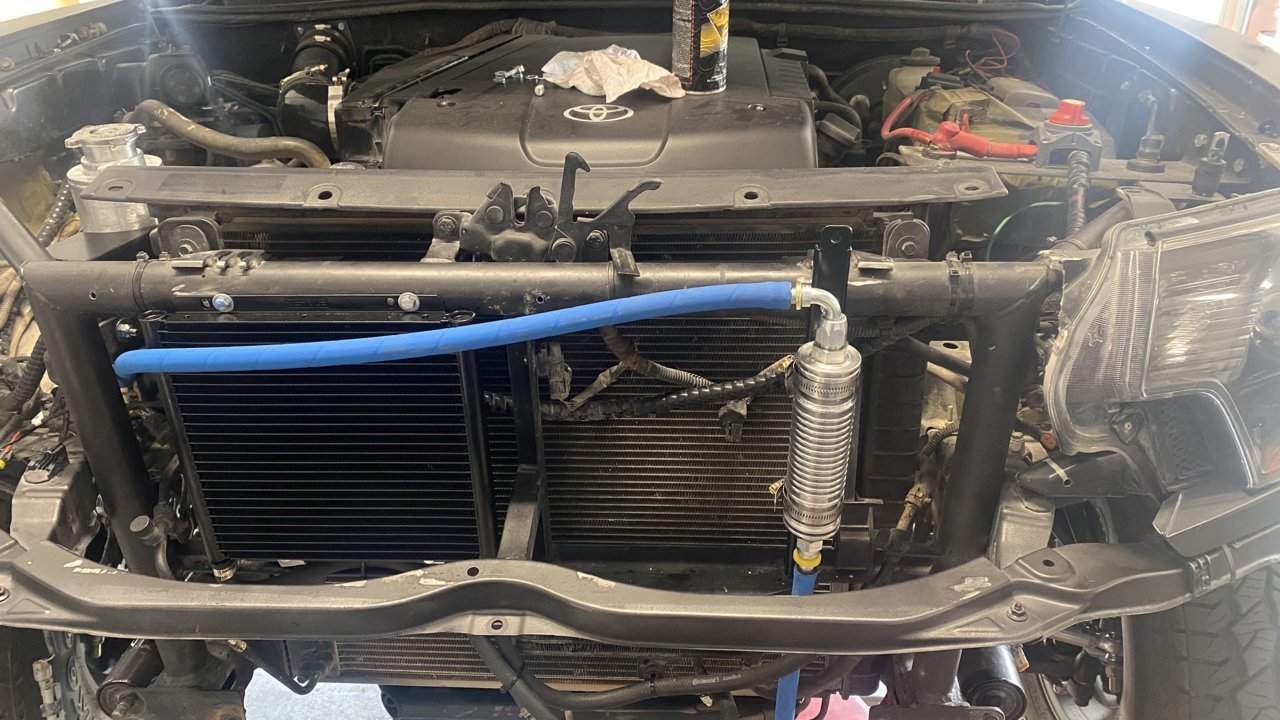

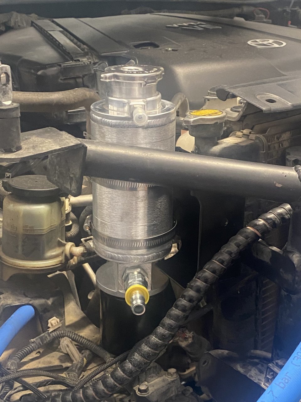

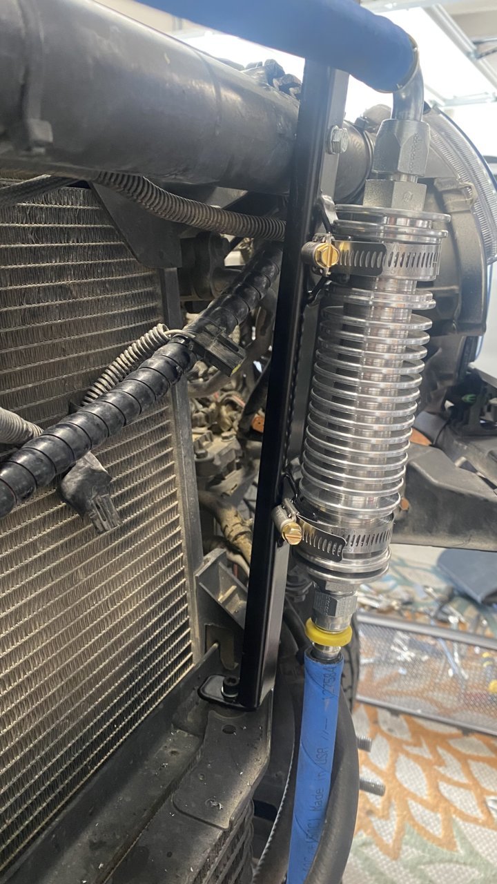

    Started the install of the Howe steering kit. Had to modify things since I dont have a core support that this is made to bolt up to. Cooler moved over to the left side since the aux tranny cooler in in the way on the right side. Could have made it work if I felt like making spacers....i didnt feel like it. Bent the lower part of the cooler bracket and just picked up an existing screw and the top just drilled and tapped the tube.
    The resi I bolted up to a bracket I made to mount the upper part of the radiator. Only had enough space for 1 bolt. So gonna weld it in place when i can get over to my welder buddies place. But its fine for the street for now. Will finish it all up tomorrow morning.

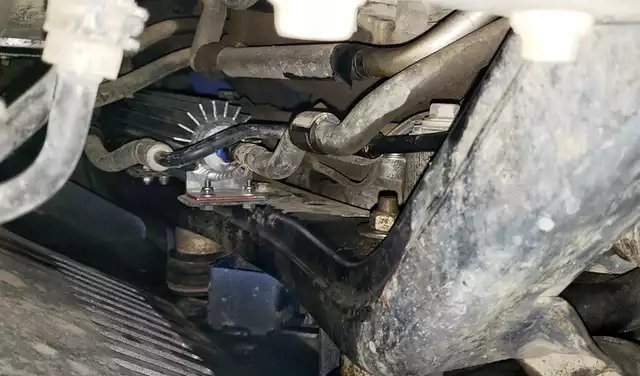

    @Airdog I would refrain from running lines too long. Howe recommends the most direct path if possible to minimize distortion/impeding flow efficiency.
    I was able to make a mount off the cross member in the flow path and allows you to keep your front real estate without mods. Just an idea.

    Looks like they no longer offer that product anymore, at least I couldn’t find it. That’s a nice solution.

    Easy enough to buy a chunk of delrin and have a local machine shop turn it.

    Sure, anything can be done with enough money and effort. I just don’t care that much now that I’ve solved the problem.

    I never cut off the steering stops. I didn't even know that was a thing until you guys posted about it! No instructions when I installed the kit. I'm running the stops on the front of the control arm like stock and haven't had any issues there other than they obviously chip up the PC, which isnt a problem considering what rocks do to them.

    It’s not uncommon for some reason from what I’ve seen with LT kits. I know the TC kit has you cut them off as well. Not too sure why though.

    Probably exactly like you say, so they don't get stuck under the arm. Hasn't been an issue for me yet though
