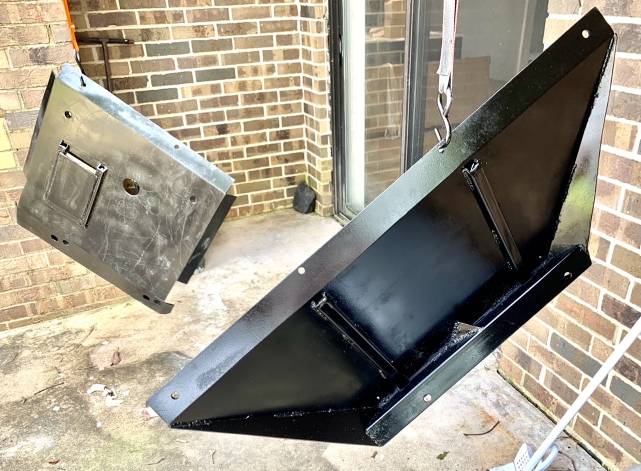

    was hoping to install some JD stuff, but tucking the front and making skids took all weekend. It ain’t pretty, but everything is as tucked up as I could possibly make it. I think that’s as slim as an ARB can get, too.
    Anxious to get started on the JD stuff next.

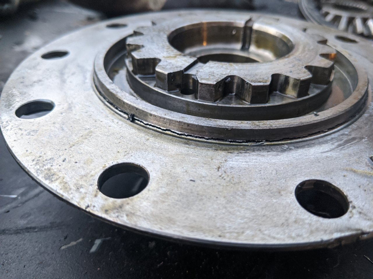

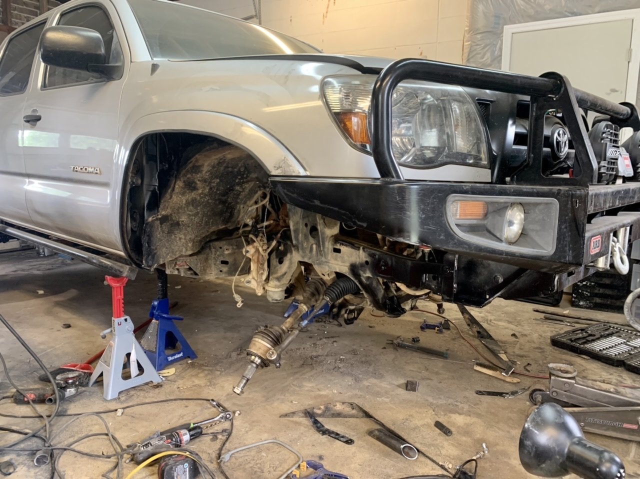

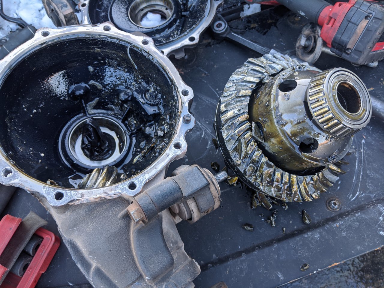

    May have been me, I'm the only person I know of that's broken a front arb carrier.

    I havent heard of many people blowing up the solid FJ ADD, and im not sure if it would be worth it to upgrade past that. You gotta have a weak point somewhere and i wouldnt want it to be my diff.

    The shock from the shaft breaking is likely what pushed his diff over the edge. That shock alone is likely what spiraled it all out of control. People need to stop thinking about “fuses”. They don’t exist. What breaks, breaks. The goal is to make it all strong.
    And personally, I kinda like having the ADD. It has its benefits. So if it can be made stronger, why not?

    Yes his probably broke from shock, but mine did not. I rarely bump anything and i try and be very smooth with my truck, yet i still blew up my front ADD. In a race application i would agree with you, build everything as strong as possible. But for a weekend warrior, its easier to replace a $200 ADD tube rather than a $2000 diff.
    I think @Tacoma1192 already looked into 300m shafts. Maybe talk to him if you really want to go that route. Theres also other issues with the stock ADD, the plastic teeth on the motor can break, are you going to upgrade those too?
