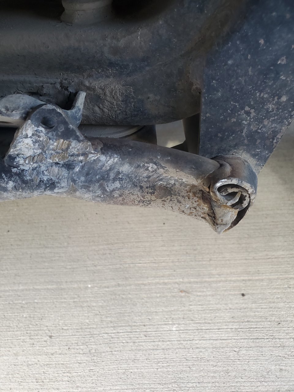

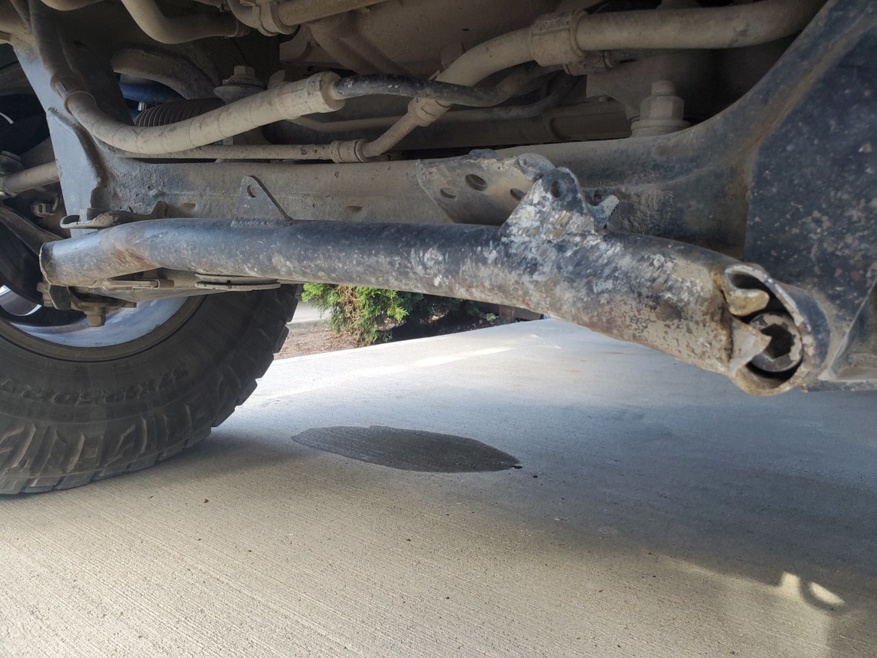

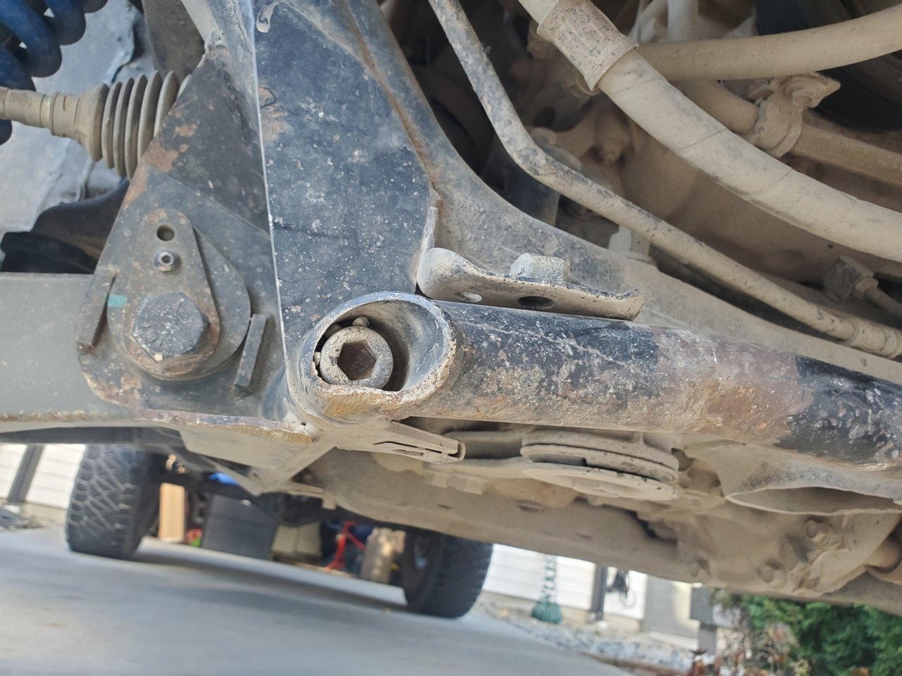

    Didn't see a cross ditch until last second yesterday. Braked as much as I could but still hit it doing at least 45km/h. I didn't have the skid on cuz I still don't have a front axle and this was supposed to be a mellow camp trip.
    I completely crushed that lower cross bar. And launched a couple water melon sized rocks a good 50'. But other than that, no damage to the long travel kit, or pivot kit. Truck still drove perfectly straight when I got back to pavement. Pretty blown away considering how hard I hit that thing.
    Very thankful @81Trekker sent me a replacement bar and I haven't swapped it yet! Really need to build that front skid and a new bumper! Putting all this stuff through its paces anyway, and not dissapointed at all.

    Definitely saved the rest. Should be an easy enough fix for you at your shop.
    Testament to the strength of that 81Trekker kit. :thumbsup:

    I’m stoked to see that thing all smashed and mangled... you’re really putting it to the test!
    The nice part about the removable cross bar is in the event that yours ends up like this just give me a call and I can send you a new one... way better than destroying the OE crossmember!
