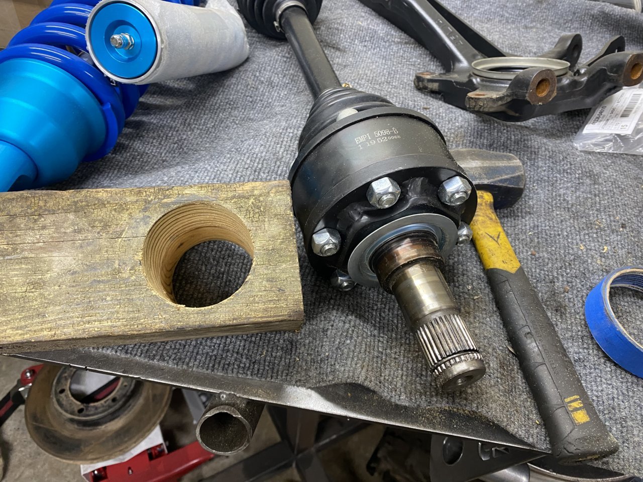

    That's what I did. I bought new ones actually. I bought two OEM boot kits so I could have OEM outer boots and while I was at it, bought new dust shields too. The p/n is 4133604010 for the dust shield and 0442804010 for an OEM boot kit. Qty. 1 is enough to service one axle, inner and outer joints. So I bought qty. 2 and sold off the inner boots/grease/clamps for someone who wanted to just reboot their torn inner.
    I used a 2.5" hole saw to cut a hole in a 4x4 and used that to evenly tap the dust shield on. I had to apply uniform pressure, hence the need for a 4x4. Just trying to tap it on with a punch wasn't working.

    When you put the dust shields on, maybe add some blue locktite or something? One of mine came loose from its little pressed-in home and gnawed on my seal a little bit making it leak a tad now

    If it’s loose, it’s time for a new seal and dust shield. From messing with the dust shields on my old OEM CVs, there’s no way it should have come loose. They were a pain to get on and off.
