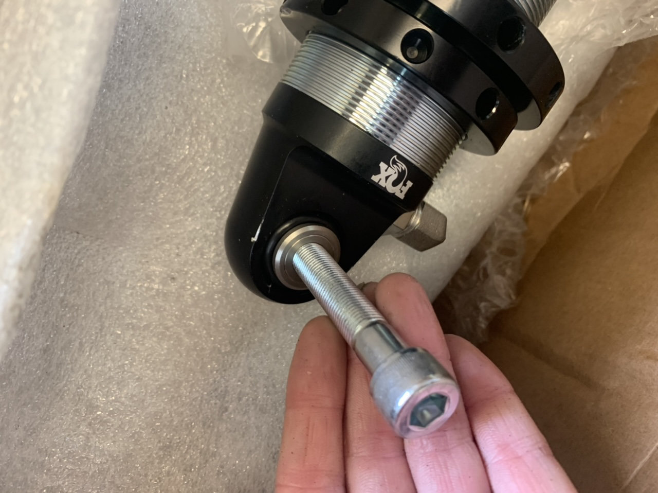

    @81Trekker can I tap these to fit? Fox are a tad small62B89ACD-6278-4B1E-8243-B36F00A7AAFC.jpg
    ID of the misalignment spacer is 0.473”

    You could try an M12 bolt, which are 0.472”
    Dayman Karate[QUOTED] likes this.

    You can however I just received a call from Fox that they sent the wrong mis alignments. New ones will be sent to you right away

    Good deal, I started reaming these out so I can get started mocking everything up. I’ll throw the replacements in when they arrive.

    I just had Fox drop off a big of the correct spacers, keep me posted and I can send some out to you right away

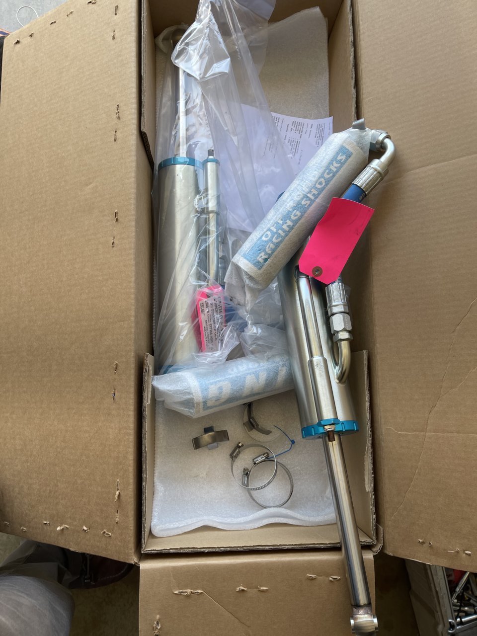

    Front suspension: Work in progress JD Fab +4 LT, LCA pivot kit, steering slide rack, 934CVs Rear suspension: Archive Garage shock relocation and SUA Conversion,King 14x2.5 shocks, King 2x2 hydro bumps, FN wheels 5 stars, sliders
    Look what’s fresh from King and JD today.
    Bump/strap install coming next then a bumper. Then we can party.

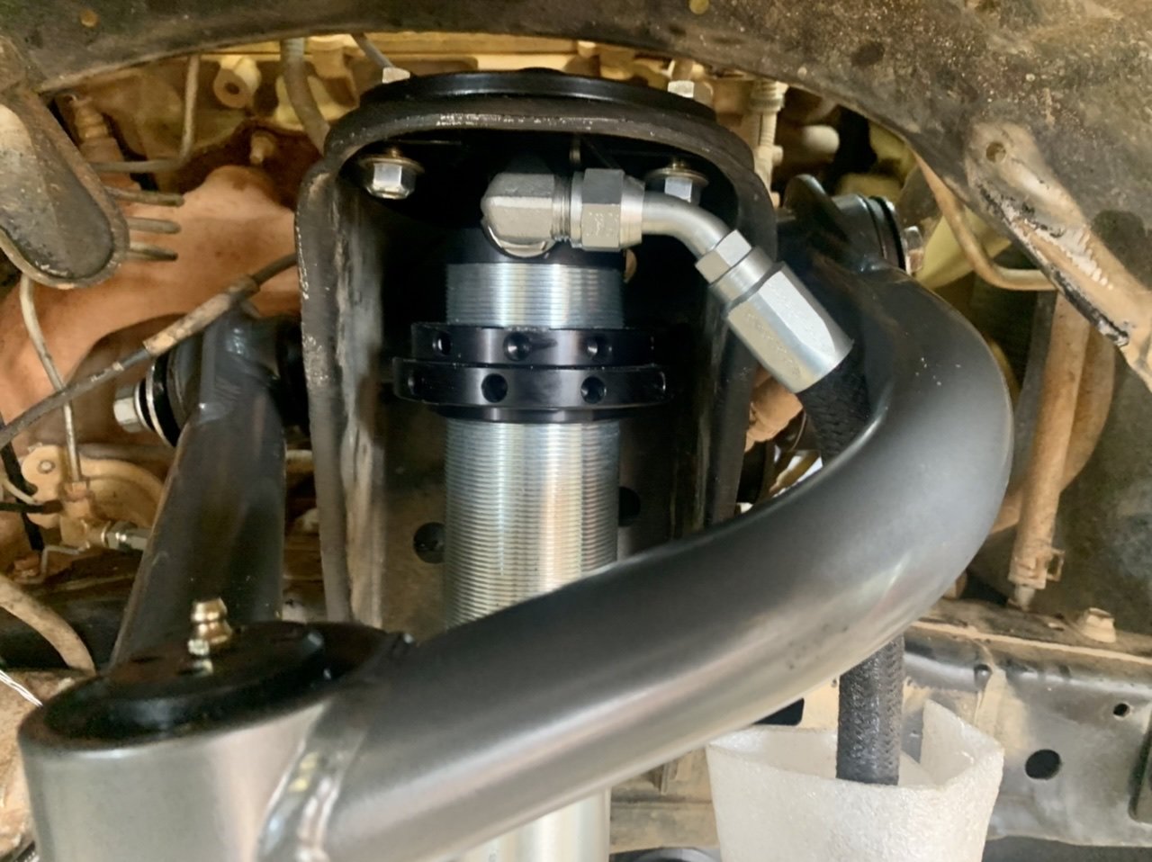

    https://www.tacomaworld.com/threads/daymans-karate-class-but-you-wont-learn-nothin-4-link-lt-and-previous-iterations.755134/
    this is without the misalignment spacers, but I don’t see how this hose isn’t going to get worn through pretty quickly. Am I missing something? Can I give the fitting a little twist if it’s still like this buttoned up properly?
