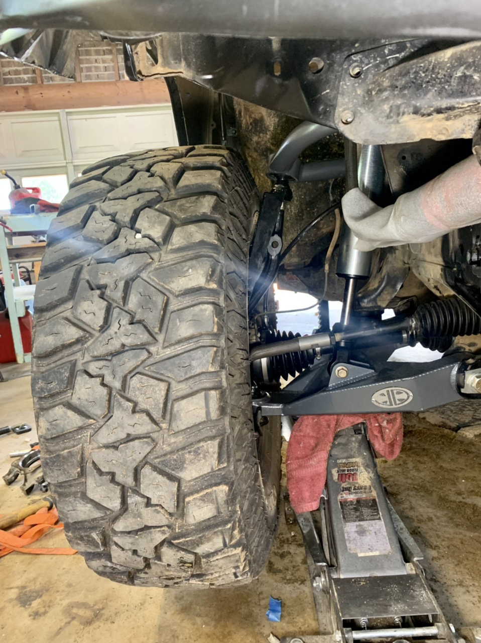

    getting everything cycled and strapped while I wait on the misalignment spacers. Can confirm 4.5” backspacing is the absolute closest you can get.

    35’s. But I’m surprised how much more room I have in the wheel well with less offset and the lower arm pushed forward from the JD kit. I need to clear a bit more up front for hard hits since I’ve only got about half an inch stuffed sitting still.

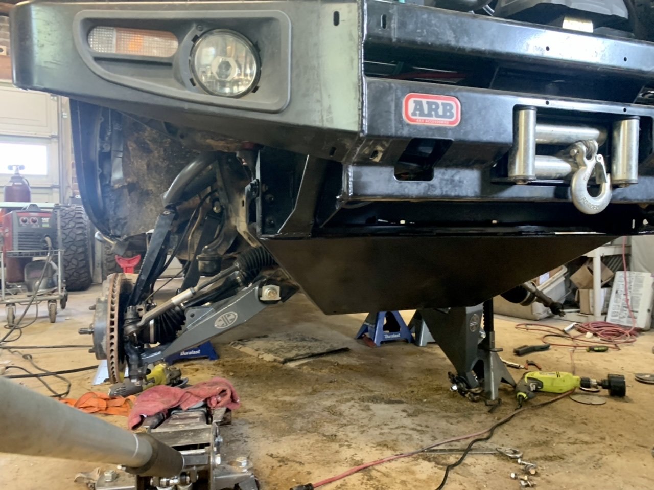

    Well, I managed to bend another banjo bolt even with my fix. I have a few spares now so an easy 5 min fix. Going to shave away the secondary shock mount tab this go around. Maybe buy some new steering stops or something.

    I left mine on and meant to take a closer look full lock at droop to see if anything would bind. I’ll do it for the other side. It’s close just looking at it, but I think the very top will stop it. Everything was good otherwise. Maybe you can find replacements?

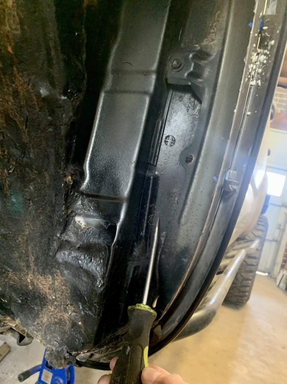

    If you can name that part, please name this small plastic trim that fits in between the door where it closes haha I need one for the passenger side badly since I took out the sheet metal liners I made.
