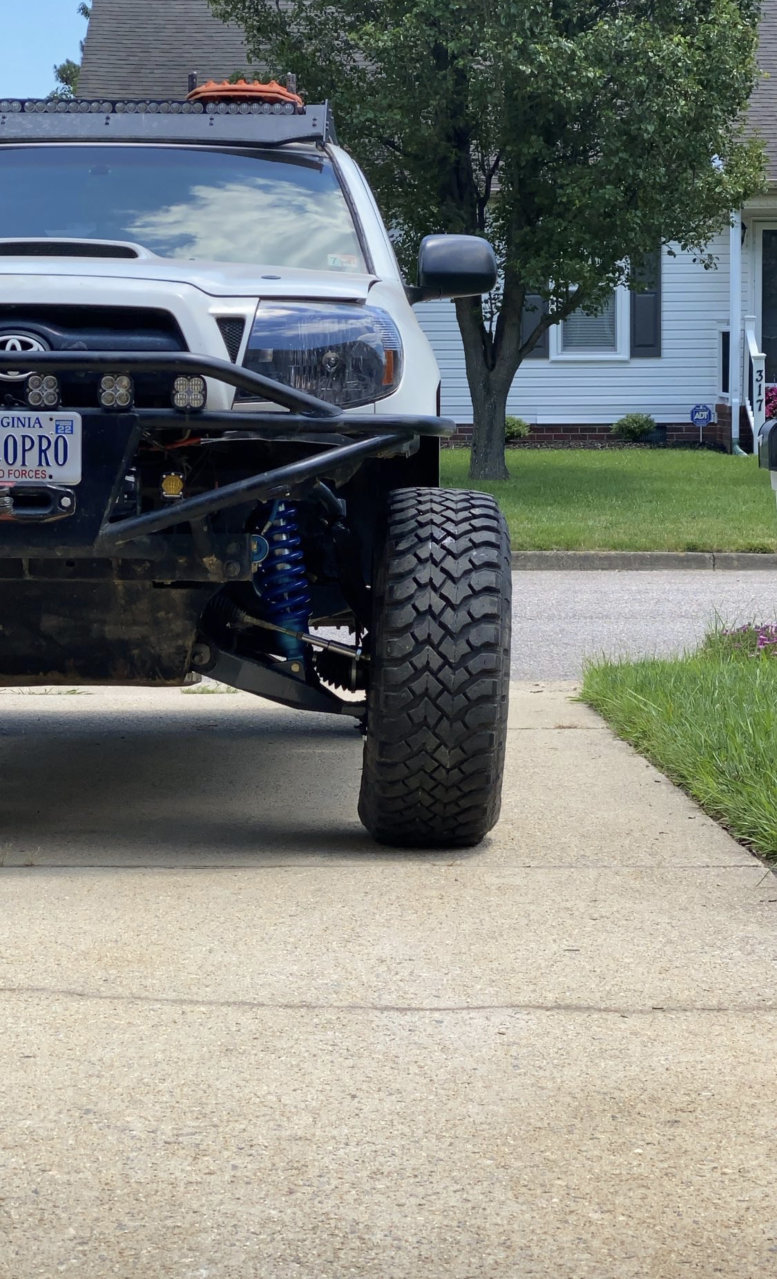

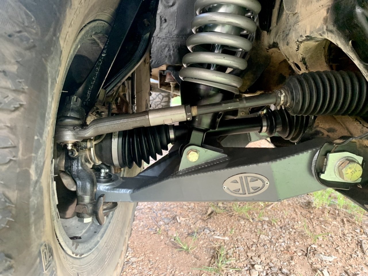

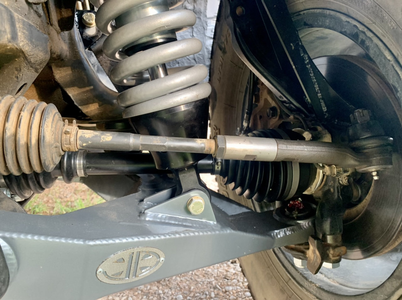

    For the toe I’m seeing I doubt any range the alignment tabs offer would correct it.

    bro you can’t change kits and re use your previous alignment settings every aftermarket kit has different geometry to improve the geometry and correct oe issues you need an alignment but don’t do it until you swap out your coils

    Right but it also looks like you're way cambered in. Camber affects toe so if camber is way out you'll never get toe right. The order of operations for an alignment because of affecting the other measurements is camber, caster, toe. Get the 1st 2 correc then adjust toe because they will make changes to toe

    toe is not an isolated adjustment it is greatly impacted by camber and caster, that is why alignments are complicated you can’t just tweak one thing without affecting others

    Looks like you have plenty of threads to toe it in. Get a buddy and a measuring tape and try and get about 1/8in toe in.
    I havent paid for an alignment for years. You can get it close enough with a measuring tape.

    I didn’t. My camber is close to zero or very slightly negative. I don’t see any range the alignment tabs could offer to bring the tie rods in as much as they need unless I’m missing something

    They are threaded all the way into the extension minus a quarter turn

    Sounds like your inner tie rods are too long then. Probably an issue with using not oem parts. Leave the nut on and cut off about whats showing, then screw the nut off. Then reassemble.

    I have moog now but I kept my OEM inners and outers so I’ll compare them

    I think the camber and castor is almost dead on, I’m just out of toe-in adjustment for some reason. Could be the moog are too long, but I’ll compare with OEM this afternoon

    I agree, but we are talking big picture numbers right now not single degrees and 1/8”s. I could go to the extremes of the alignment tabs in any combination you could imagine but there’s no way it’ll bring the toe in an extra 1-2” that it needs. I’ve never seen toe out this bad and not had any room to bring it in. Pictures aren’t accurate in these scenarios but here’s dead on.
