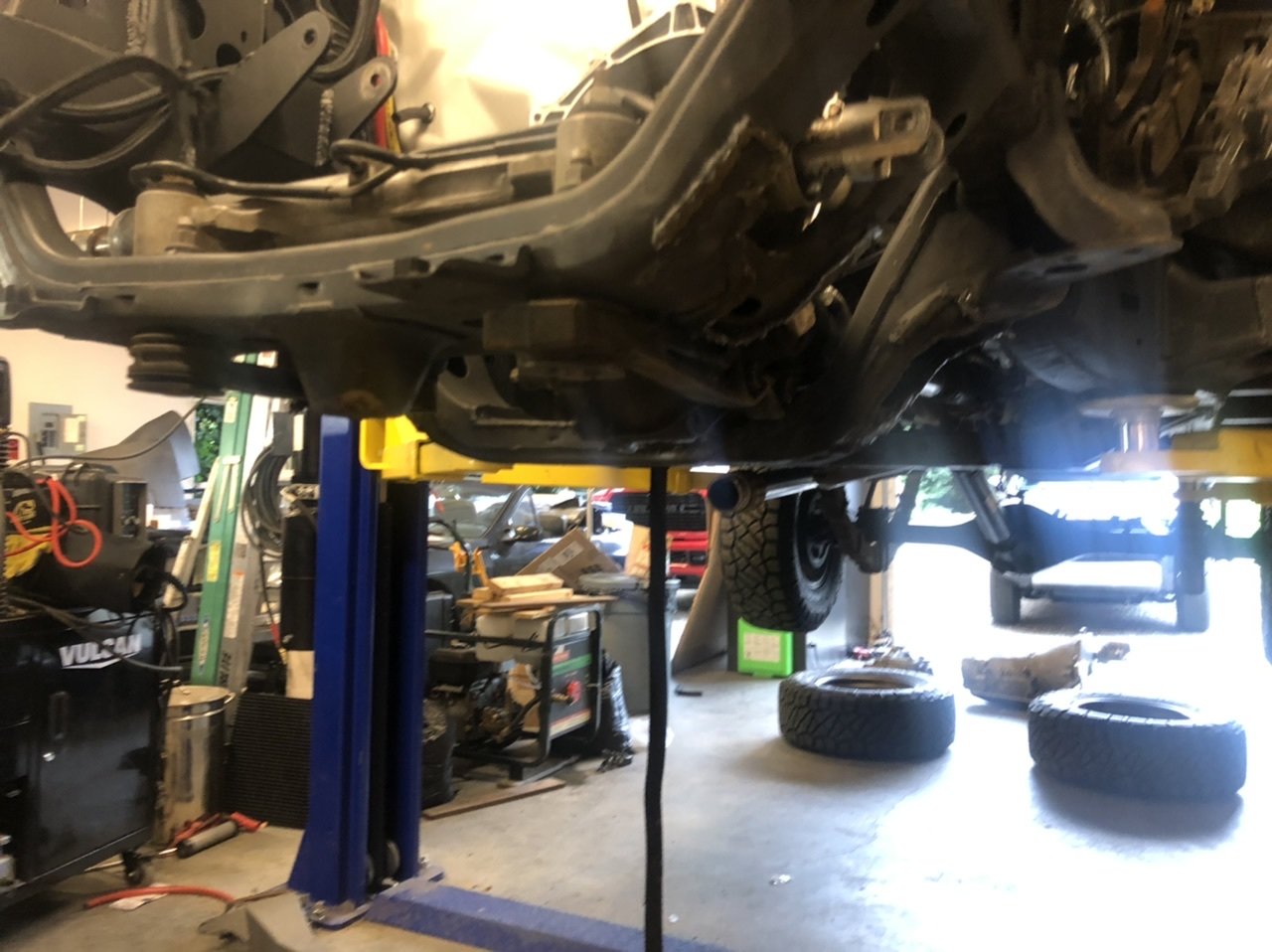

    plasma cut the mounts off, now just need to get it all cleaned up.

    Also now I see why @81Trekker says two day install…cleaning up the frame is a bitch.

    Day one is just removal and clean up haha.

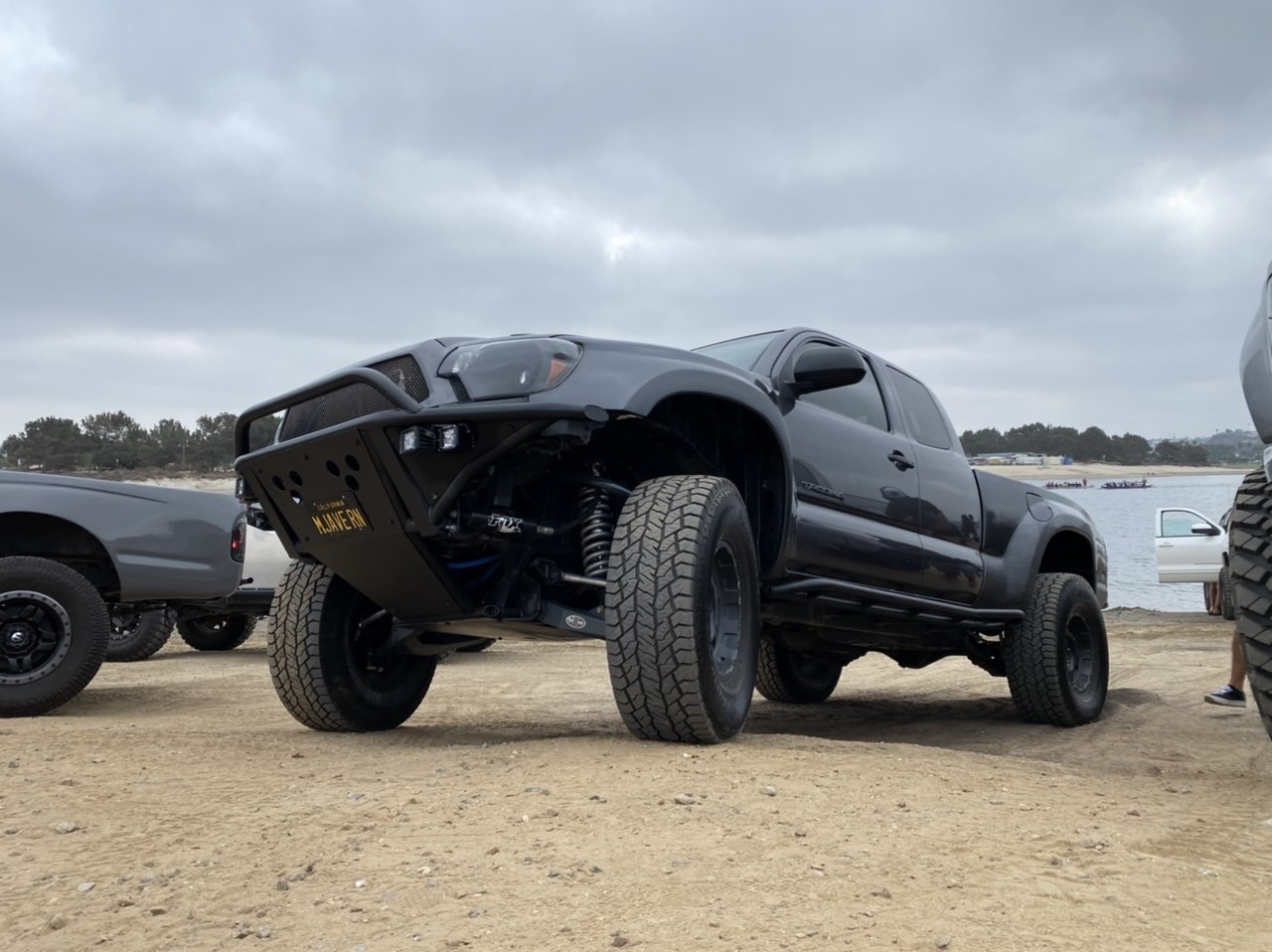

    Feel like I’m the only one reppin JDfab at Fiesta Island today Huge prerunner meet here today F877AD8C-EC76-4261-99F3-CA2A627B7E50.jpg

    This is the worst part of it all. Well the grinder boogers you’ll have the next day are

    so start Friday night is what you are saying haha
