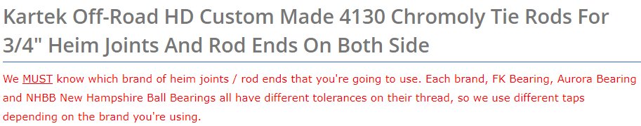

    Cool, good to know. I was only asking because Kartek needs to know for heimed tie rods.

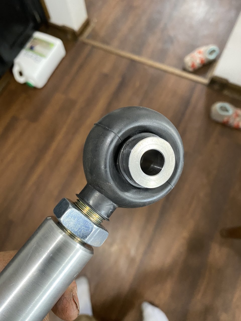

    Here’s what they look like. Cliff notes, they suck to put on. You’ll have some sore fingers.

    I put them on dry. Once I was done I slid my needle greaser in along the misalignments and pumped some in.
