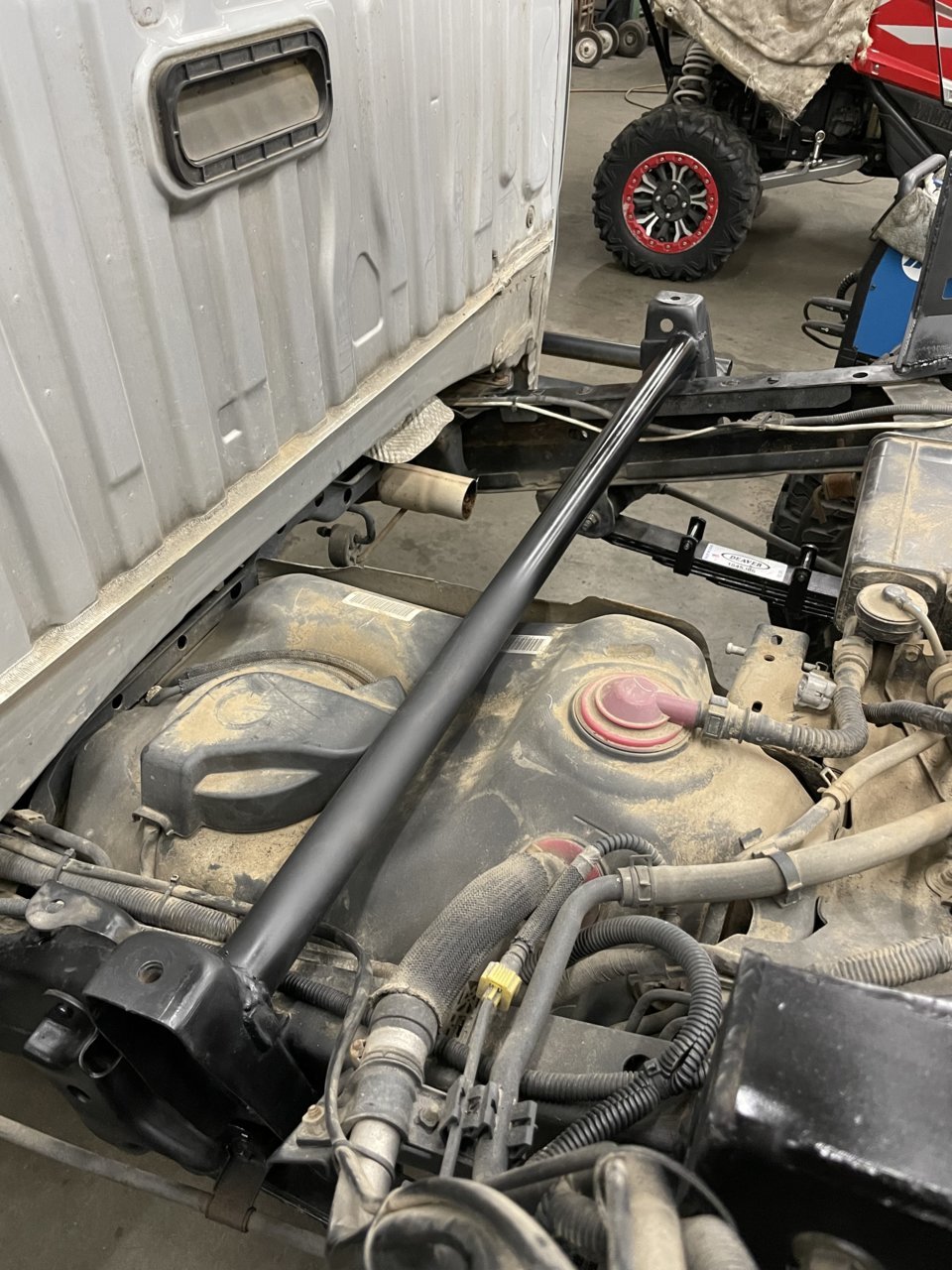

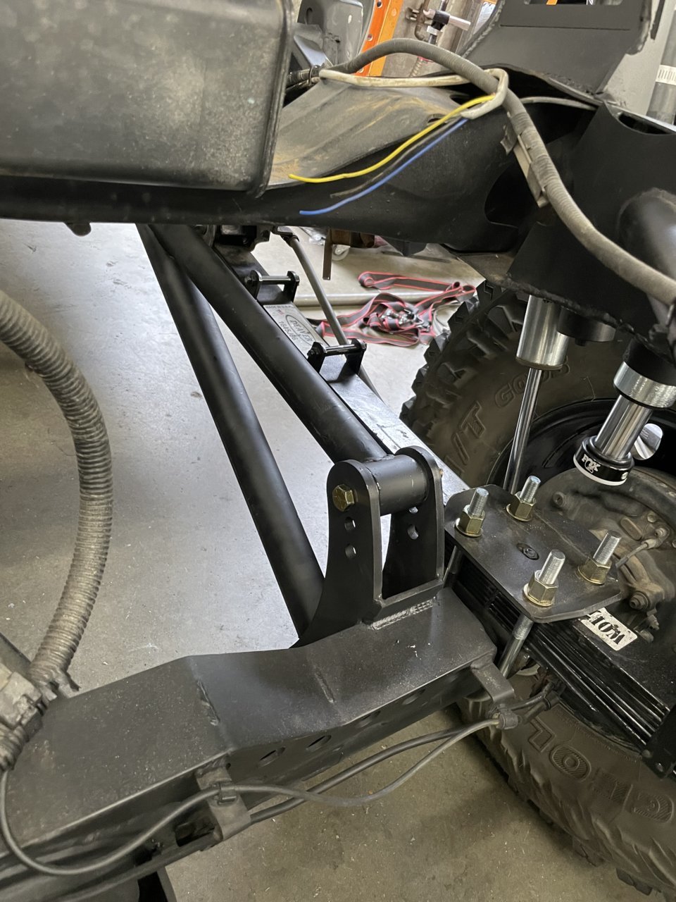

    Beefed up frame and added some air bumps, tired of this frame moving around like its getting paid to.
    65101451992__EC520A19-E6AF-4B6F-BD18-911FD1C35A86.jpg IMG_1304.jpg IMG_1322.jpg IMG_1324.jpg

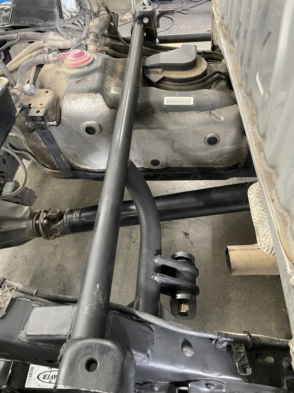

    And testing out an anti wrap bar..

    does that clear the gas tank cross member at full bump ? that looks an awful lot like the position of my 3rd member and I have to cut out that cross member basically a full pass through C notch

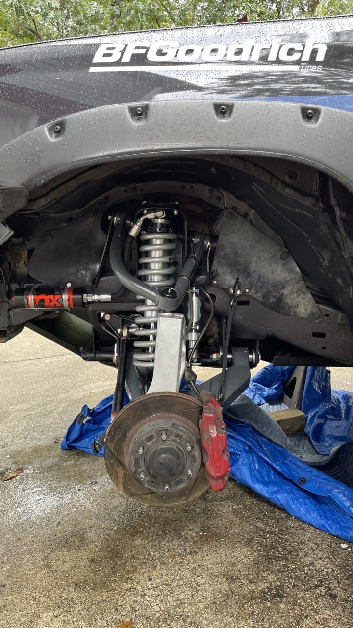

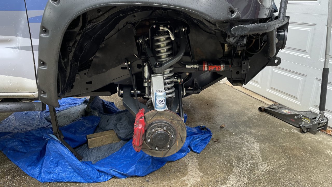

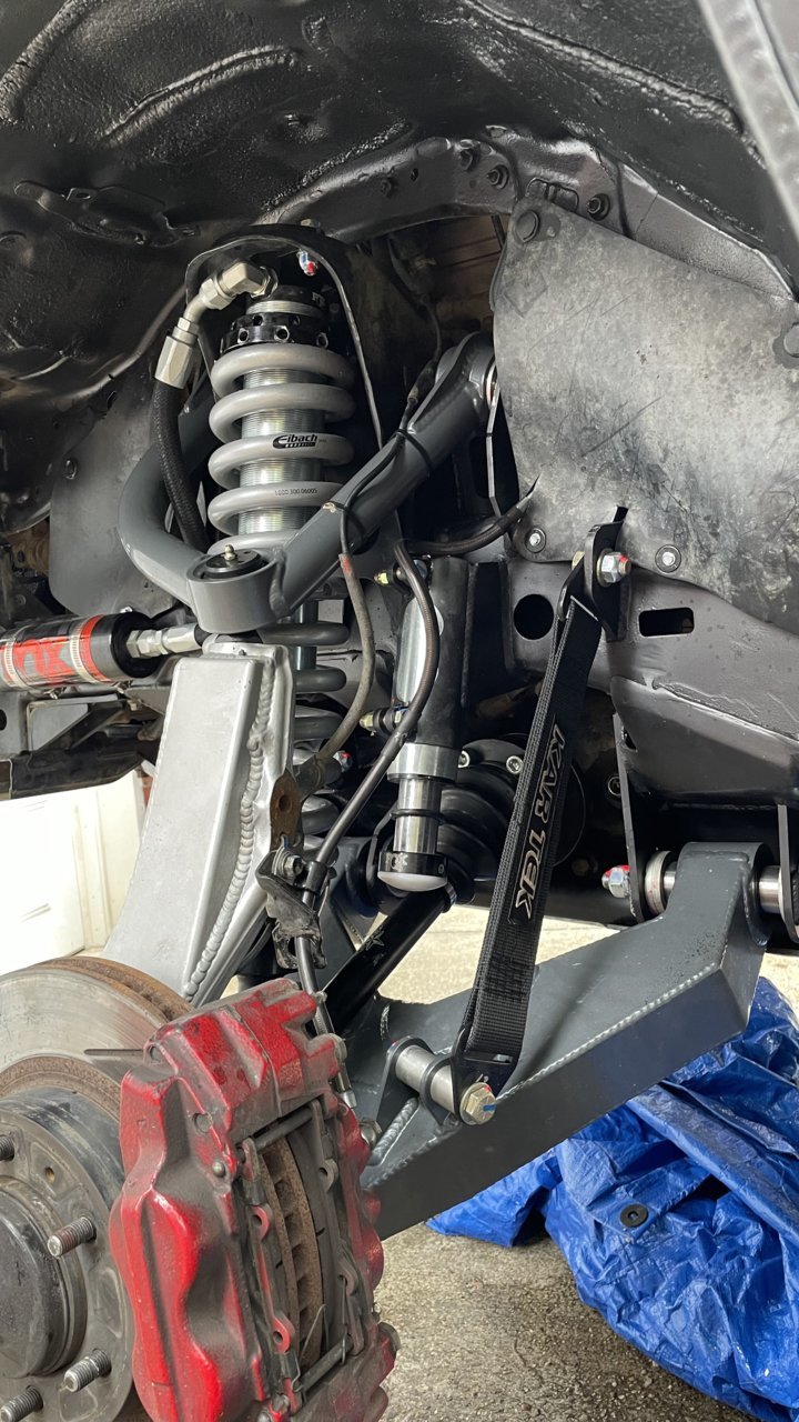

    So….I think it’s pretty dialed in minus a few small tweaks.
    1.) I need to limit up travel by adjusting the bump down a hair until the inner fenders arrive.
    2.) The alignment isn’t PERFECT yet the guy did a pretty decent job but he didn’t want to hear any advice from me and struggled for a solid hour before he finally let me back in the shop to show him around the kit. Because he told me at first that I “had a problem with upper and I needed a set of SPC’s to adjust the caster to 4 degree’s”. Long story short I have .3 positive camber on one side and .3 negative on the other which makes the keys look weird and the whole alignment is leaned to the passenger side.
    The ride is Fantastic!. I’ve got a warn zeon 10 S winch and steel tranny and transfer case skids.
    mother than the need to limit up travel it all clears and functions as it should… we’ll really as it should have been done from the first place! Hitting curbs at the mall is no longer an issue!
