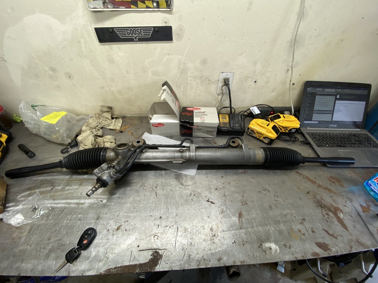

    2 super old school ideas :
    1. self made leather boot
    2. stretch a section bicycle inner tube over the clevis to the rack
    who cares if it pinches it will still keep 99% of the crap out and if it is a cheap disposable solution that you can replace by just removing your tie rod….

    I would rather use a cut up shock boot. I'd be worried a bike inner tube would get pulled into the rack and cause more issues.

    Sounds like the tundra rack would have been a much better solution for you.

    yup good point the inner tube might be too flexible and get caught on the teeth, do you think a shock boot could be stretched around the OD of the clevis ?

    wouldn't he still have the same problems trying to boot that too ?

    I was thinking tundra rack with no slide rack then you could use boots and eliminate the problem for the shit he drives in.

    100% correct. I'm drawing this from circle track racing. Hydro assist/full hydro racks are common place there. I'm not sure that tapping or splitting off the stock rack would work on the OE rack for an asssist ram. So I was thinking using a pass through orbital/servo to direct the fluid to the ram would work. It's the same as an orbital for full hydro except the steering shaft goes all the way through it to the rack so you still have mechanical linkage. Now you can get different sized valving and different steering shafts to tune the feel of the steering with them.

    You can boot a tundra rack like normal

    Hm, i learn something new everyday, never knew a orbital like that existed. I came across some circle track stuff when researching full hydro, lots of useful information out there from those guys.
    I think if you pressure and flow tested the outputs of the stock rack you would be able to determine if you could run the ram off it or if you would need something like a pass through orbital.
