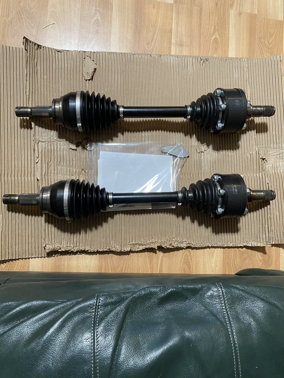

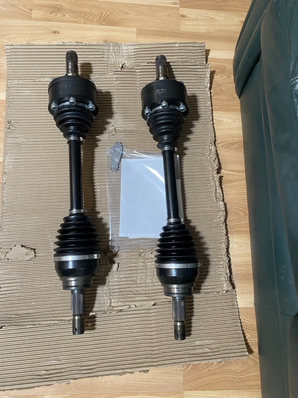

    These puppies (see what I did there) came in today. They have some nice plunge. I'm just waiting on shocks to come in now.
    954AB45A-A41B-40A2-A68C-A8E28E55C458.jpg 0184E5FA-47FA-4E92-99E4-580829069807.jpg

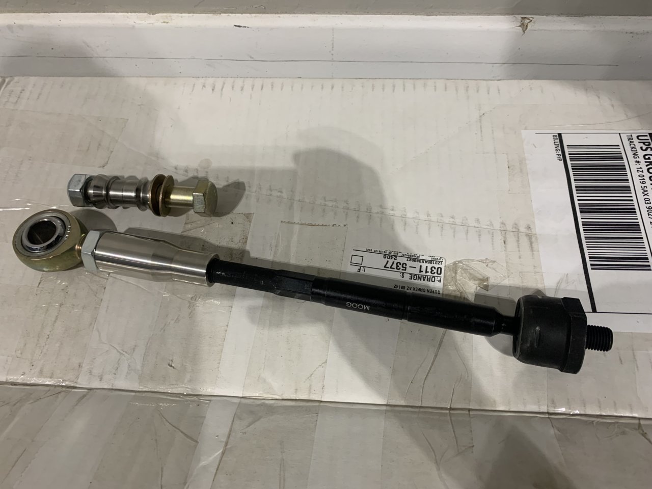

    You had “0” of these in stock and yet you got me a double shear kit within like 5 days of ordering. Thanks @81Trekker ! Dude this is so rad that it threads right onto my MOOG inner tie rods. Ideally I won’t be running these stock inners for an extended period of time but it will be a solid rack setup with my tundra rack for the time being. Love this double shear kit you offer.

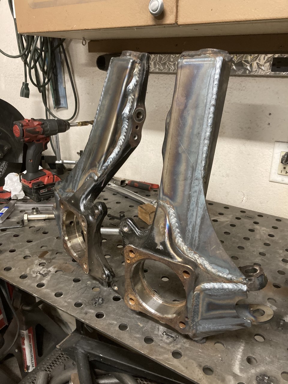

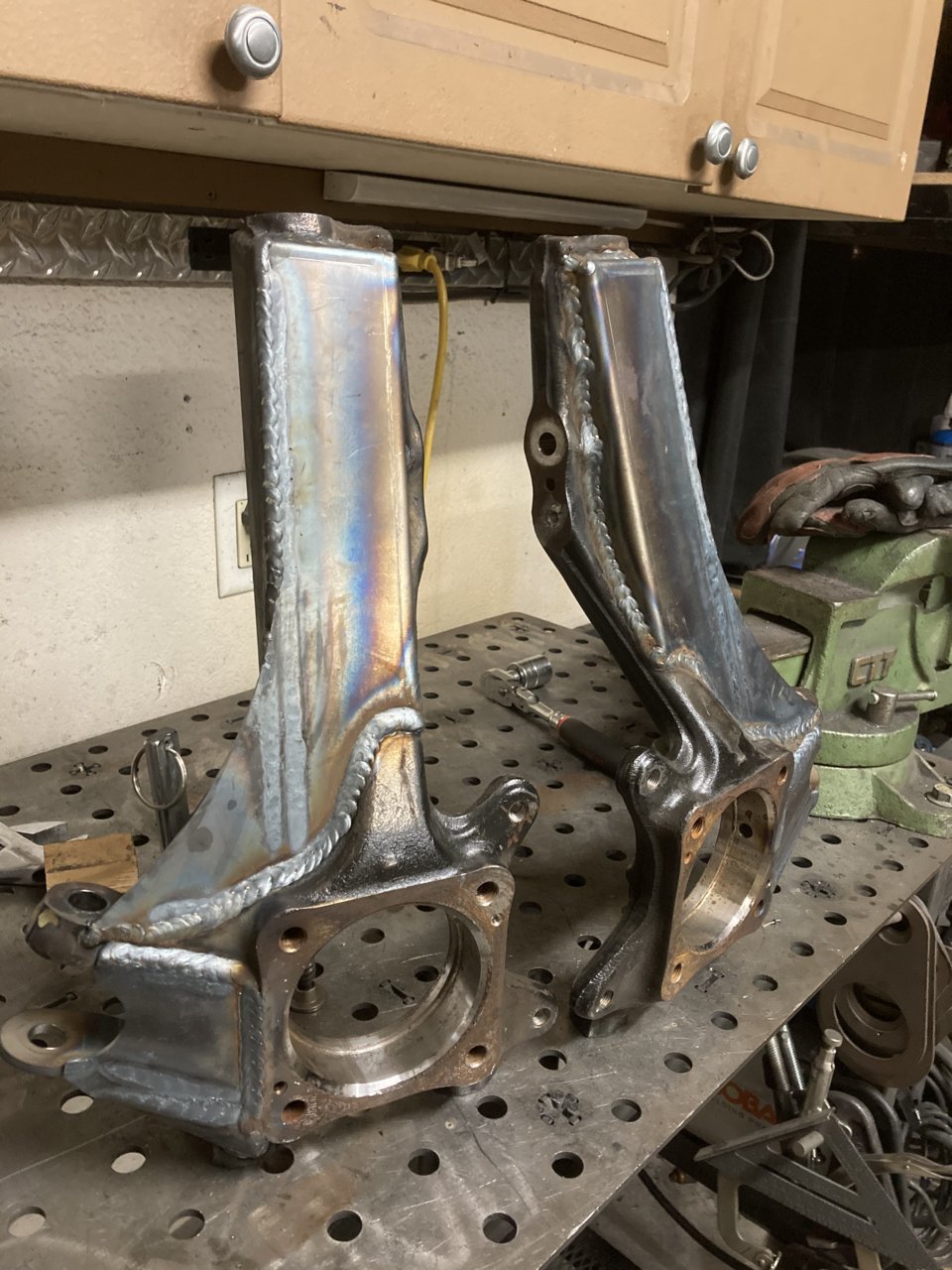

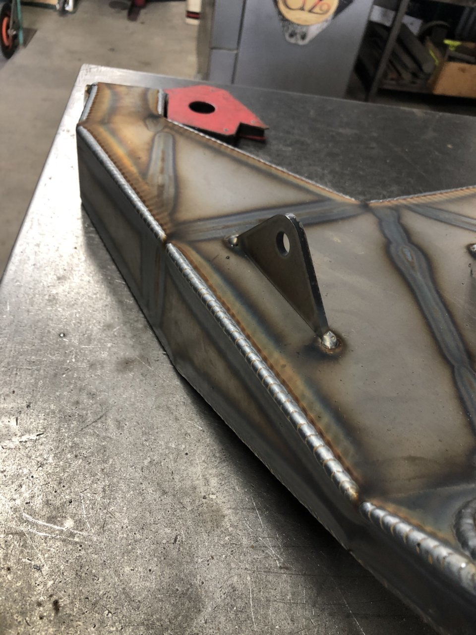

    Absolute worst fitting, worst design, total crap spindle gussets on the market. Said probably no one ever. Definitely not me lol.
    Went to the bank for some dimes on these ones
    :welder:
    80F73F8A-1C8E-406C-9451-F8D86393DEF3.jpg 43717673-630A-4D3F-B4CB-537E2D5607AE.jpg

    Turn the heat down on the open corners, the heat signature is the dead give away it’s too hot

    Thanks for the tip. I’m guilty of being lazy and not messing with my settings as much as I should when the situations change. I basically have some 0.030” wire and 0.023” wire settings and rarely deviate from them unless it’s a special circumstance. They just seem to work but I can agree that I definitely put more heat than needed at times like you noticed

    I use 030 for pretty much everything and using the different settings makes a world of difference. Below is a pic of 1/4” I was doing with the same 030 I use to build 1/8” arms... so stop being lazy :)

    Yeah I use 030 for basically everything but sheet metal. Like you said, just need to stop being lazy about settings when switching between material thicknesses instead of just varying travel speed between 1/8 and 1/4

    what are you looking at that makes you say that?
  14. Aug 27, 2021 at 6:42 AM
    #8534
    EatSleepTacos
    Mar 24, 2015
    #151688
    59,844
    Randy
    West Valley, AZ
    2017 4Runner

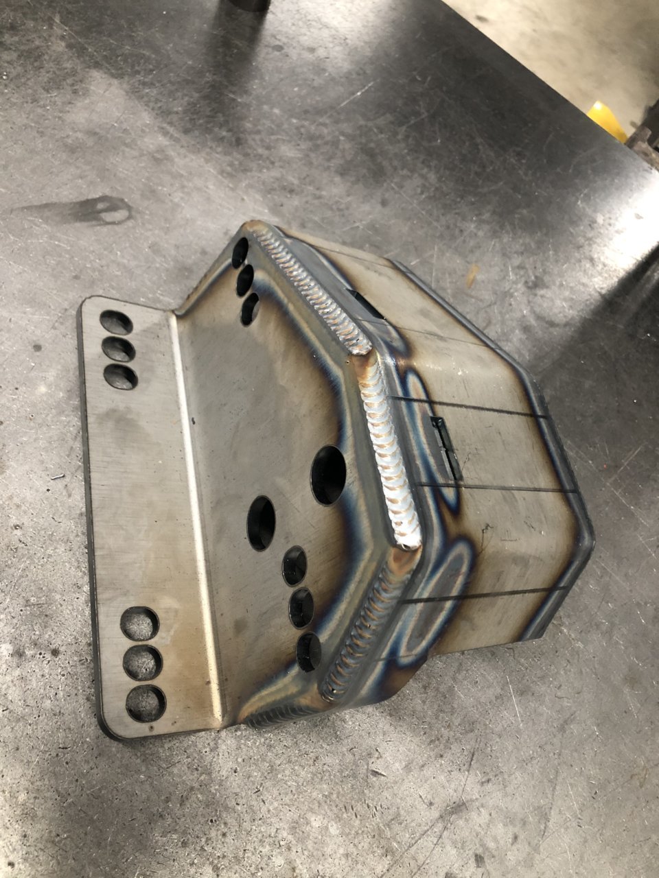

    Pretty sure this is what he means by heat signature, and how far it extends from the weld.
    Becuase he's talking about this weld, it's an open corner.
  15. Aug 27, 2021 at 6:52 AM
    #8535
    81Trekker
    81Trekker [OP] Well-Known Member
    Aug 25, 2019
    #303299
    3,750
    La Jolla SD
    81 Trekker and 2015 CCSB Tacoma
    Too many to remember
    Correct...look at the pics I just posted and the heat signatures on them. The other dead give away is how gray the weld is. Gray color means it’s too hot. Different temperatures produce different colors. Cold welds start with chrome colors, then gold, then purple/blue and finally gray is the hottest. This is very evident when tig welding but can also be seen in the HAZ (heat effected zone) when mig welding.
