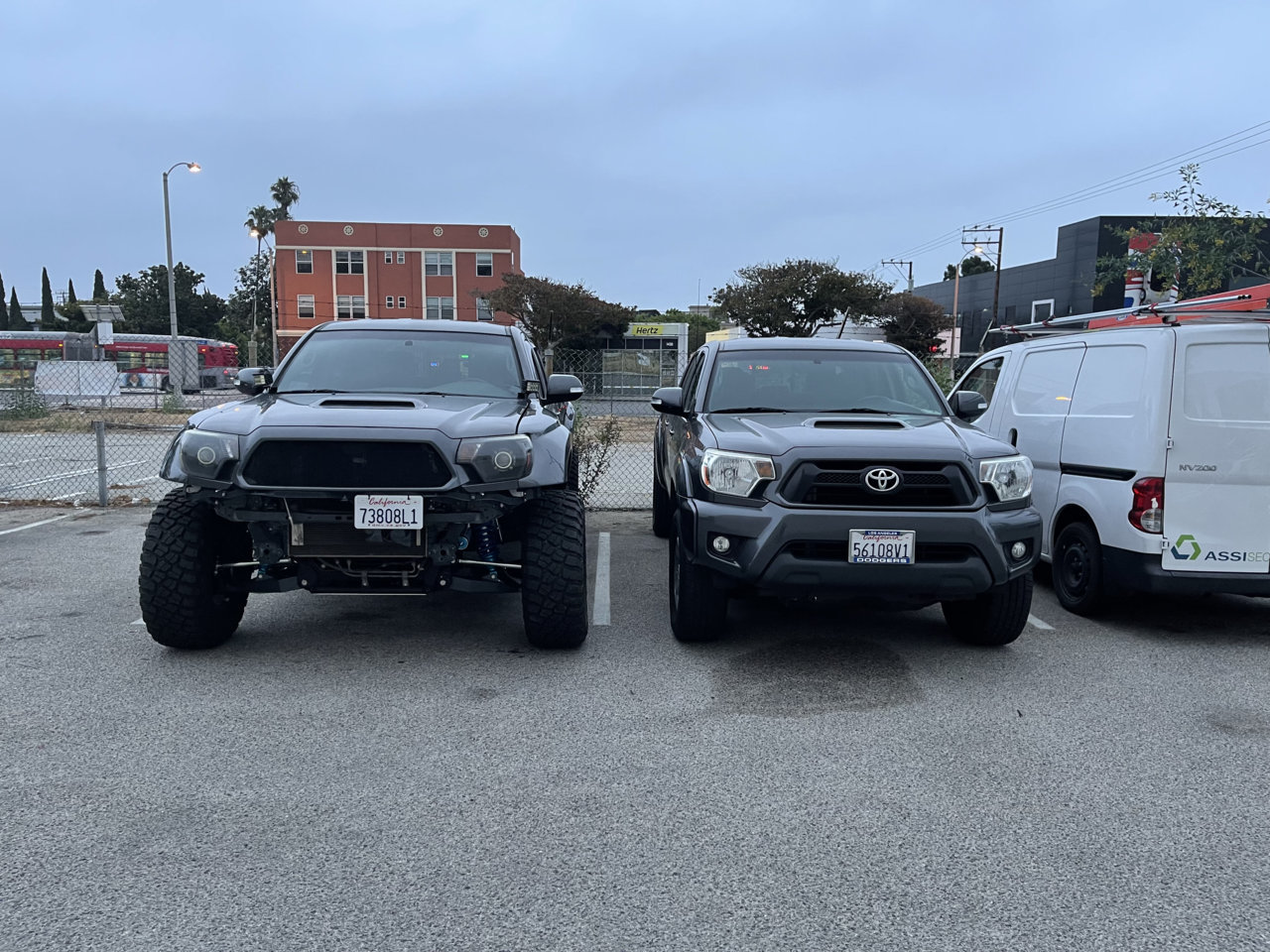

    I had to smog this thing yesterday. Drove down to JD fab to pick some stuff up and to help clear the emission monitors since this thing has had its battery disconnected for so long. I drove it again to work this morning. AAE26D3B-4E11-4AB3-A791-1C713654A29C.jpg Parked it next to my coworkers truck.

    Yours on the right?

    Left.
