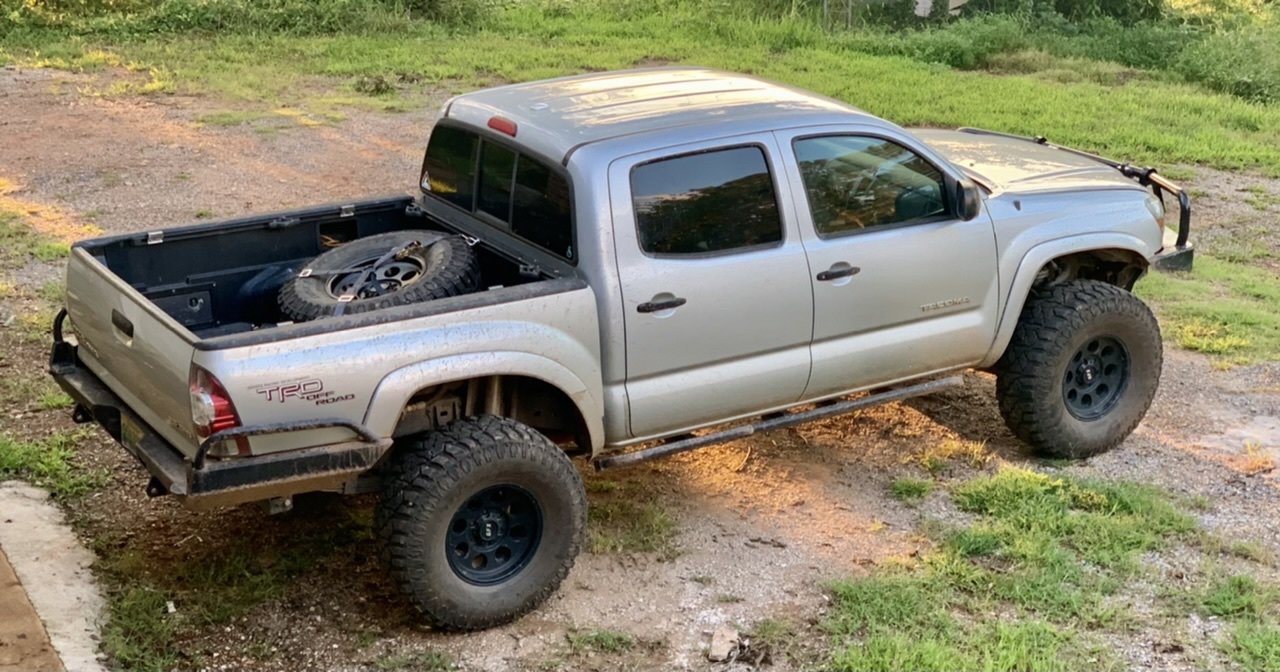

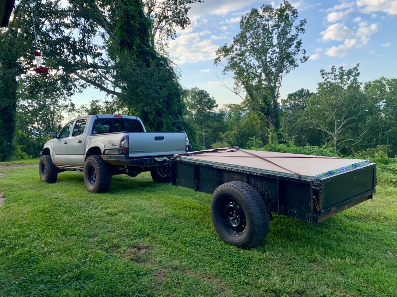

    Dayman Karate
    Dayman Karate Well-Known Member
    Dec 18, 2017
    #238838
    4,722
    Clay
    Central Alabama
    JKU Rubicon
    https://www.tacomaworld.com/threads/daymans-karate-class-but-you-wont-learn-nothin-4-link-lt-and-previous-iterations.755134/
    New from JD Fab- the long travel drywaller hauler. Get your shit and long travel your ass back home in style.
    *Now available at participating Walmart stores
    67A10414-ADE8-4185-B255-61F532A34538.jpg 3C24282E-E7A2-4D28-8E8B-49DD02994746.jpg
