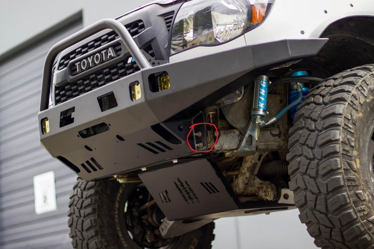

    Yes
    Coastal actually does, they call it their " extreme clearance " bumper and they have skids for it too.

    Yeah that skid looks a little too steep for my taste. I’ll sacrifice a little clearance there for more slope. Would be like hitting a brick wall if you had any momentum.

    Yeah that thing is absolutely hideous.... Had to look and almost barfed

    Yeah that skid ain’t purdy. I like how tucked away the bumper is though. The Bubba Gump chin I have to look at everyday is wearing on my aesthetic.

    I can just picture eating the steering wheel. That angle is absolutely brutal and I'm not sure how they even call it a skid lol

    Definitely gonna poop yourself if you hit anything at speed with that one haha

    that Coastal bumper is a bit

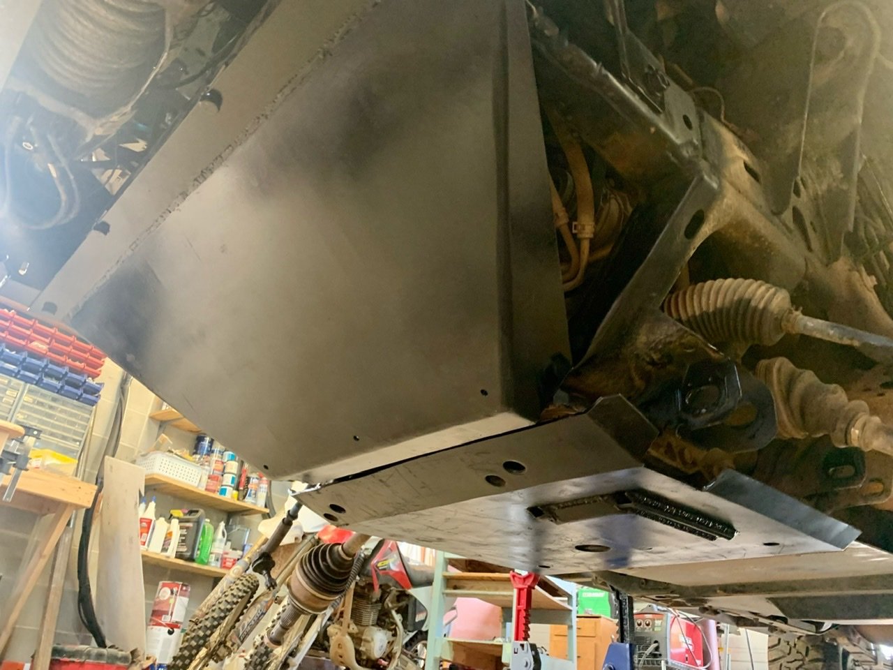

    I have made something similar already so I might not have to do much to make it fit. My skid terminates right in front of the bolts like the one you posted. Instead of tube I tapered the edge of the skid and used some little c channel in the middle. tube would have been better at strengthening the frame horns though.

    I think that skid is extra ugly because it a, starts further back towards the rear of the vehicle instead of right at the (new) crossmember, and b, drops WELL below the LCA pivots. Both of those facts make it very strange looking
