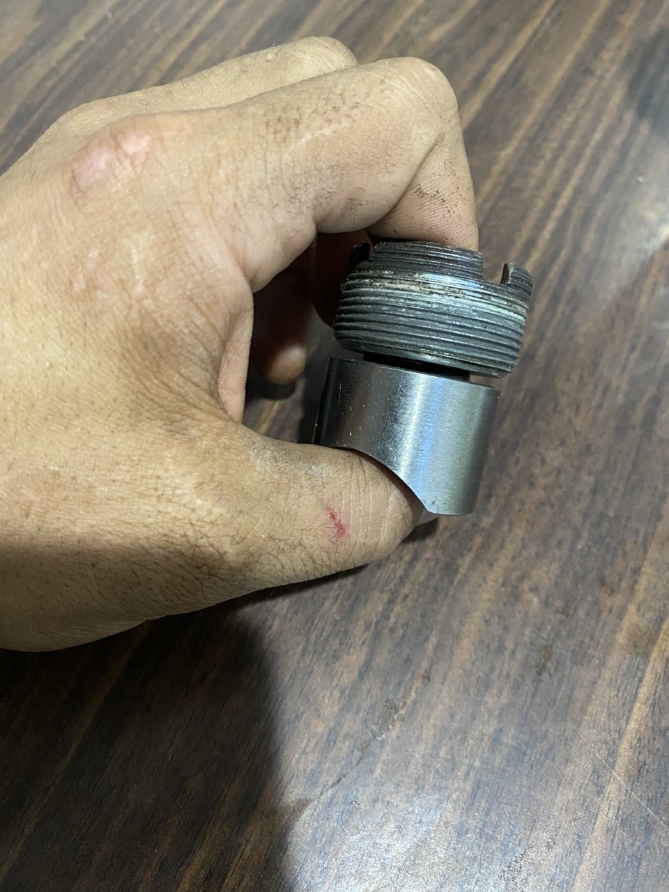

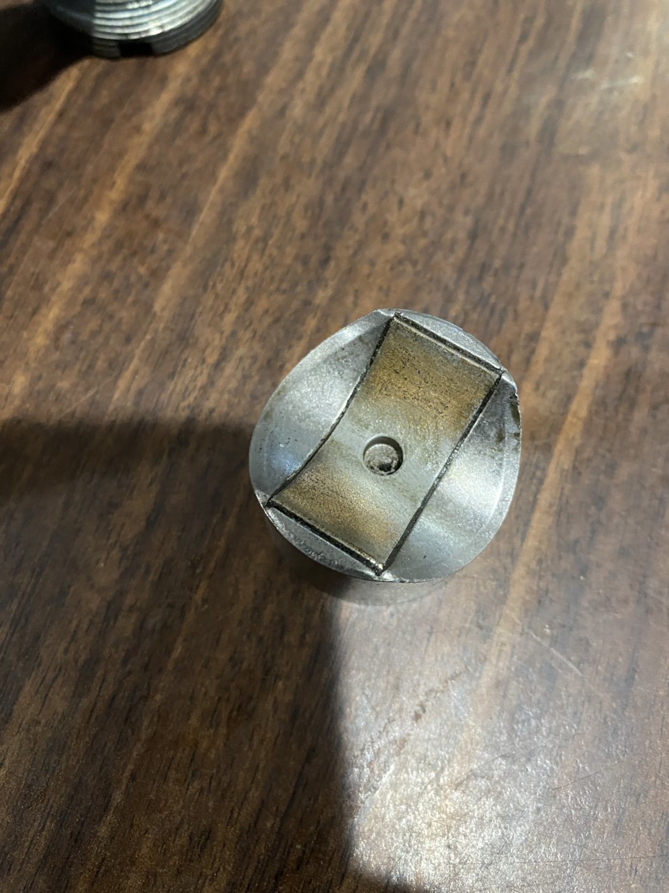

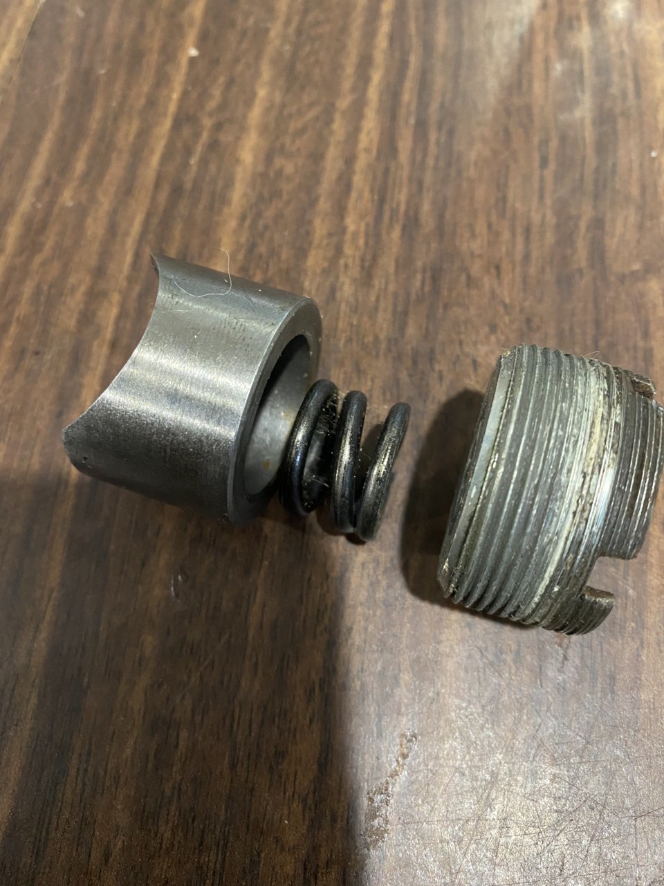

    Alright, so I did figure out my steering play issue this weekend. It took adjusting the preload on the slider/guide on the factory rack. For grins, I disassembled one of my old racks to check things out. Here are some pictures below.
    You will notice the stock guide uses a thin strip of what looks to be bronze. I am assuming, dirt entering the rack wears it down and creates play. It’s really the only thing that makes sense to me.
    So, I talked to my CNC buddy and over the winter he is going to take some oil impregnated bronze round bar and make me a new guide. We are also going to make it 100% greasable and likely remove the spring. In reality, their shouldn’t be the deflection to justify the spring being in there at this point.
    The goal is to still boot the rack. But I feel as though this is also going to be a worth while upgrade as well.
    I would love to hear some opinions on this!

    If you're getting dirt into that part of the rack you're also getting it into the gears on the other side, which I'd worry about more.
