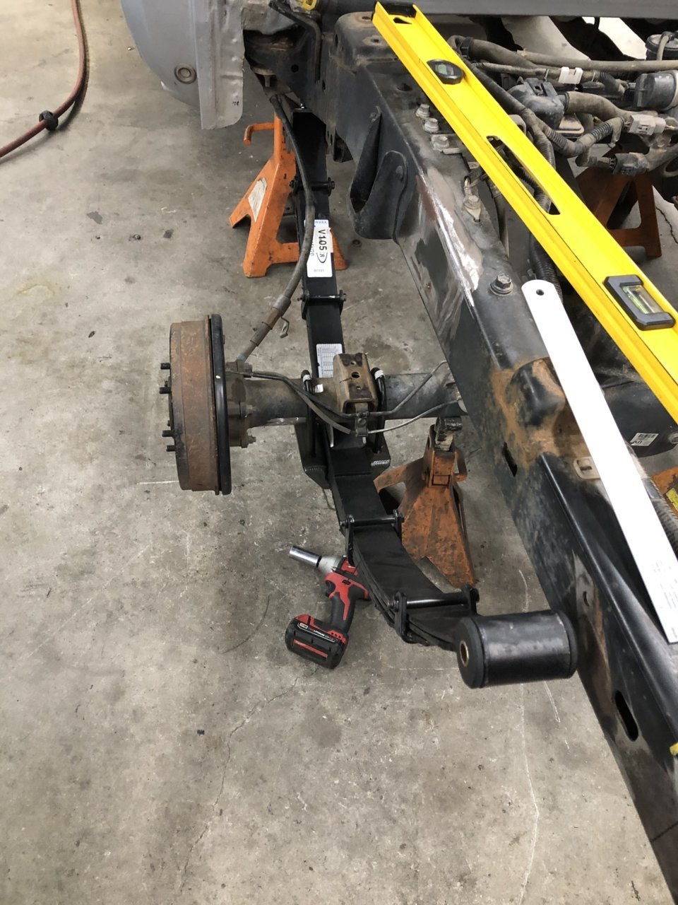

    Maybe a tad late, but I believe the spring perches should also be located slightly more outboard due to the springs being more offset from the frame. May experience accelerated bushing wear if not. Unless that double spherical bearing can account for the misalignment. Just my perspective, but someone else can verify.

    Really, you should be able to mount the front and rear hangers and the spring falls where it falls and you center the axle off of that. Correct?

    Correct. All said and done, they are going to be slightly more positive offset from the original location.

    This is correct

    @81Trekker whats the torque spec on the leaf bolts? 100ft/lbs?

    There is a literal chart on the leaf spring in your picture. Just saying lol. Is it covered?

    The 9/16-18 grade 8 bolts through the eyelets on the leaf is what I'm talking about. Charts online say grade 8 9/16-18 fine are a torque spec of 129. Just want to confirm.

    Oh, your picture and saying leaf bolts threw me off. You should be fine with that torque.
