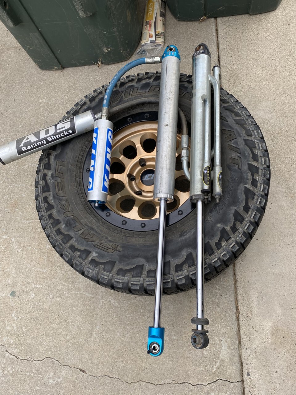

    You wanna buy my ADS 2.5x14 triples (I'm stepping down to 2.5x12 with since I have archive towers)? Couple years old with a welded rod end and king style #2 for the tubes. They'd be perfect for the JD kit.
    Pictured next to some king 2.5x14s.
