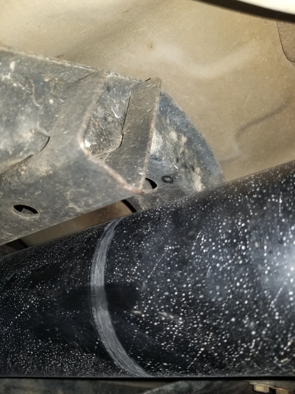

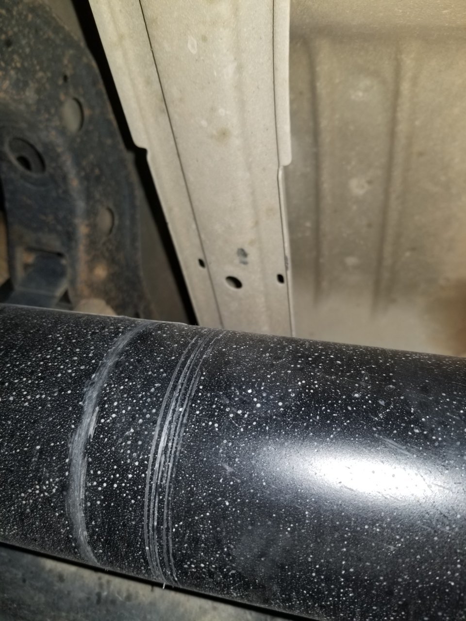

    Are you talking about this member here for the carrier bearing?

    Yeah both the carrier bearing and cab crossmember rub with my dakars at stock height/Tom Woods dline. I cut the carrier bearing one out, and just hammered the cab crossmember up a bit

    That's wild. Mine doesn't rub at all right now with SOA. I wonder what the difference is? I know its damn close, but in the year I've had it on the truck it hasn't ever touched.

    I mean, maybe not. But I find my bump stops often enough I would think an issue would have shown up. Or maybe its just the garbage Dakars that are causing it.

    Im not running an overload in my garbage dakars so the rear axle wraps like a mofo under load

    And there is the answer. They probably also go negative super easy.

    Yeah they sit flat at ride height. About to either swap some 63s in and french the hangers, or do some f150 leafs sua. Cant decide
